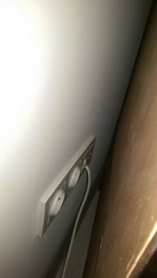

    Hello, I moved into an apartment with UPC internet connection. I would like to connect a free TV from them, because it is possible. The condition of the cables in the box is as shown in the photo. The Internet signal reaches only one room and the input in the wall only allows you to connect the Internet - the TV input is as if masked. I'm green when it comes to this stuff. What should be done at the level of the box and in the socket in the room to receive free TV? Connecting Free TV with UPC Internet in Apartment: Cable and Socket Configuration

  • #6 18976649
    jan_kon
    Level 4  
    Posts: 14
    I still need to find out from the UPC whether I have free TV and even if not, I should have a signal from the antenna.
    The first photo shows a socket from the living room. It has an input for TV and Internet plus a protruding cable. There is no signal at all or it is minimal in this socket. Do you know why?
    The second photo shows the socket from the bedroom. Here is the entrance to the Internet. There is a signal. The TV input is masked.
    How should I connect to receive TV? Connecting Free TV with UPC Internet in Apartment: Cable and Socket Configuration Connecting Free TV with UPC Internet in Apartment: Cable and Socket Configuration
    I will add that both sockets are in the same wall at the same height on both sides.

  • #8 18977508
    KOCUREK1970
    Posts: 35667
    Help: 3860
    Rate: 5488
    @jan_kon
    mieszaczwcz wrote:
    Provided that the building has a so-called collective antenna (usually the administration charges a fee for it and its maintenance, which you should pay as part of the rent)
    The problem is that, as I know developers, you only have one coaxial cable in the rooms and the same in the box - so if they connected the Internet there, there is no chance of connecting a collective antenna (only one cable from the outside enters the apartment, and it is not allowed under no circumstances mix DOCSIS signals with any other signal).

  • #10 18978345

    jan_kon
    Level 4  
    Posts: 14
    _cheetah_ wrote:
    The building doesn't look old, so AIZ should be. And this would have to be checked with the administration.
    There are clearly two cables going to the apartment, one of which definitely has Internet from UPC, and the other is probably empty or may be AIZ. The second one may be the cable from AIZ, or some old story, if there was another cable TV in the apartment before, or just AIZ.
    Let's clarify:
    1. Do you now have the modem connected to the socket in the bedroom that has a blank TV output?
    2. in the second socket (the one with an additional cable coming out of it) you have nothing - neither TV nor Internet. Have you checked the TV output, Data and this additional cable? Because the socket is probably disconnected, and only the cable coming from the socket is connected to the cable in the wall. Have you checked the signal on this cable?
    AIZ should be a DVB-T signal (terrestrial television).
    Ad1. Yes, a modem in the bedroom to be exact. Can I receive TV here if there was no cover?
    Ad2. There is neither TV nor Internet in the second nest. The signal in the additional cable is very weak. It searches for a few channels but they don't receive them. Can anything be done about it?
  • #12 18978397
    KOCUREK1970
    Posts: 35667
    Help: 3860
    Rate: 5488
    jan_kon wrote:
    And if I want to use the TV from UPC, is it possible with the current configuration in the box?
    You find a cable for a given room in the box, connect it to the splitter in the box, to 1 of the 2 ports in the splitter terminated with a resistor (you have to unscrew it), and that's it.
    jan_kon wrote:
    And what about this masked TV input?
    Nothing, there may be no socket there - without a suitable socket or an additional splitter behind this "socket" you will not be able to connect the TV.
    Remove the cover from the socket and let's see what's inside the wall.
