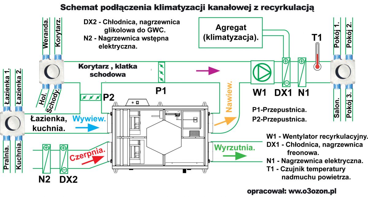

    Dear friends, I'm "hot" for recuperation with cooling function.
    After going through a few fitters, a few designers and a few companies selling reku, I noticed a gigantic crossover of opinions on this subject.
    The usable area of the house is about 130 m2, the total area is about 160 m2, it is a two-story middle segment.
    The plan was to install a recuperator with a cooling function. It's not about making the house cool, but about some control over the temperature on hot days so that the house does not gain much temperature and feel a pleasant coolness inside.
    And so ... we settled on the LMF Klima recuperator - HRH 5 version with a freon module for additional heating or cooling. And the steps began...
    One says that such an installation will reduce the temperature in the house by maybe 5 ºC, another says that it can reduce the temperature, but then we have to install an installation with 2x higher flows to better receive heat (but then the concept of a heat exchanger in a recuperator or recovery loses its value because the exchanger cools down too quickly or heats up from the outside air).
    Another theory is to install a recuperator with a standard flow but have a larger thrust than in an ordinary recuperator and then put larger diffusers to reduce any noise associated with increasing the thrust in the recuperator on the pipes and then leave the standard piping. Of course, everything on spiro insulated pipes (or at least the air intake to the house).
    I know only 2 companies (COMPANIES) that have this device and they all praise that it works for them and fits and works well, but the recuperator works all the time at high draft (if not maximum), although one of the companies explains this by the fact that they just have it on the workshop part and want to get rid of dust.

    Most installers say "sir, this will give you maybe 5 degrees C difference in temperature in the house and it will heat up through the windows more than it cools down".

  • #2 19004889
    dufek
    Level 32  
    Posts: 2050
    Help: 175
    Rate: 409
    wic1 wrote:
    I don't want to install it at all
    There is nothing to be surprised about them, the additional profit is practically nonexistent and additional problems may result from it.

    Come on, the efficiency of your ventilation is at the level of an air conditioner of 2.5-3.5 kW and such devices are installed in rooms of 20-40 m2. And for this ventilation would have to work at full capacity.

    Summary of the first stage after the analyzes and asking the fitters.
    The cost of the project from PLN 200 to PLN 500 for a project on peflex panels.
    From 500 to 2500k on spiro, insulated spiro, climavent and soundproofed square ducts.
    Pipe installation.
    OK 10k on peflex.
    About 12-14k per spiro
    OK 16-20k on insulated square and climavents
    The location of air conditioning pipes, freon from 1000-2500 per point.
    uh...
    This comes out to, say, 20k for the channels alone, while I would have 18k with the recuperator ... it does not sound motivating.
    Recuperator 13-15 + cooling module 2.5k is the upper about 18.5k :)
    Assumption probably 1500 to 10000 PLN :/
    For example, it will be PLN 40k in total :p
    Inspections (mandatory) every six months...
    from 200 - to 500 for a regular hand
    from 500 - to 800 for a recuperator with cooling
    I'm wondering myself whether to set up two cheap air conditioners for 10k, buy 4 air purifiers for 3k .... and ignore the topic? :P
    I have no doubt that if I spend these 40k on soundproofed and thermally insulated ducts, it will work because on a good morning the cooling hand has a flow of 500m3/h while the standard handflow proposed by the company is 330m3/h ;P
    But jizas... that price :(

    Hello. I deal with recuperation for 10 years, I'll say this. Recuperation is for air exchange, not for cooling, combining air conditioning with ventilation makes no sense, you won't feel this comfort. the output that I use for the recuperation installation separately, i.e. spiro pipes in the attic, two risers, pe flex pipes under the spout to supply the ground floor. I Split air conditioning in each room in the attic, plus one larger in the living room. I assume in the attic with this solution there is no additional resistance to the installation. Regards

    I have a recuperator with cooling function and...
    Cools...
    This summer it was +30 outside and up, it was very hot at the construction site.
    When the building is heated (walls, floors, etc.), turning on the cooling function gives a poor effect because recuperation takes a long time to reduce the temperature of the cubic capacity despite working at 100%. It takes her a few H.
    But .... if we turn it on in the cooling mode from the morning (to make sure that the house does not heat up), it cools as much as possible. At the time of 30+, it was about 24 degrees outside in the house and 20 degrees was felt because in this mode, the recuperation oscillated between 50 and 100% of the draft power, hence the airflow itself cooled down and caused a feeling of coolness. I used it to cool August and September, and now it heats the house. I have 21 degrees on the stove and on the recuperator. When the temperature drops below 21 degrees (I have problems with floor heating), the recuperator blows warm air. At -6 it was blowing 27 degrees. Can be? Can be...
    Electricity consumption between August and December was about PLN 900. hand held in auto (temperature maintenance) mode non-stop. Only heating shares with a gas furnace and I note here that I did not test heating with 100% recuperation. When I have a photovoltaic, I'll be happy to check it out and try on it.

    I saw a similar system at one of the clients (i.e. recuperator with air conditioning) and after a year of use I ended up replacing it with a smaller one + adding splits. The air conditioning in the recuperator gave something only when it went to the max, but then the cooling recovery was really poor, again when it was running at low speed, it recovered something, but the cooling had a ridiculous efficiency. In addition, the electricity consumption was higher than today with several splits in several rooms.
    A possible compromise would be a bypass where the ducted air conditioning would operate in a closed circuit inside the house and I have also seen such installations (but in industrial facilities), but there the supply and exhaust ducts were calculated for around 10,000 m3/h and more.

    Hello everyone.
    I'd like to refresh the topic a bit, because as far as I can see, I have a recuperation system in the configuration mentioned here.
    The whole thing is about 80 percent complete, but it's already working.
    The system is installed in an uninsulated non-utility attic, i.e. a cold zone, which is quite a problem that I think I have successfully solved.
    Behind the air intake, which is on the north-west side and enters the building, is a glycol chiller connected to two loops of PE40 pipe, each 180m long. The loops are buried in the ground at a depth of about 2.3m, about 2.5m apart.
    This pipe (spiro 200) then enters the recuperator. From the recuperator it goes to the recirculation fan and onto the freon heater/cooler. From here, it is already a straight path via distribution and plenum boxes to the individual rooms.
    The exhaust of used air is carried out in two ways, depending on how the entire system works. In the first case, all the used air moves into the recuperator and is ejected outside. This is the standard operation of recuperation. In the second case, when heating or cooling is switched on, some of the air from the less 'dirty' rooms, such as dressing rooms and passageways, is returned to the fresh air supply before the freon exchanger and recirculation fan and is further reheated or cooled. The reason for this procedure is quite simple. In a cooling situation, it is much more efficient to cool the air at domestic temperature than from outside the building where it is hot. The analogy is the same in a reheating situation. It is easier to reheat air at 19 degrees instead of cold air from outside.
    I am sending some diagrams. If anyone is still interested in the topic, please write. I have some interesting insights to share myself. I also have quite extensive photo documentation. Unfortunately, prior to the actual build, I have not found enough information (I mean people who own something like this and can realistically tell you about its pros and cons) on the subject, so in a way I have to cut corners. That being said, I am happy to answer questions. I have a few myself, maybe someone can help me or suggest something.
    Greetings
    Diagram of a ducted air conditioning system connected with recuperation. .
    • REKUPERACJA (2).pdf (13.36 MB) You must be logged in to download this attachment.
