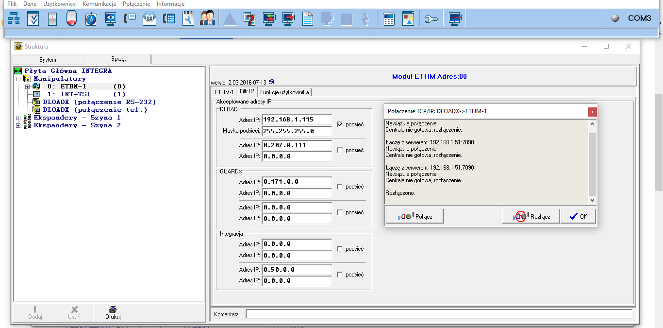

    I changed the cable connecting the integration with ethm-1 and still nothing.
    I added the IP of the computer that connects to the exchange, and now it pops up that the exchange is not ready.
    Maybe someone can help.

    Communication problem fixed (after replacing the cable connecting the integrated board with ETHM1 three times, communication started).
    I think that the fault lies in the RJ11 plate (as colleagues wrote on the electrode) - I turned the cable to the other side and it's ok.

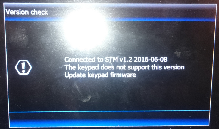

    I updated the INT-TSI keypad (via TSI BUILDER)
    - INT-TSI OS update
    - INT-TSI STM update
    I started everything normally, but after half an hour the manipulator spilled out.
    A message pops up:
    Connected to STM v1.2 2016-06-08
    The keypad does not support this version
    Update keypad firmware
    Re-updating the STM fixes the problem, but after using it for a while, the same problem again.

    After the TSI update, was the project in TSI Builder rebuilt and uploaded to the TSI? If not, this is the answer.

    NO ;-)
    Thank you for the hint.
    I will test tomorrow.

    Yes, reworked. I got the same message. After construction everything is fine. The latest version is v1.7.0.0.

    After building from scratch in tsi and uploading to the card, everything works beautifully.
    Thank you for your help.

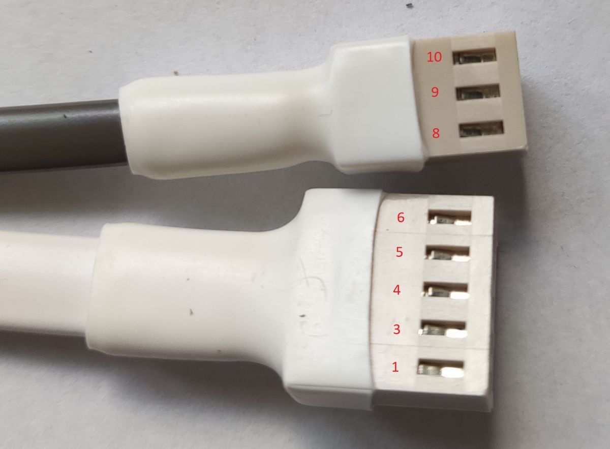

    If I understand correctly, you are making a classic mistake. The cable connecting the ethm-1 with the integrated (pin5 rj) is a completely different cable than the one that used to be included in the DB9F/RJ-KPL set.
    The cable that is used to flash the module should be white and in the old version it had a green ribbon. The cable for connecting the RS ports of the control panel and the module is a cable with a red ribbon at the factory.
    The difference lies in the different connection of the wires in these cables.

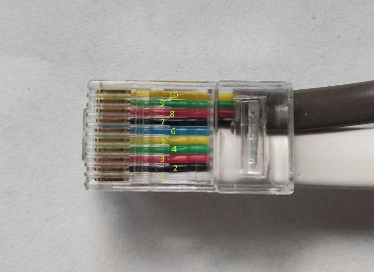

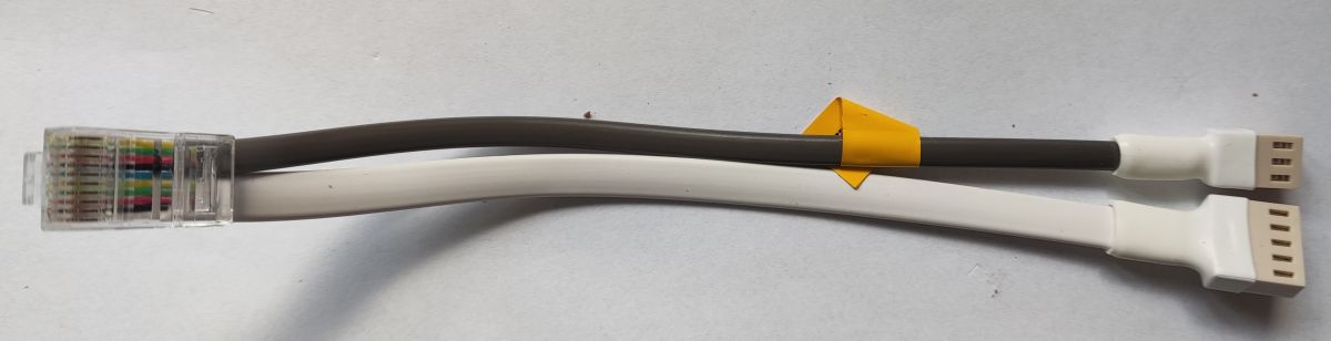

    For me it looks like in the pictures, both black wires are not connected.
