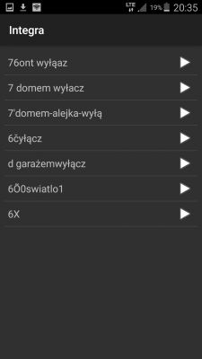

    The problem is that when defining macro commands in the tab Definitions their names after going to the tab groups without composition and order, they change and look like in photo No. 1
    Post-Firmware Update Issues on ETHM-1 & Integra128: Adding Macro Commands via DloadX
    however, after uploading the file to the apk, some bushes also appear on the phone:
    The commands themselves are executed correctly, only these names - I tried different ways but always come out "bushes".
    As I mentioned in the first post, everything is updated to the latest versions. As long as I didn't move anything it was fine. Only when I wanted to add a new command to control the lighting everything went wrong.
    In the first post I wrote about the buttons, because it seems to me that they used to be (and it occurred to me that due to the lack of writing to the ethm, this happens), but maybe they actually appeared only in the ETHM-1 PLUS

    Hello, Satel's help could not help, she only suggested replacing it with ETHM-1 PLUS. So I did. The problem is solved.
