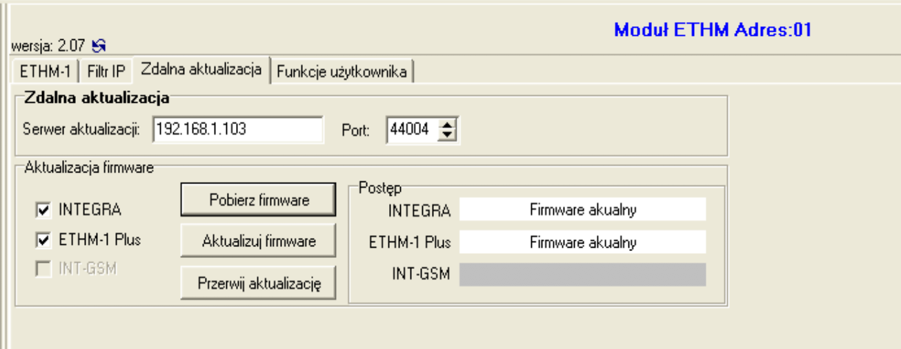

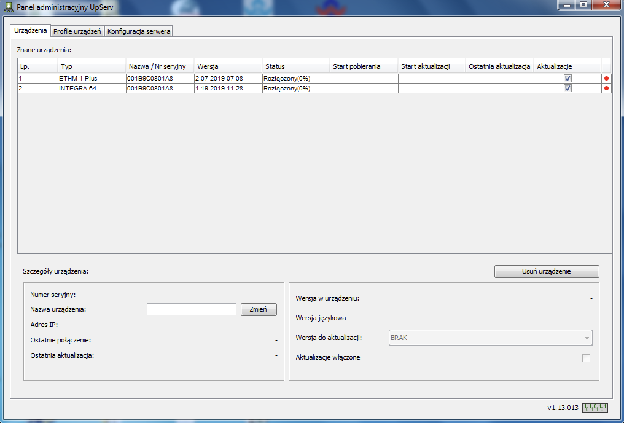

    For me it looks like this, server on Win 10

    Java update.

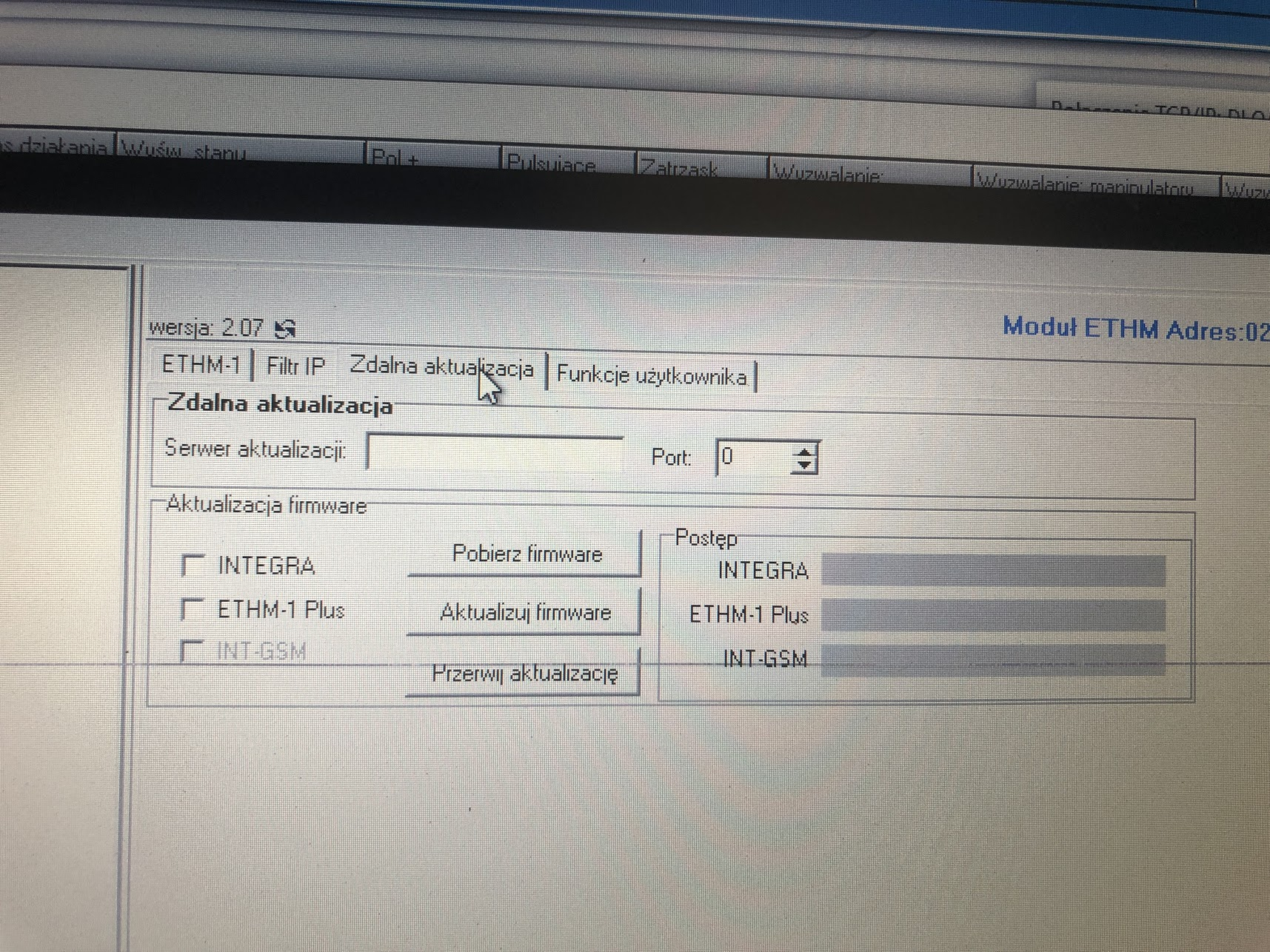

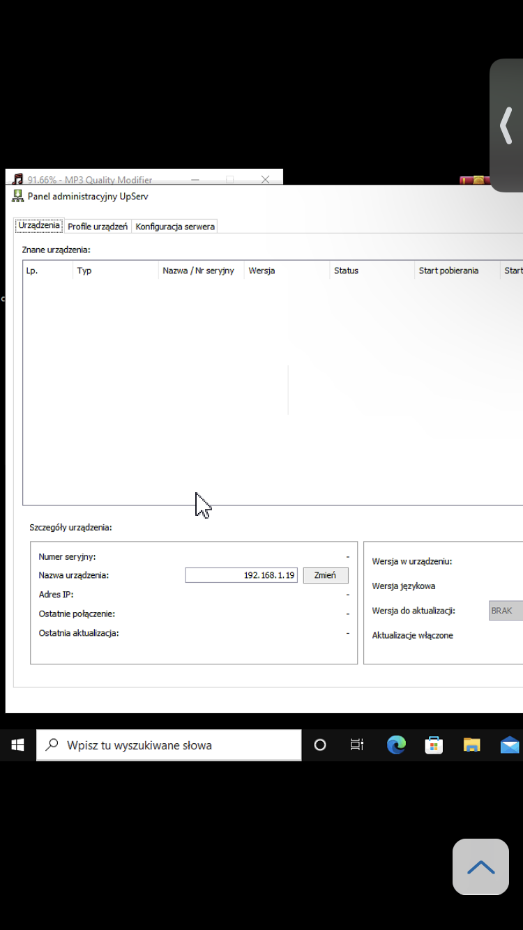

    I will join the topic.
    I started the upserv on Win 10, fixed IP, Windows firewall turned off.
    My maybe stupid question is what to do to make the upserv detect the PBX? Which is located in the same local network.
    INTEGRA32 control panel additionally Ethm1 Plus.
    The satellite server is running, the Integra CONTROL application is running.

    The control panel must connect to the upserv. In DloadX -> Structure -> Hardware -> ETHM-1 remote update tab, enter the IP and port of the update server (upserv), select what to update, and download the firmware. Then it will be visible on the upserv side. Then on the upserv side, when you select the connection line, you can choose which firmware version to make available. A completely unintuitive solution

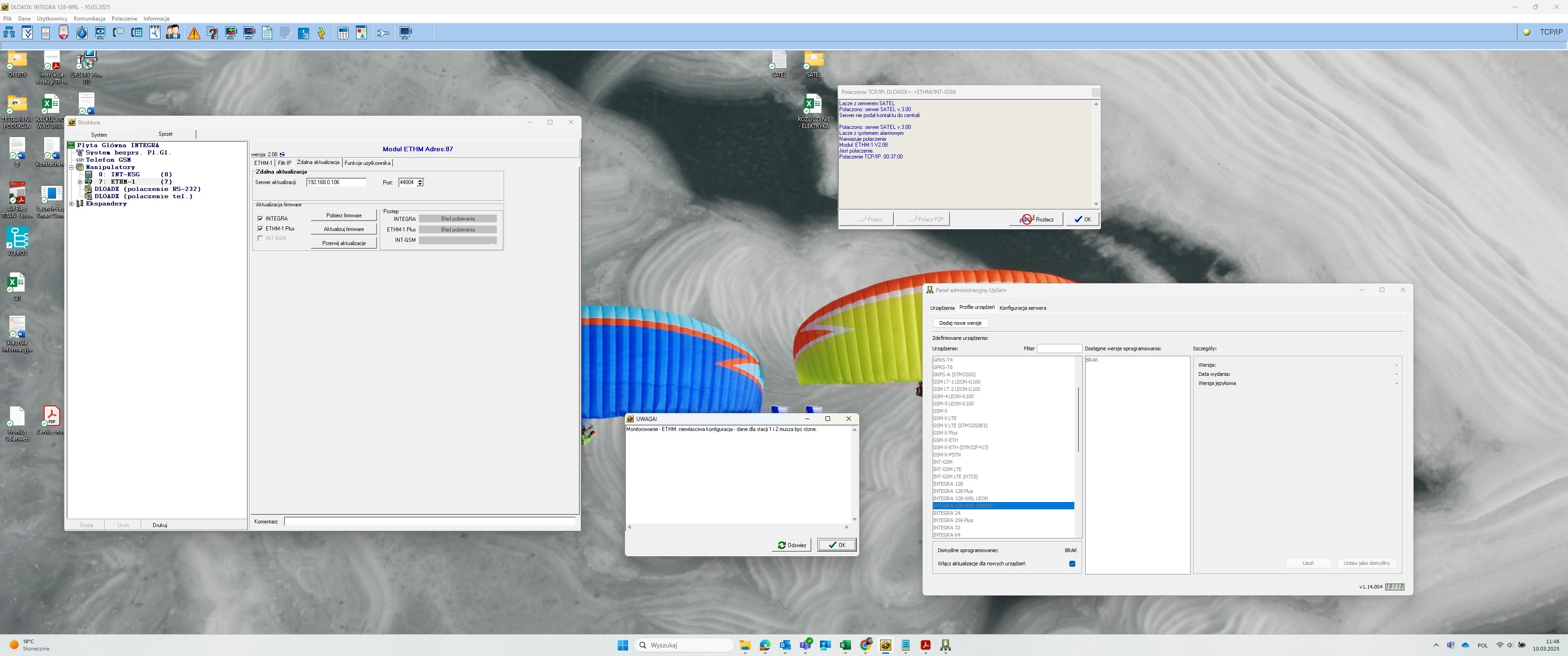

    I have taken to remotely updating the Integra and the ETHM-1 but, despite what I think are the correct settings, I get a download error. There is something wrong because in the DLOADX program the orange triangle lights up (monitoring - ETHM: wrong configuration - data for station 1 and 2 must be different) - but what this is about I don't know? The UpServ administration panel is also silent.
    Any hints as to what could be wrong?
