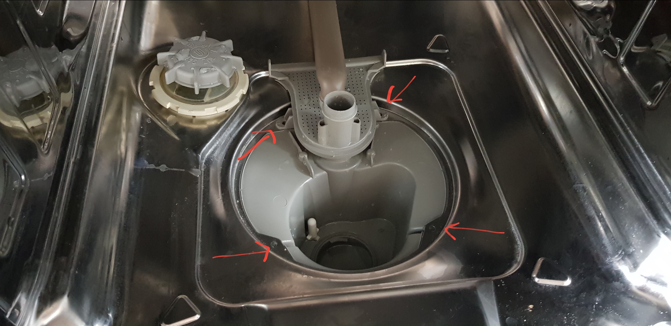

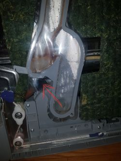

    The same problem. Water was pooling on the tray and the dishwasher was starting to hum.
    Error E01. The cause was a clogged tube. I attach photos.
