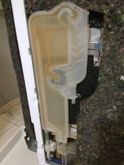

    I do not know exactly how the water extraction process should take place, but in my case, in the left part of the labyrinth, the water "turns", and in the right part, on the sloping "plates", only a small stream of water flows (it flows into the dishwasher chamber)

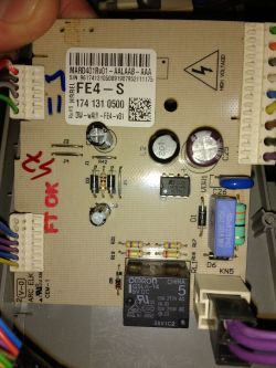

    I also found information that this could be a problem damaged triac on the module . I have not found any damaged elements, but maybe someone will see something that I did not pay attention to ?:
    Continuous Water Drainage Issue with BEKO / DIN1530N Dishwasher Post Reset Attempt

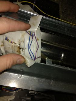

    The reason for the described defect was a broken wire leading to the water intake meter. The damage occurred on the "strip" of wires between the door and the bottom of the dishwasher:
    After soldering the damaged wire, the problems disappeared.
    Thus, the water pressure I mentioned at the entrance to the dishwasher was sufficient.
