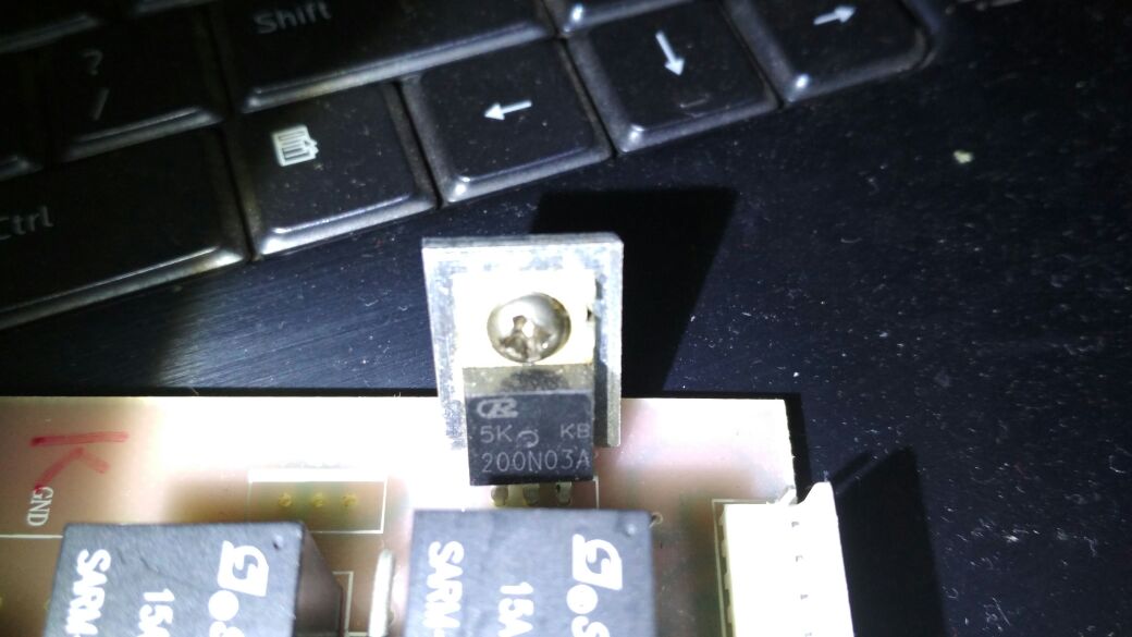

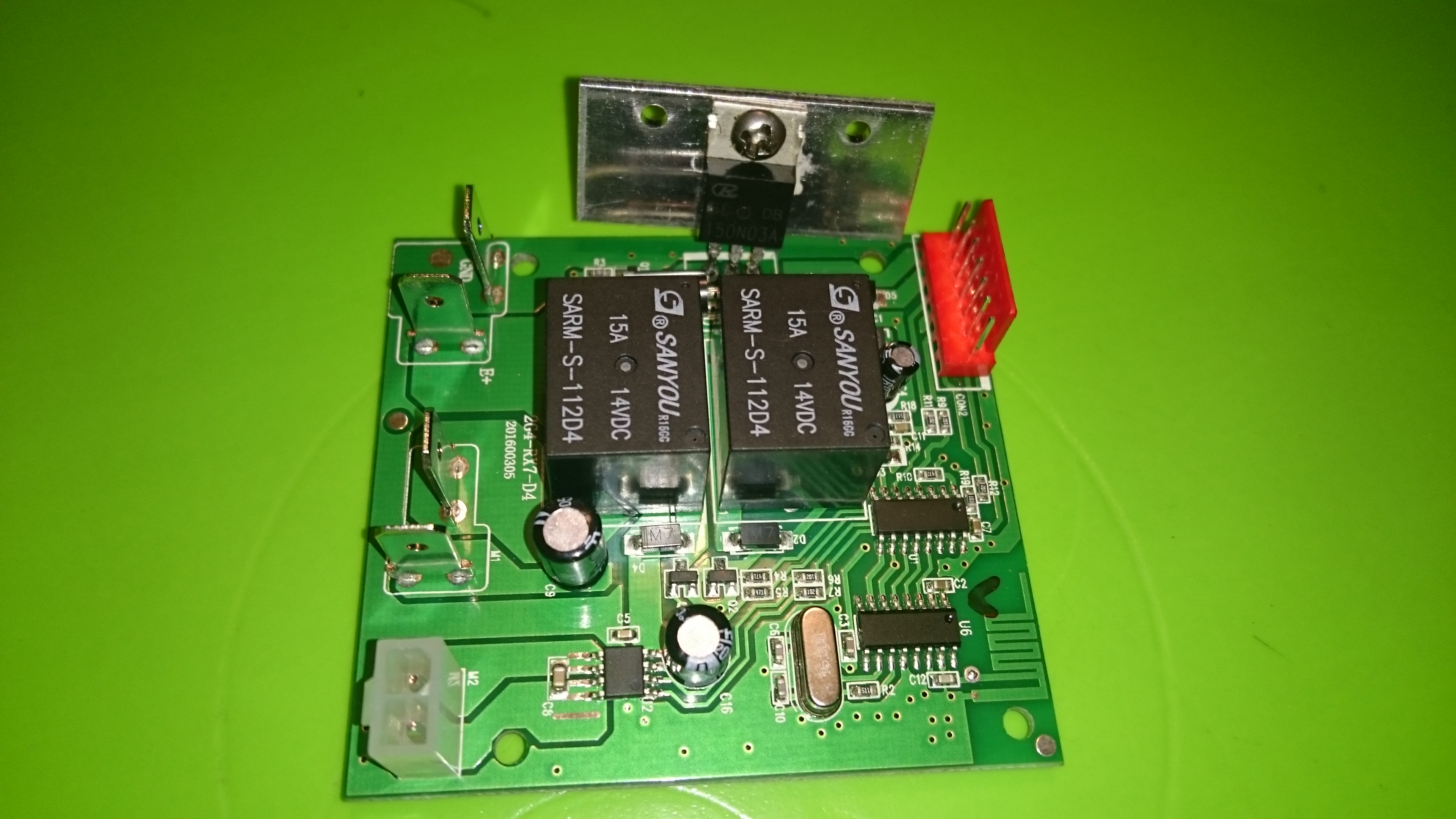

    I need a MOSFET 150N03A replacement
    The transistor is mounted in the remote control module of the car on the battery, the module is the company "WELLYE"
    The entire module has dimensions 7x6cm
    1x1,5 cm transistor
    • MOSFET 150N03A Replacement for WELLYE Remote Control Car Module - Transistor 1x1.5cm DSC_0614.JPG (3.02 MB) You must be logged in to download this attachment.
    • MOSFET 150N03A Replacement for WELLYE Remote Control Car Module - Transistor 1x1.5cm DSC_0615.JPG (3.01 MB) You must be logged in to download this attachment.
    • MOSFET 150N03A Replacement for WELLYE Remote Control Car Module - Transistor 1x1.5cm 20160818_130232.jpg (1.97 MB) You must be logged in to download this attachment.

    IRF3305PBF - is available for purchase from TME

    Replaced by Piotr for now works well for a week, I also put in a better, bigger cooling from an old computer power supply, thanks to which the mosfet does not heat up as much as I went through the check, the original lasted 2 weeks, but as you can see the photos had very poor cooling, so you can easily use this replacement.
    The replacement works very well.

    Are you looking for a replacement for 200N03A. Very rare, you can not find a datasheet.
    Used in car modules for children, the "Weelye" brand.
    Will IRF3305 work as a replacement for 200N03A?
    Help me find a replacement or equivalent part number.

    Unfortunately, UTT200N03 is available only in wholesale from China, you can not find it anywhere else.
    I replaced IRFz44N, but the Soft-Start function has disappeared and the circuit does not respond to speed control. The engines always have full power.
    When 200N03A was put down, it worked properly. I do not know why spare part numbers do not respond to gate pulses (PWM / analog).
    Could you tell me which company is producing these mosfets with the "CR" logo on the component? I asked many sellers, but nobody knows. They only know that it's done in China.

    For me this replacement IRF3305PBF works until now, I note that I gave it better cooling and it works until today

    As far as the Soft-start function is concerned, it works properly, there are no jerks, the car moves smoothly, the only minus is that in the first and second gear if there is a greater load, the car moves under the hill, it throws gears and blocks the car for 5 seconds from the third gear he goes without problems. But the smooth start function works in every gear
