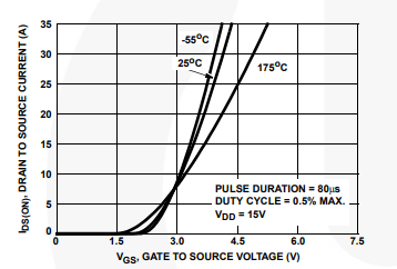

    This interests you more than Vgs(th):
    Graph showing the current-voltage relationship for various temperatures.
    At about 3V you should have about 7A current enough.
    These transistors are probably already discontinued from the range, so keep this in mind when choosing them.
    See also this one: https://eu.mouser.com/datasheet/2/308/1/NVD6495NL_D-2319287.pdf
    Provides the needed current below 3V.

    Thank you for drawing attention to an important parameter. All clear now. Regards.
