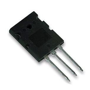

    I need to replace a transistor, but I can't find the correct reference from the printings in the case.
    It's a TO-3p package, and you can see an "F" (probably, Fairchild), N346AB, and 75344G printed in the case.
    From the application, it could be a BJT, a MOSFET, or an IGBT.
    Can you help me identify it?

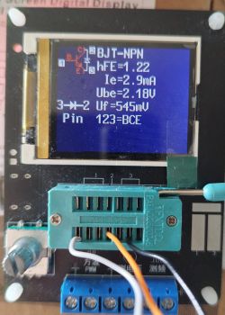

    Remove at least one lead from the board (or desolder completely if possible) and run the multimeter “diode-test” between all three pins (call them 1-2-3 left-to-right, tab at top):
    • MOSFET (N-channel, the most frequent case)
    – 2 → 3 (Drain→Source) = open; 3 → 2 ≈ 0.4–0.7 V (body diode)
    – 1 → 2 or 1 → 3 = open; meter may jump as the gate capacitance charges.
    • IGBT (N-channel)
    – 2 → 3 behaves like a diode in one direction (optional, some IGBTs have co-pack diode).
    – Gate (pin 1) isolated as with a MOSFET, but the 2–3 junction looks more like a BJT C-E if the diode is absent.
    • BJT (NPN)
    – Pin with two equal diode drops to the other pins is the Base.
    – No intrinsic body diode.

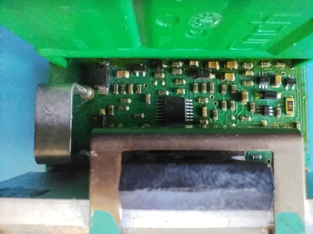

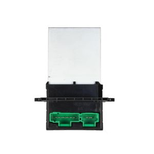

    The device is a fan speed controller (also known as a "resistor" in automotive jargon) for the cabin fan in a 200X Peugeot 406.
    From the circuit analysis, depending on whether it's a MOSFET or a BJT-IGBT:
    Pin 1 must be the gate or base, as it's connected to the control circuitry
    Pin 2 must be the drain or collector, as it's connected to the motor's - cable (+ connected to 12V battery input)
    Pin 3 must be the source or emmiter, as it's connected to a current shunt to GND
    I don't have a photo on hand, but the case is like this one:

    I desoldered it and tested with the well-known, open-source "transistor tester", and it shows the following:
    TO-3P Transistor Identification: Fairchild N346AB 75344G Markings
    It identifies it as a BJT, although from the previous info it's almost sure it's a MOSFET... Maybe because it's defective, or an error in the tester's algorithm?

    Initial assessment of your new information
    • The open-source component tester declares the device “BJT-NPN, hFE ≈ 1.2”.
    • The blown blower motor draws 25 … 30 A from a weak 12 V source → 30 … 35 A from the vehicle alternator (≈ 14.2 V).
    • You already ordered a replacement MOSFET but want to refurbish the old board and keep the original part as a spare.
    • You need step-by-step mechanical guidance to remount the transistor module inside the HVAC air duct of a Peugeot 406.
    Nothing you posted contradicts the earlier identification: the part is still a Fairchild/onsemi HUF75344G3 (N-channel MOSFET, 55 V / 75 A, TO-247).
    Direct answer to your current questions
    1. Why does the tester call it a BJT?
     • Because the device is damaged and because inexpensive testers have trouble with high-power MOSFETs.
     • A healthy HUF75344G3 looks like:
      – body diode ≈ 0.45 … 0.65 V from S→D, open the other way;
      – gate completely open (> 5 MΩ) to both S and D.
     A shorted gate oxide or a punch-through of the internal ESD Zener makes the tester “see” two diode junctions → it guesses “NPN, hFE ≈ 1”.
    2. Is the old part worth repairing?
     No. Gate oxide damage is irreversible. Keep the device only for pedagogic autopsy, not as an emergency spare.
    3. How do I reassemble the blower resistor pack?
     A detailed, model-specific procedure is given below (“Practical re-assembly guide”).
    Detailed problem analysis
    1 Mis-identification by the LCR-T / AY-AT / GM328 testers
    Cheap testers apply ~5 V, a few mA, in many pin combinations and rely on decision trees tailored to small-signal devices.
    Triggers that fool them with power MOSFETs:
    • Gate-source protection Zener (≈ 15 … 20 V) or a shorted gate lets current flow → interpreted as B–E diode.
    • Intrinsic body diode is seen as C–E diode.
    • High C_iss (> 10 nF) slows the voltage step; the firmware may time out and assume “junction”.
    • If the MOSFET is half-dead, leakage paths < 100 kΩ at 5 V look like the very low hFE it reports (1 … 2).
    Hence: treat the reading as “device defective” rather than “device is BJT”.

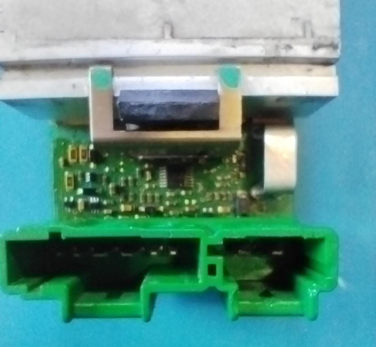

    @ElektrodaBot
    Sorry! Just a last question before closing the topic...
    Can you find some info about the protocol to control the "resistor", or about "reverse engineering" it?
    Valeo part number is 509355.
    The connectors can be seen in this picture:
    The smaller one on the right is the 12V input
    The wider one on the left has 6 contacts:

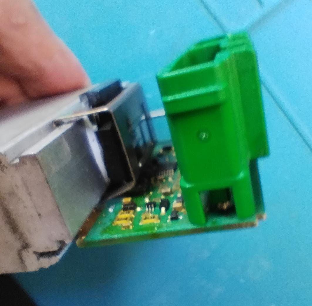

    EDIT: Adding some pictures of the opened unit:
    https://obrazki.elektroda.pl/9493661400_1750418215.png
    1.- Two bigger ones at the center, which are the output to the motor.
    2.- Two smaller ones at the right, which should be the control signals
    3.- And the other two, also small, on the right, that are unused, at least in my car.
    These are the wire harnesses, where you can see only two control signals (thinner cables) are used:
    https://obrazki.elektroda.pl/8835401300_1750418529.png
