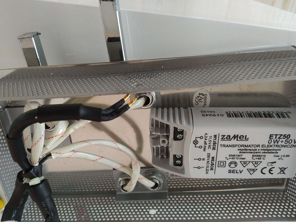

    I'm just ordering. I have AC / DC diodes. I know I can take any power supply. But in general it will be better to take AC or DC? If I took one that gives ~ 12V AC output, you could probably connect the halogen lights if necessary.
    Thought to take:
    3 x http://allegro.pl/transformator-do-led-12v-0-50w-4-3a-24gwar-zamel-i6442767134.html
    for chandeliers with a load from 15 to 30W (Zamel does not produce transformers weaker than 50W)
    2 x http://allegro.pl/transformator-do-led-12v-0-70w-6a-zamel-polski-i6468104064.html
    for chandeliers with a load of ~ 54 W
    I checked the dimensions etc.
    Will there be a guitar?

    And so slower and boring, it does not make any difference for halogens whether the power supplies are AC or DC, it is simply cheaper and easier to make an AC power supply because the rectifier block is missing and that is why these are most often available for sale and installed in lighting fixtures. For LEDs, this is a big difference because they conduct only one way and require a current source, in your case the rectifier block and the current source are already in the holders together with the diodes. So at this stage it does not matter if you choose AC or DC, if it is AC it is important that it works stably at low power consumption (these bezels according to the description meet this condition). Well, unless we take into account the fact that on DC you will be able to later fire everything on AC and also LED holders in the DC only version.

    I am just looking for something that will be more universal and will exclude any possible flickering of the LEDs. These transformers should do the trick, but since the DC power supply would have more uses, maybe it's worth installing one.
    The DC-only diodes are much cheaper than AC / DC, but I already bought them all for AC / DC, so nobody will replace them for the next few years :-)
    Only if it makes sense to support Edison's solutions :P

    So far I wanted to connect everything, but:
    1. The cables in the chandelier are both black, the plus and minus are not marked,
    2. The power supply also does not indicate how to connect them, I also do not know where to put the blue and brown cables from the mains. The power supply is marked with "N" and "L" at the input.
    It is a pity that the producers assume that each person is an electronics engineer and will guess :-D
    Can you tell me how to hook it up so I don't screw up? :-D
    Although it is AC, theoretically it does not matter?

    N - zero, blue
    L - phase, brown
    Unless the electrician was smarter and connected the other way around.
    The output does not make any difference, the current is variable, so there is no plus and minus.

    Replacing one power supply went without a problem, it shines great and the light is constant.

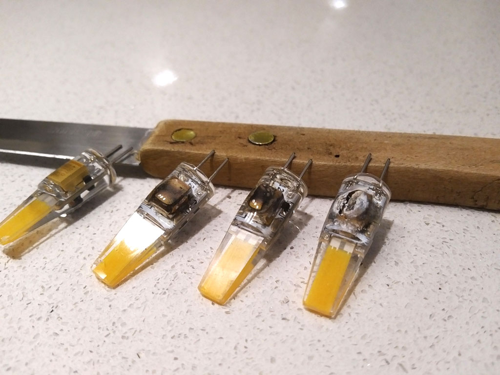

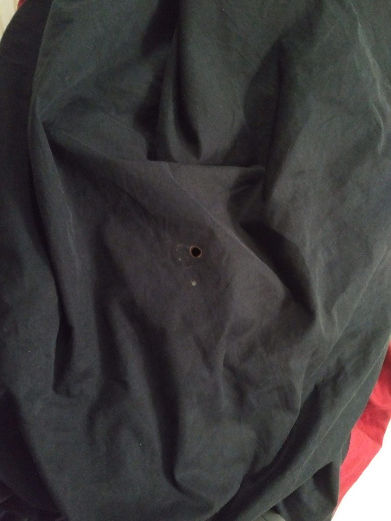

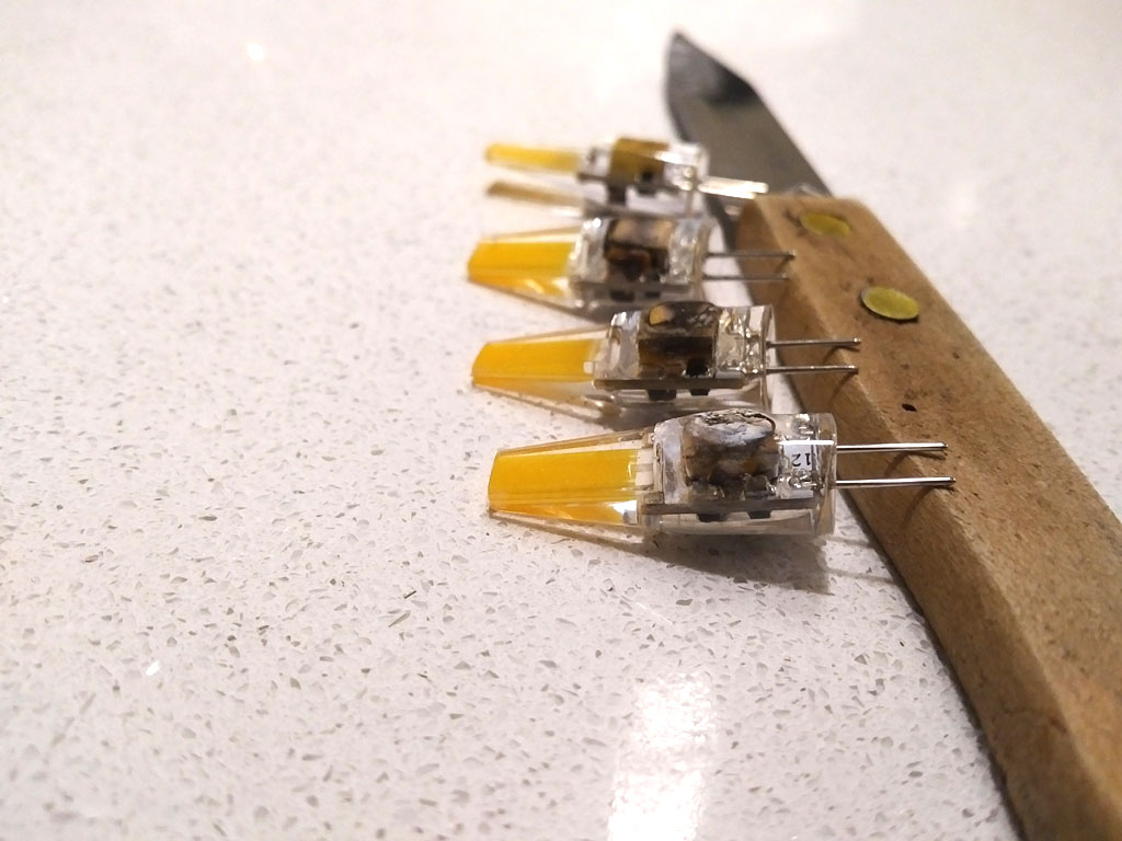

    I replaced the second one and for a moment everything was ok, then one of the LEDs "fired" throwing out a piece of melted plastic that started to burn on the sheets.
    Still, the rest of the lights continued to glow (of course I turned off right away).
    I extinguished the fire, but the sheets should be thrown away. Good thing it didn't hit me.
    It was one of the expensive COB diodes with various "protections", AC / DC of course.
    The same thing happened before with the halogen power supply, so it's not the power supply's fault.
    I will return all these COBs to the seller, because I am afraid to sit under such a chandelier or at some point something will not shoot.
    I warn you: http://allegro.pl/zarowka-led-halogen-3w-35w-g4-12v-ac-dc-nowosc-i6290070901.html
    What could be the cause of this, anyway?

    Savings on parts at the manufacturer, probably some capacitor shot.
    When it comes to led frames, we currently have a light lottery to buy. Sometimes there will be an honest seller, he will write the truth about the product, without promising golden mountains, and sometimes not ... I once talked to a guy about China, he moved and opened a small factory of LED lighting. His father manages an office in Poland and so they have production and import in one. He gives me a catalog and asks just how many and which frames I want, they will write what they want on the packaging and on the "light bulb" itself. Most of the companies for which they produce do not even ask what the components are, but what the price, or can it be done cheaper. He showed me a lamp supplied to two companies, identical components for both, one on a cardboard box told me to write the data from their factory laboratory: 230 lm and 3.5 W, and the other box read 290 lm and 3 W. I do not mention the names of the companies because I do not remember somehow I have a better memory for numbers. When I said what components and properties of the product I would like, how did ufo look at ... LEDs are a brilliant product and with the current technology, a well-designed luminaire should easily survive us, but unfortunately it does not pay off for producers, and the consumer does not want to pay for it. so pay.
    End of my depressing argument, give back what you bought, make a fuss and best request a refund for the linen! Without harassing mindless morons what they only want to earn, they will continue to sell junk gladly.

    As for the part, I guess it's all cheap from China, but I expected better quality for a purchase for PLN 800 in full (if the ceiling had normal GU10 pins, I would have made the whole apartment for PLN 100).
    However, since they sell 3W, it should be OK. Those from other companies don't have any problem. I even have a similar COB, signed by the same manufacturer, but with a different "chip" (rectangular capacitor?) And everything is OK with them. Only the batch from that auction burns out one by one.
    In fact, the temperatures during the burnout were cosmic - if that spit plastic fell on the skin, you'd have to go to the hospital with a burn and having to remove that shit from the skin. As if it fell on the head, it's a massacre at all. Bed linen does not matter to me, the most important thing is that nobody was hurt.
    Were these bulbs not "sealed" in some "gel" (which is highly praised by retailers :P ) it would have nothing to dissolve. This capacitor would burn out and that's it.
    In any case, a good topic as a warning. In the meantime, I will order 2W from someone else, if there are any - but it's hard to find something now.
    Some sell it and 4W and more powerful on the G4 :)
    I have attached photos. Don't buy anything from the company Lumiled !
