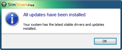

    Thanks for the answers.
    @ Sztandar18
    I clicked on, but I think I've finally installed both drivers. At least I am making the request as the window in the attachment pops up. It didn't help.
    I have an integrated graphics card.
    Write me back what to do next and what do you think about the link sent by @djacek.

  • #32 15906139
    Sztandar18
    Level 26  
    Posts: 852
    Help: 75
    Rate: 104
    Now it's time for the drivers that were sent by @djacek, when he wrote this post, I was looking at them on the AMD website. Go to the link provided by him and download the drivers for Vista 64 bit. If you have any drivers currently installed for graphics, uninstall with the tool that I told you to use earlier.

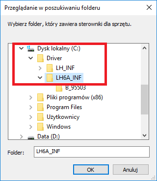

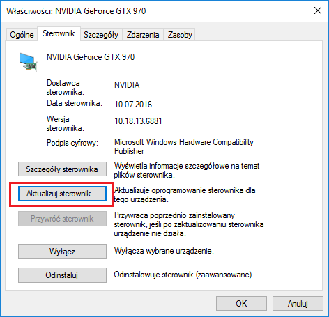

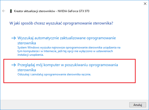

    * In the attachment I am sending the drivers for your graphics card, extract them to the C: \ partition
    * Enter Device Manager, left-click twice on the graphics card that Windows detects for you.
    * Click Update Driver ...
    * Click the second option which is Browse my computer for driver software
    * Select the folder with the driver, it will be this location: C: \ Driver \ LH6A_INF
    * Click next, wait for the installation to complete
    Below screenshots how it should look more or less:
    Windows 10 Screen Resolution Issue: Switch from 1024x768 to 1920x1080 on Same Monitor & Hardware
    • Driver.zip (46.81 MB) You must be logged in to download this attachment.
  • #35 15909264
    M9a
    Posts: 53
    Rate: 27
    Problem solved :D
    @ Sztandar18
    Applying your very good instruction, I was able to finally set a good resolution. Thank you very much.
    I would also like to thank all the other people who contributed to solving my problem.
