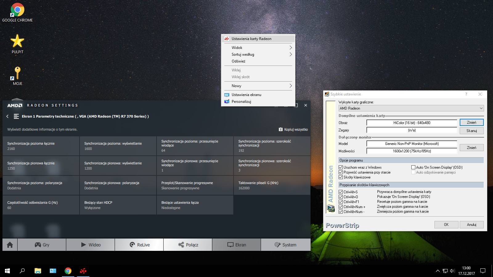

    Hello, I have a 16: 9, 27 "monitor I have tried to set the resolution 1920x1080 more than once, but it fails.
    Yesterday I did something like FORMAT C, the computer is now like new. I installed the latest drivers for the graphics card, in the monitor settings (that's how I set 16: 9), (this monitor has the ability to watch TV) I tried everything. When I want to set the resolution I go to SCREEN SETTINGS and the maximum resolution I can set is 1600x1200 and 1600x900.

    I don't have something like that, but I do have something different, look
    Setting FULLHD 1920x1080 Resolution on LG FLATRON M2762DP with AMD MSI RADEON R7 370

    What cable is the monitor connected to the card?
  • #11 16896450
    Progade
    Posts: 26
    VGA, but the graphics card has a DVI-I adapter (connected to the card).

    Connect the HDMI cable. Full HD video transmission via analog VGA is a kind of masochism. You have HDMI in the monitor, and graphics card in it. There is a good chance that the correct resolution will go through the digital connector.
  • #13 16896517
    Progade
    Posts: 26
    Ok, I'm looking for some HDMI.
    Added after 42 [minutes]:
    What quality !!! Thanks for your help, I'm not very familiar with computer matters, but a lot ahead of me.
    Thanks again.
