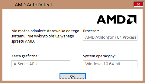

    After starting the program that you advised me to download, the window shown in the attachment appeared to me. What should I do next?

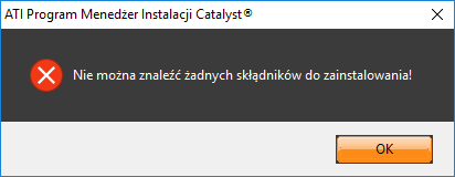

    I did as you advised, but only a custom installation this time. I gave up the express because it doesn't matter which one I choose.
    At the end, the message appeared again:
    Cannot find any drivers to install.
    Again, it didn't do anything.
    Maybe I should have written about it in advance, but a few months ago I did the upgrade from W7 to W10. Resolution also deteriorated as well. So since I couldn't deal with it, I went back to W7 (and the resolution got good again).
    Recently, I decided to try it again because it bothers me. But this time I formatted the drive and decided to ask for help in this forum.
    I am asking for further help.

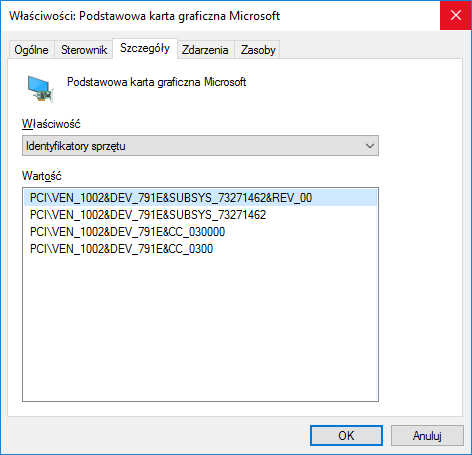

    Give a screenshot of the details tab when you double-click the graphics card in device manager. In the property field, select Hardware ID.
    It will look something like this:
    Windows 10 Screen Resolution Issue: Switch from 1024x768 to 1920x1080 on Same Monitor & Hardware

    M9a
    Posts: 53
    Rate: 27
    Thank you for your answer
    @ Sztandar18
    The attachment is probably what you meant.

    djacek
    Posts: 224
    Help: 19
    Rate: 29
    From what I found somewhere it could be a card: ATI Radeon X1250
    I'm afraid there are no drivers for Windows 10.
    You can look here: Link where attempts to circumvent this problem are described.
  • #26 15904879

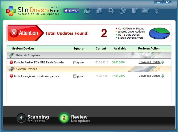

    I did as you advised. After the scan, the window shown in the attachment appeared to me. What should I do next?
    @djacek
    All the time I take into account the possibility that I will not be able to set a good resolution. I clicked on the link you provided, but I don't know English well enough to understand exactly what's going on. And I don't even know if these attempts were successful. Of course, I used the translator.
    I am asking for further help. If it turns out that the resolution I expect cannot be set, I will simply go back to W7 for now. Therefore, now I am in an uncomfortable situation, because I have to install a lot of things in the new system. And I am aware that in a short time the disk may be formatted again.
    • Windows 10 Screen Resolution Issue: Switch from 1024x768 to 1920x1080 on Same Monitor & Hardware SlimDriversFree.png (135.5 KB) You must be logged in to download this attachment.

    #29 15905195
    Sztandar18
    Level 26  
    Posts: 852
    Help: 75
    Rate: 104
    Click on download update next to both drivers. Unfortunately, you can't see the graphics card there, but you have to install it.
