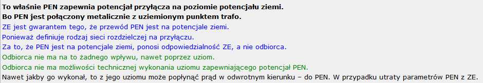

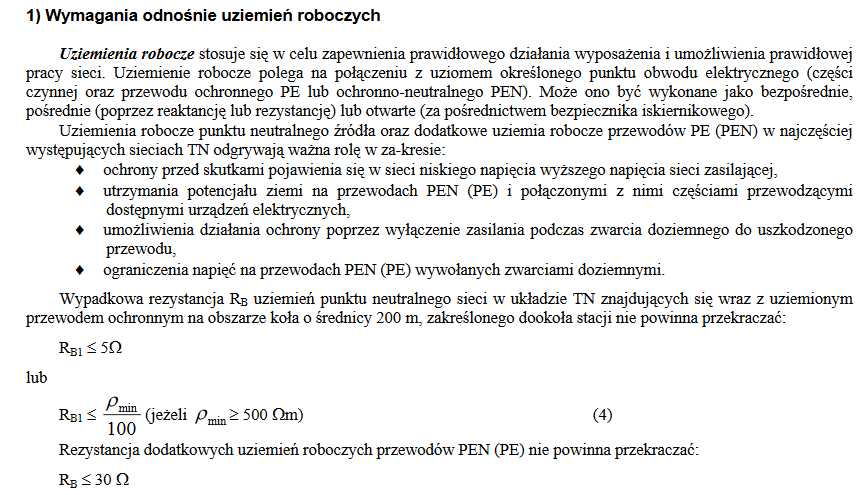

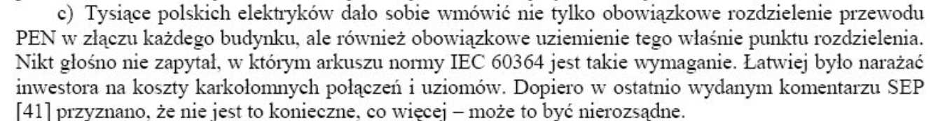

    Maybe this will help:
    Distributor's Box Wiring: Bridging PE with N or Creating Additional Grounding?
  • #37 15911728
    Łukasz-O
    Admin of electroenergetics
    Posts: 21789
    Help: 654
    Rate: 4290
    It's just all taken out of context.

  • #42 15912176
    TWK
    Electrician specialist
    Posts: 2326
    Help: 220
    Rate: 510
    The first drawing is a network standard, not an installation...
