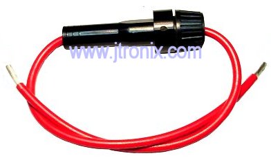

    This is just simply power/ground cable. There is a 15 Amps fuse inside this box only.
    It should not be difficult to make your own cable. It may not be easy to find exactly the same connector, if not, there is always a way around it.
    Instead of this box, you can use any in-line fuse holder - see example below.
    Seeking Assistance with Sony MEX-XB100BT Car Audio Headunit Missing Accessories
    Before you plug this radio in your car - read manual - there are two ways to hook up this radio with this cable to car power system.
    For your convenience, I attached this radio’s manual also.
    Good luck!

    Do you think if I wire it with a cable from my car battery AC and I use only a fuse it will be OK? I don't want to blow up my head unit.

    You will be fine, you do not need to worry.
    There is a reason why Sony includes this cabel with the radio. And it is explained in manual.
    Just read it!
    By the way, the best US website regardnig car radios lists all items which come with a radio.
    In your case, your item is described as "Power/Ground harness".
    No stabilizer or filter, just simply "Power/Ground harness".
    Take a look -> Link - scroll down to "What's in the box" section.
