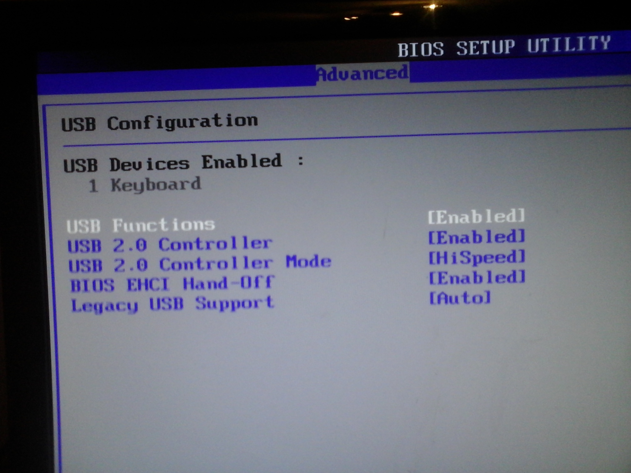

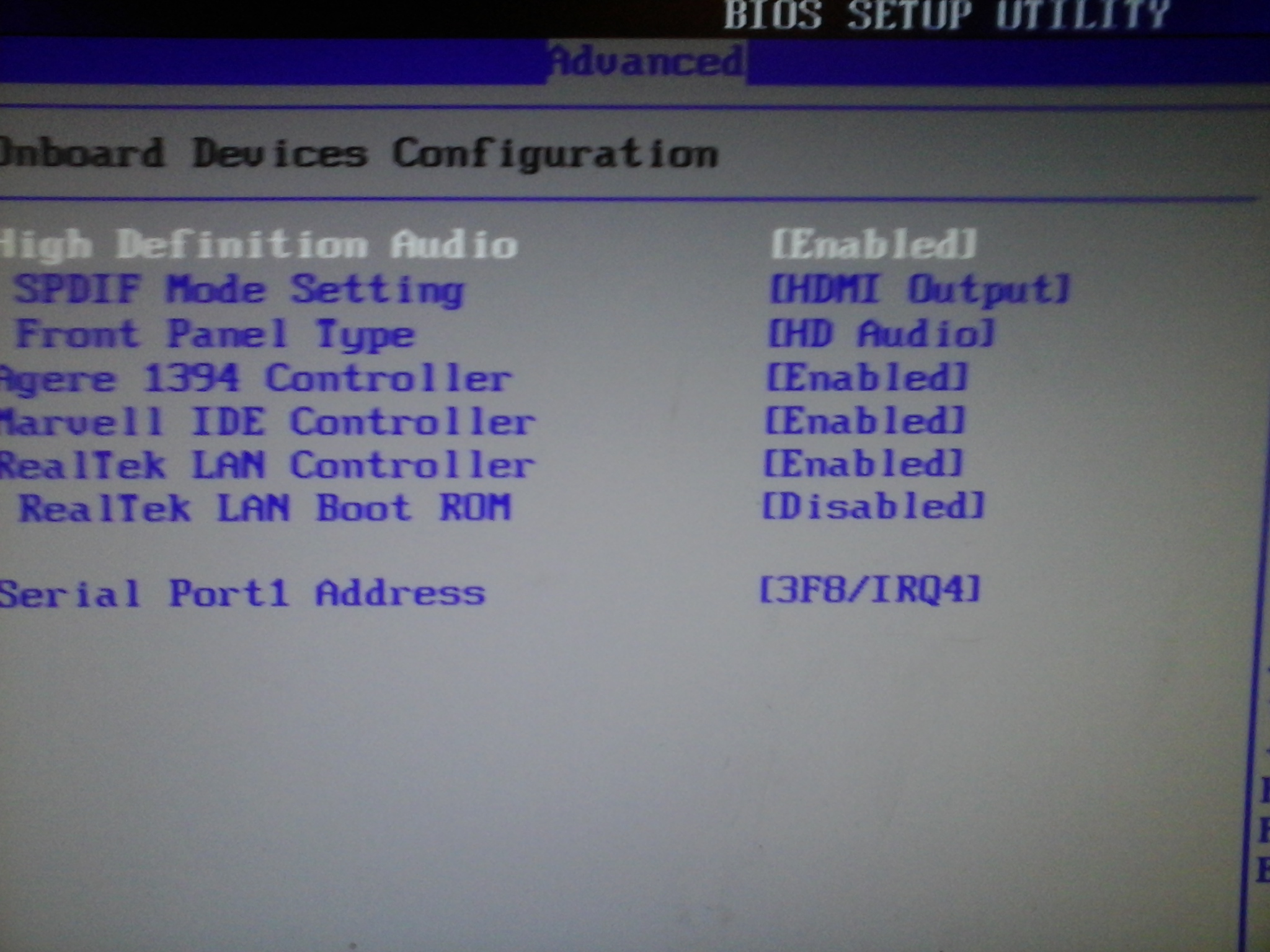

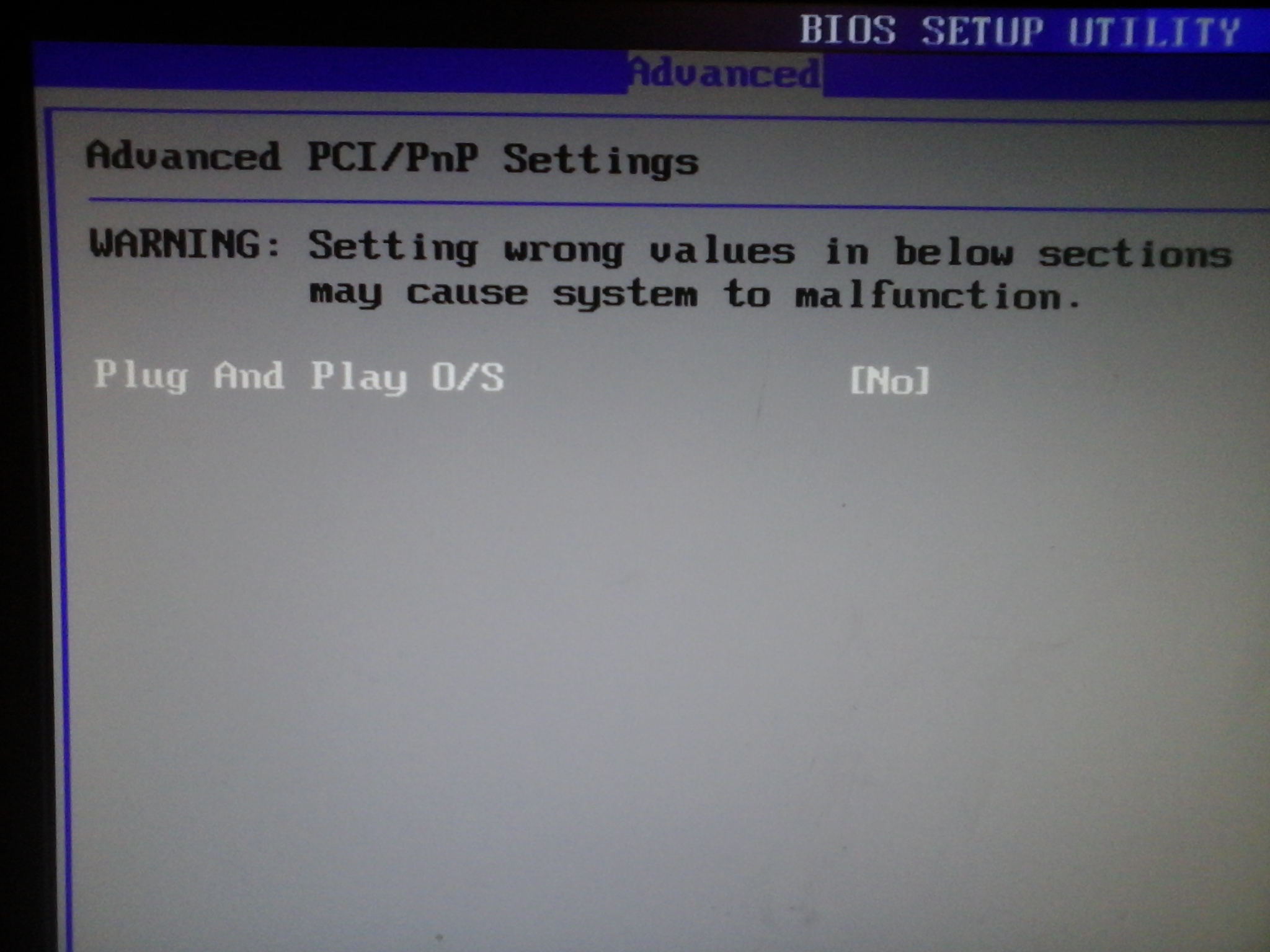

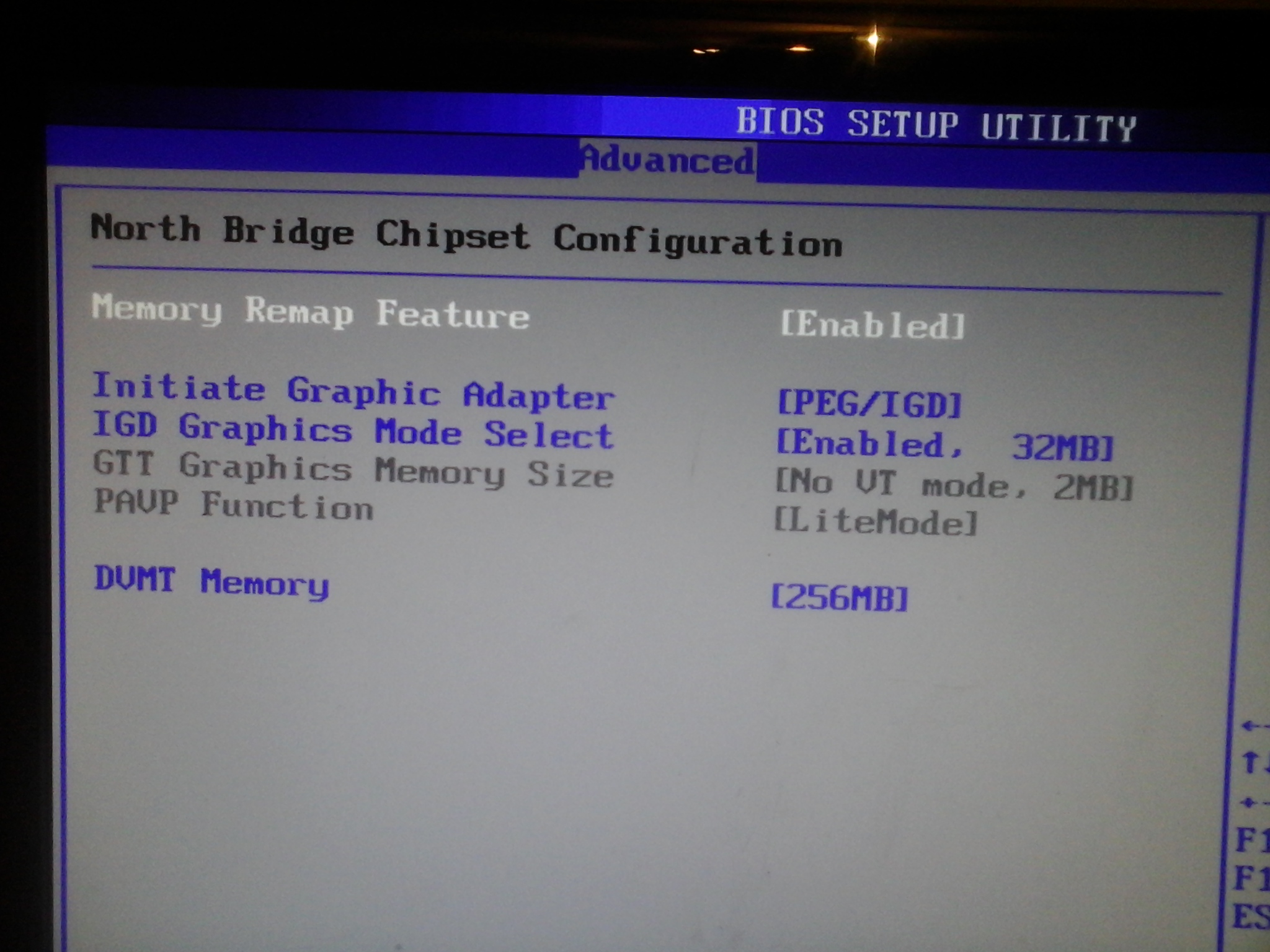

  • Question about enabling onboard VGA in P5Q-EM BIOS
    #9 15975174
    Eniek66
    Posts: 177
    Rate: 11
    This is an Asus P5Q-EM board and there is no option to connect 2 graphics cards here because there is simply no second pci x16 input.
    I don't see an option like:
    Rockmancar wrote:
    Advanced BIOS Features > Onboard VGA set to "Always Enable"
    I have photos of the bios here from the advanced tab, maybe you can understand which option it is and the question of whether it is at all.
    FPS Impact on GTA V and CS:GO When Connecting HP 1280x1024 with Benq 1920x1080 to GTX 750 Ti FPS Impact on GTA V and CS:GO When Connecting HP 1280x1024 with Benq 1920x1080 to GTX 750 Ti FPS Impact on GTA V and CS:GO When Connecting HP 1280x1024 with Benq 1920x1080 to GTX 750 Ti FPS Impact on GTA V and CS:GO When Connecting HP 1280x1024 with Benq 1920x1080 to GTX 750 Ti

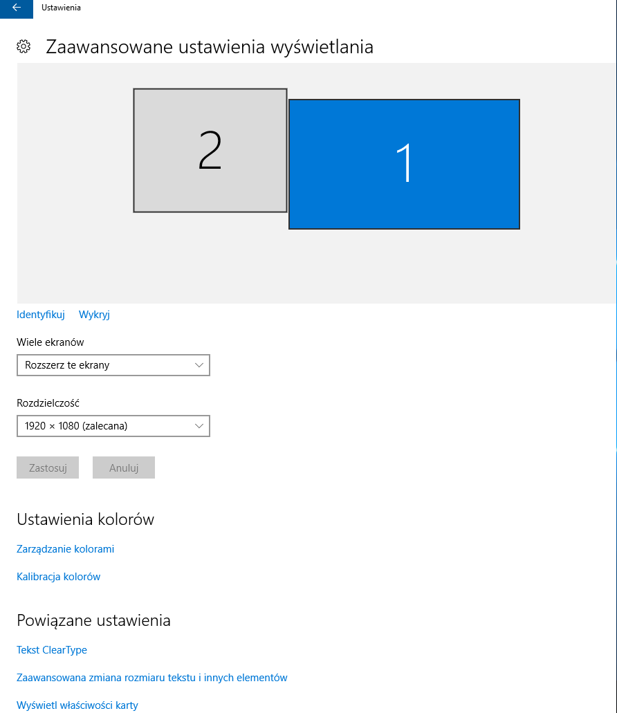

    My monitor arrived today and I have two annoying problems:
    1. When I have the game turned on on the main monitor and I want to, for example, enter the browser on the second monitor, the game minimizes
    2. It's that some apps when I open on the second screen it shows on this main screen.
    Anyone know how to fix it? FPS Impact on GTA V and CS:GO When Connecting HP 1280x1024 with Benq 1920x1080 to GTX 750 Ti
  • #13 15977038
    n.vision
    Posts: 1763
    Help: 108
    Rate: 260
    You need to set the game to play in a borderless window in the game settings, it depends on the game whether it allows such an option. Newer games allow this more often. Maybe something can be done in Windows, or in the software of the graphics card wj, but I don't know anything about it. I have no clue about the other issues.
