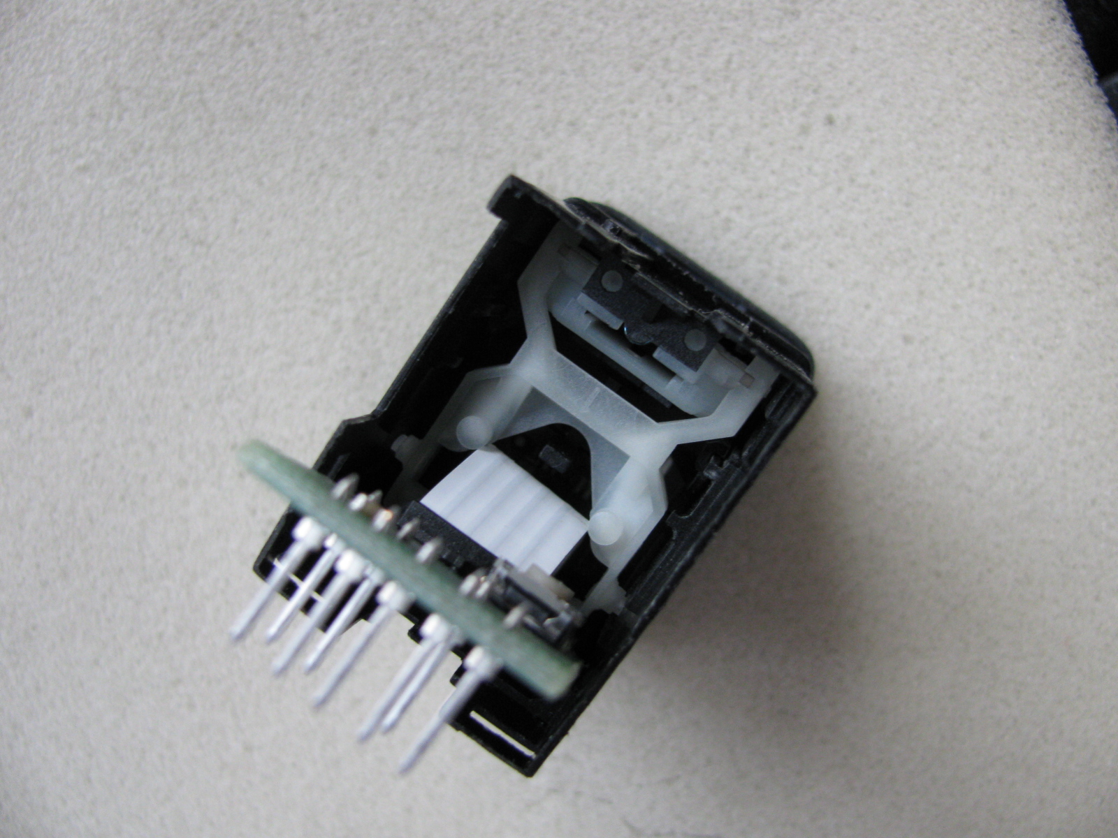

    I have not found such a marking on the motor, there is only the word TRW and some numbers, but different as to the button, it is 100% functional and so far I do not have to replace it
    / ordinary microstock /. It is correct to measure the current if I am opening the blocks, it is a current measurement, but only in one in 2 there is no because there is a break somewhere in the circuit.

    my job is electronics, so replacing these two micro is a piece of cake and, as a rule, they work, one is closed, the other is open and they work alternately, if it is damaged, another error pops up.
