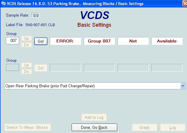

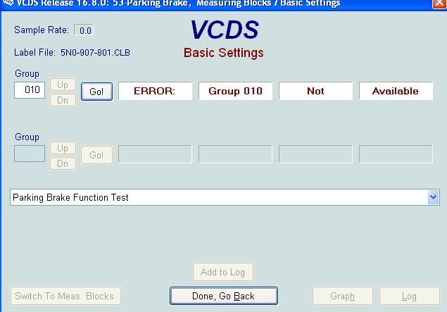

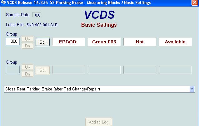

    Hello forum users,
    After replacing the rear brake pads in the Passat b6 1.9 TDI r2008 I lost access to the basic settings in the parking brake (VCDS). In other words - I go into basic settings and Nothing can be done there:
    007 - piston extraction not working (ERROR ..)
    006 - piston tightening does not work (ERROR ...)
    010 - brake test cannot be performed (ERROR ...)
    It happened because I mistakenly pressed options 006 (tightening the pistons) while the mechanism was pulled off the dial. Later, I couldn't automatically pull back the pistons with option 007 so after turning off the battery, I pulled back the pistons using inverted poles.

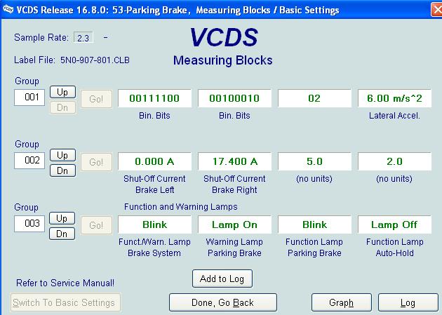

    I scanned again - this time I attached a full scan so that there was no doubt (Annex Log-194580km-120906mi - 26.10.2017-electrode). An additional error occurred:
    012295 - Camshaft Position Sensor (G40)
    P3007 - 000 - No Signal - Intermittent
    and in the parking brake section:
    02432 - Supply Voltage for Left Parking Brake Motor (V282)
    012 - Electrical Fault in Circuit - MIL ON
    I deleted the DTC and did the scan again (attachment Log-194580km-120906mi - 26.10.2017 - electrode after DTC erase). The error in the parking brake section no longer appeared.

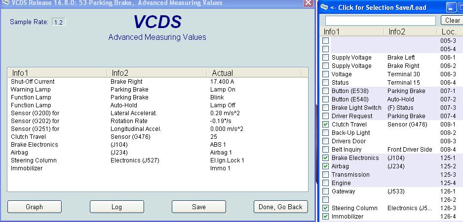

    This is how I look in basic settings (attachments Basic settings gr 006-010).
    I also took measurements in the measuring blocks (Measuring blocks 001-019) and advanced (Adv Measuring blocks) sections.
    It is strange that it shows that there is voltage for the left and right brake (group 006) while at the first scan something was shouting that there is an intermittent voltage for the left brake mechanism.

  • Soft brake pedal after clearing parking brake fault
    #6 16789015
    cas-it-solutions
    Posts: 182
    Rate: 81
    A strange thing has happened - my wife accidentally turned on auto hold while driving. Auto hold started to work and the error in the engine and parking brake disappeared after erasing (another scan did not find it). The exclamation mark on the board and the brake light also stopped flashing. The light with the crossed out P disappeared. After the next scan, there is only an error in ABS:
    Address 03: ABS Brakes Labels: 3C0-614-109-C4.clb
    1 Fault Found:
    01309 - Power Steering Control Module (J500)
    004 - No Signal/Communication - Intermittent
    The foot brake is unfortunately still "soft" - anyone has an idea what to do to start functioning as before?

    zapowietrzył :) during the auto extension of the piston after pulling the brake mechanism off the disc (never do it in passats B6 - only when the mechanism is installed :) .
    After venting, I was able to automatically pull the pistons and pull on the computer, followed by the hand brake test successfully :)
