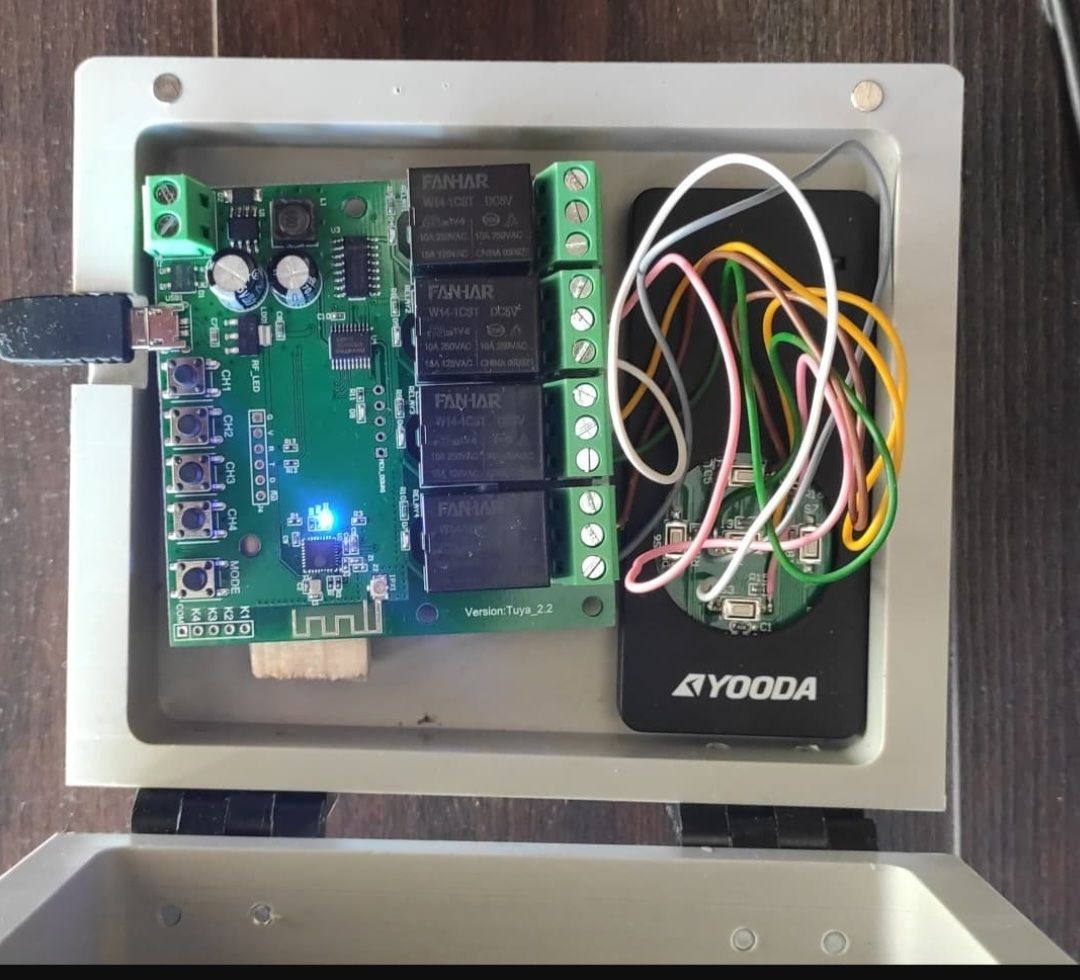

  • Tuya 4-channel relay as remote button interface
    #37 19866690
    tomo1985
    Posts: 18

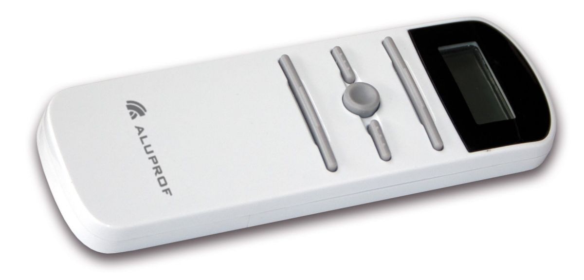

    I do not know if anyone will answer me in this topic, I have aluprof blinds with a yooda remote control. 9 roller blinds down and 6 roller blinds up. Is there any inexpensive solution to control the phone.
    I found something like this https://www.houseiq.pl/pl/p/TUYA-4CH-DC-5-32V-4-kanaly-Wifi-beznapieciowy-TUYA/1051
    To this device you can connect buttons from the remote control as shown in the picture below. I just have 4 roller shutter remotes so I could connect two. What do you think about it?

    Hello. I found a topic about roller blinds, so I don't create a new one. I have Aluprof DC289 roller shutters. The battery in the remote control has run out. Unfortunately, the second remote control is lost. After inserting new batteries, the blinds do not work. I suspect that the remote control needs to be coded. How to do it? maybe someone has the coding instructions. It's good that I have them exposed because it would be dark. Using RF Module with Raspberry PI to Operate Aluprof Roller Shutters Wirelessly

Yes. Solder optocouplers or low-power relays across the button pads, then drive them from Raspberry Pi GPIOs. This keeps original security and warranty [Elektroda, krzbor, #16043225; krzbor, #16046417].
