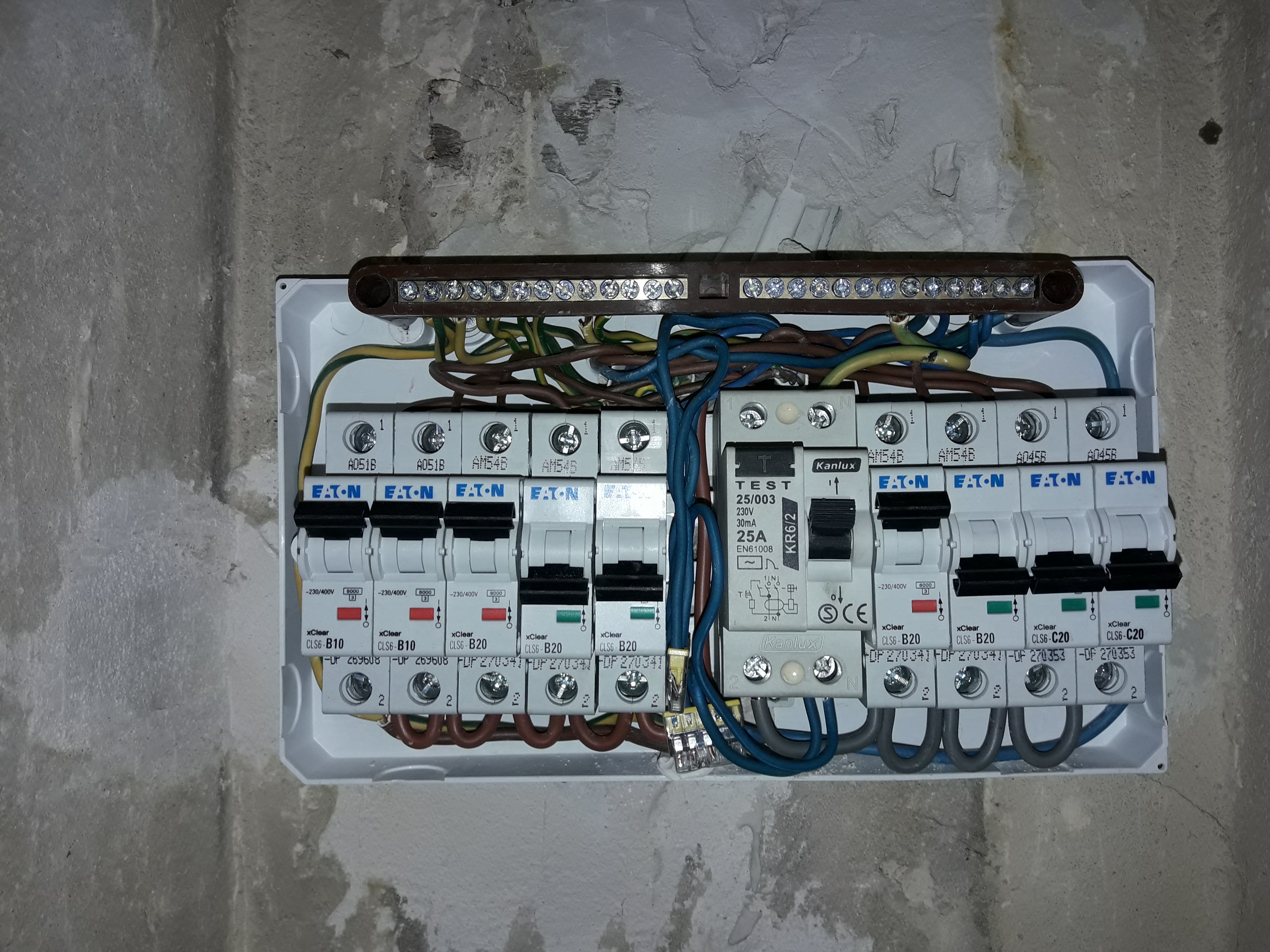

    Photo of the switchboard in the attachment, from the left:
    B10 - light in one room
    B10 - lights in four rooms and a socket in the bathroom
    B20 - 9 sockets on a 1.5 mm cable
    B20 - 2 sockets + cable for the hood
    B20 - empty
    Differential
    B20 - circumference to the washing machine 2.5 mm
    B20 - dishwasher
    C20 - induction hob 3 kw
    C20 - 4 slots
    •  One Circuit with 4 Room Lights & Bathroom Socket: Electrician's Work, 1.5 mm Copper Wire, B10 ESM 2016-11-10 21.02.24.jpg (3.81 MB) You must be logged in to download this attachment.

    I love such small pseudo switchgears, you will not press your finger on expansion or speech ;)

    Now call this bastard, let him take home the fruit of his stupidity and let him pay you compensation in accordance with the provisions in the contract ;)

    C20 at home? Security features probably selected randomly. B20 - protects the 1.5 mm2 wire, cramps errors and errors. Full-packed switchgear, where can there be a reserve?

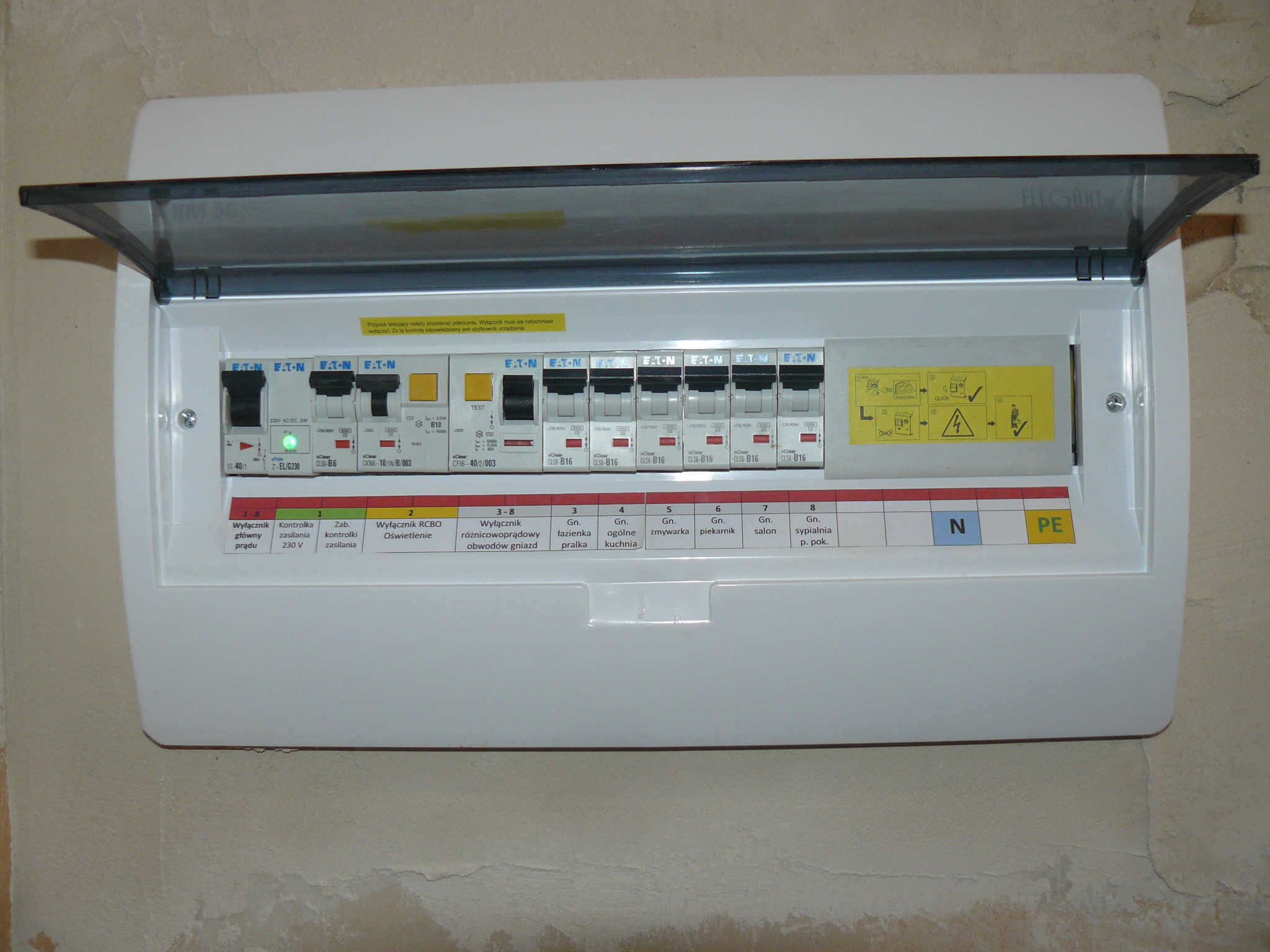

    In conclusion, let the electrician take what he wears and give the money back. What he carved cries out to heaven for vengeance. I don't even ask why he didn't apply the RCD to other circuits.
    In fact, most installations have to be made from scratch, use another larger switchgear, which will be equipped with appropriate overcurrent circuit breakers, RCD, main switch. Voltage signaling is also a good solution.
    As for the circuits:
    1. Lighting 3 and 4x1,5mm2 eg RCBO - B10;
    2. Working sockets in the kitchen 3x2.5mm? - B16;
    3. dishwasher socket 3x2.5mm? - B16;
    4. oven socket 3x2.5mm? - B16;
    5. Circuit of the induction hob 5x2.5mm? (on the side) - B16;
    6. Washing machine socket 3x2.5mm? - B16;
    7. bathroom socket (if the washing machine is located in a different room) 3x2.5mm? - B16;
    8. Sockets in rooms (max 10 sockets per circuit) 3x2.5mm? - B16.
    It is worth to separate the circuits of general sockets into rooms, e.g. living room and bedroom separately.
    I also remind you that the socket circuits must also be protected by an RCD. Lighting in the bathroom also with RCD or RCBO.
    Here is an example of an apartment switchboard:
     One Circuit with 4 Room Lights & Bathroom Socket: Electrician's Work, 1.5 mm Copper Wire, B10 ESM  One Circuit with 4 Room Lights & Bathroom Socket: Electrician's Work, 1.5 mm Copper Wire, B10 ESM
