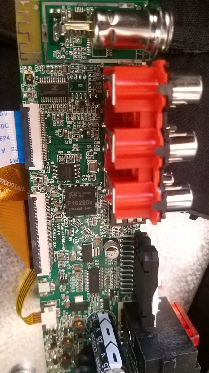

    Close-up of a circuit board with Allwinner Tech F1C200s IC. Close-up of a circuit board with an integrated circuit and electronic components. Image of a circuit board with a flat cable, model 7012b.

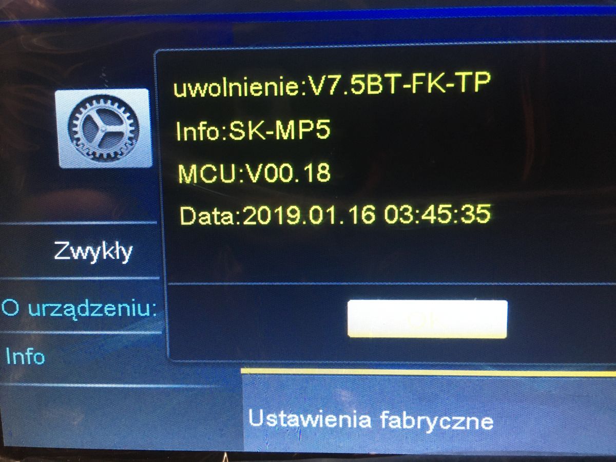

    A sister came to me with this radio (model 7010b), no mirrorlink, no Polish. I am looking for the second day and no effects, no support at all. Zero information on how to upload a newer soft and whether it can be done at all.
    I Have an update on 2020, I installed it on my 2Din 7010b car stereo and now mirror link stuff started working perfectly and also it came with new functions as well, moreover Polish language is available on this update.
    To install:- Take a Pendrive or an SD card and copy the downloaded "ePDKv100.img" file from Rar file, and plug the Pendrive or the SD card to the 2Din 7010b player and turn on it, next go to setting and scroll down an you'll see "FW Update" just click it and update will start on automatically, make sure you don't turn off your car while updating or else the soft will get corrupted.
    Password for Logo Settings after update :- 1234
    Thank me later 😇
    Your welcome brother ❤

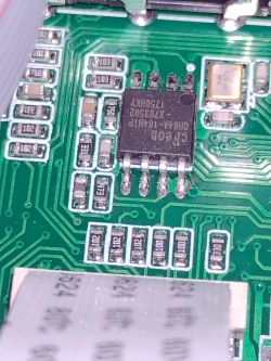

  • #64 19440975
    eduardohm17
    fui atualizar meu mp5, f1c200s, acho que utilizei o firmware errado agora a tela está preta, e o mp5 não está dando reset
    o na placa tem alguns números escritos
    Image of a green circuit board with details and connecting wires. Image of a circuit board of an electronic device with visible markings and connectors.

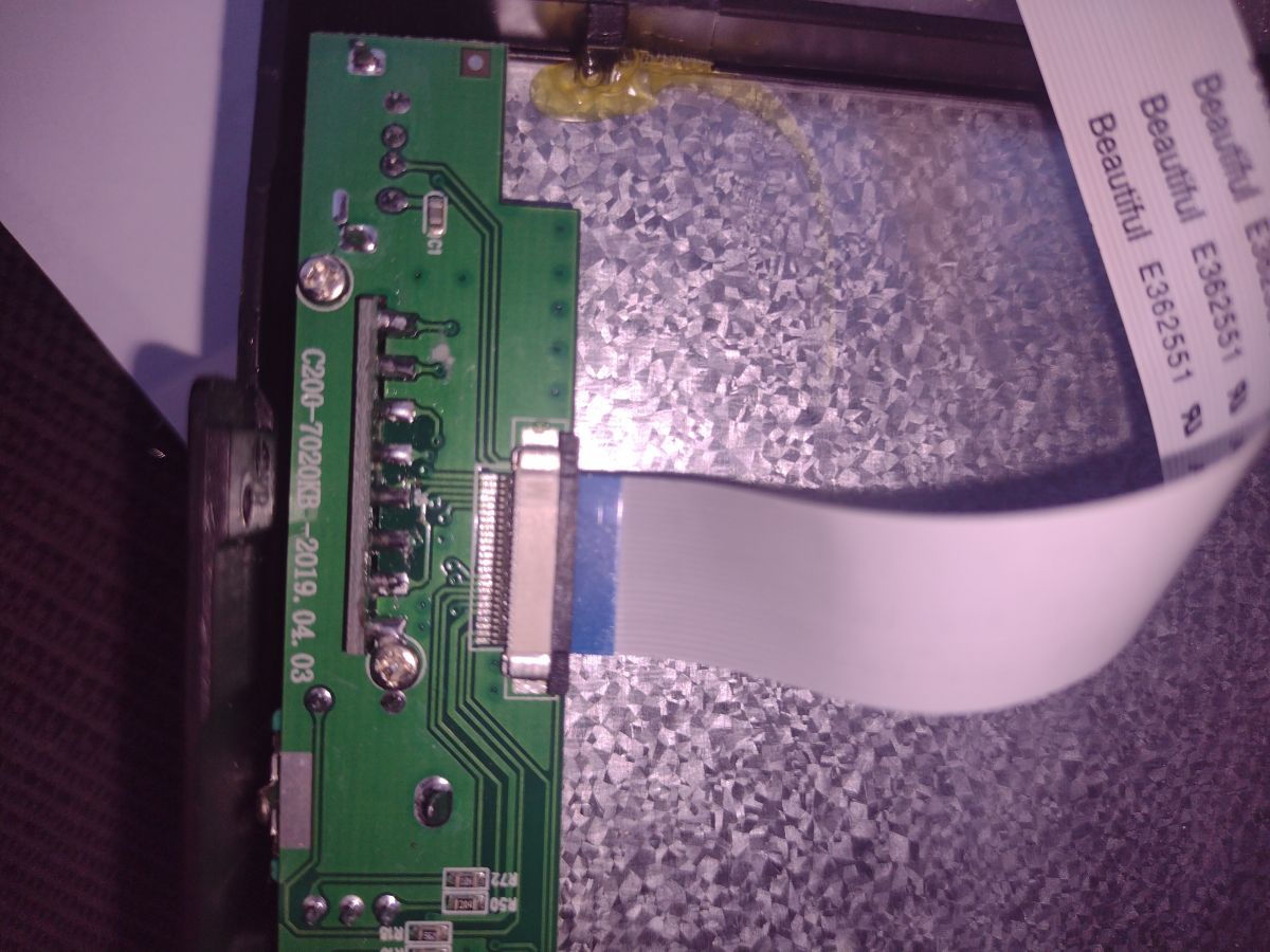

    I have a 7018B car MP5 player, it is doing some problems.
    I need a latest firmware update img file for F1C200s to solve the problems.
    Attached the image of board,
    Please help me.
    Thank You
    Internal view of the MP5 7018B car player's motherboard.

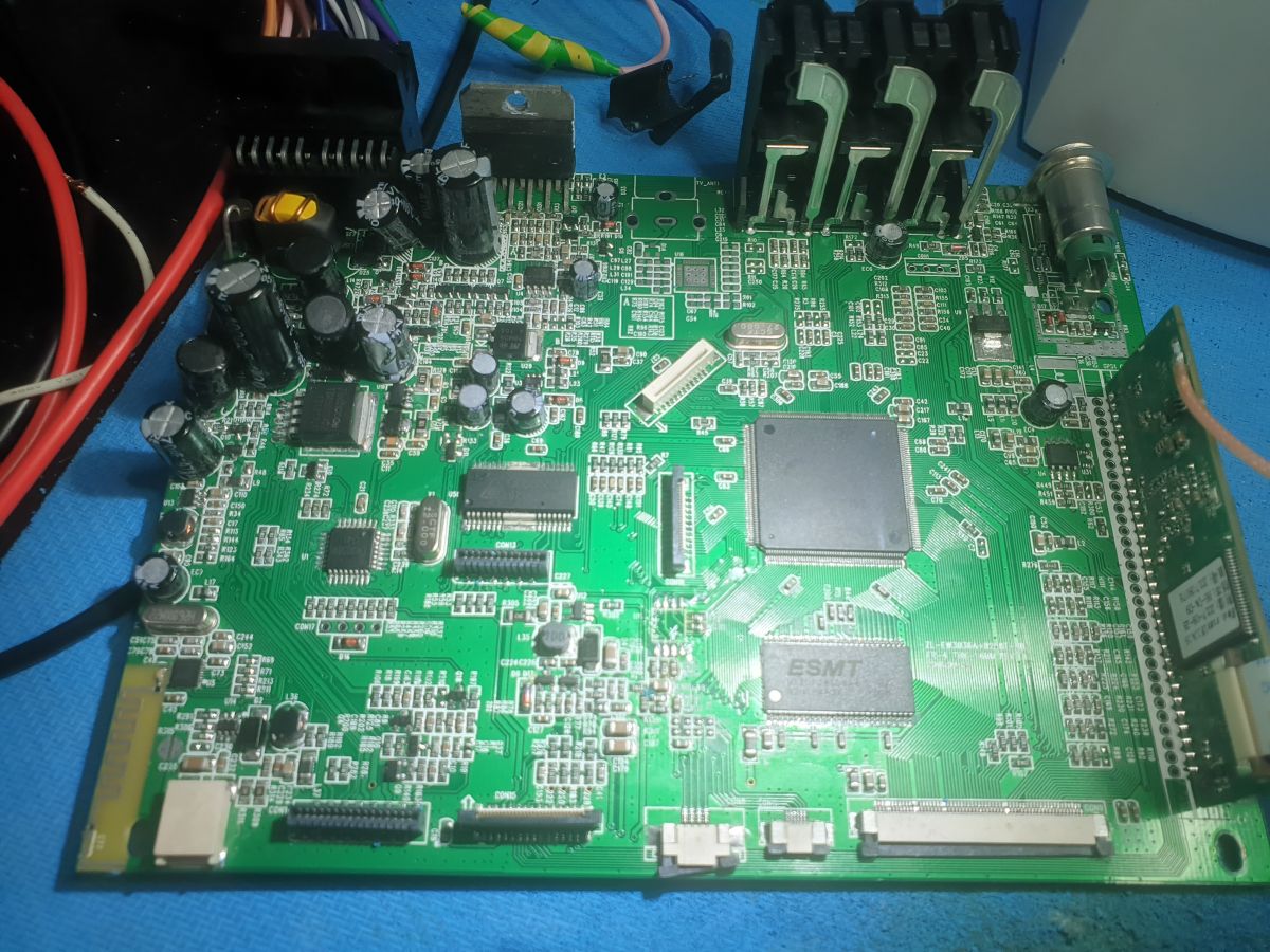

    #79 19661686
    Joke90
    Hello, a friend of mine sent me this radio to take a look at it.
    History: Everything worked fine then suddenly the screen went off but music continued to play. He replaced the screen but no luck.
    Info:
    BOARD MARKING: ZL-EW3036A 8288T - MB FR-4 THK-1.6MM REV:1.1 2016.04.26
    CHIPSET:SPHE8288T 1731
    MCU: EW3036A 1741
    M12L128168A-6T
    CD5888CB
    EEPROM: MX25L6406E M2I-12G
    Does anyone have eeprom flash file?
    Thx in advance.

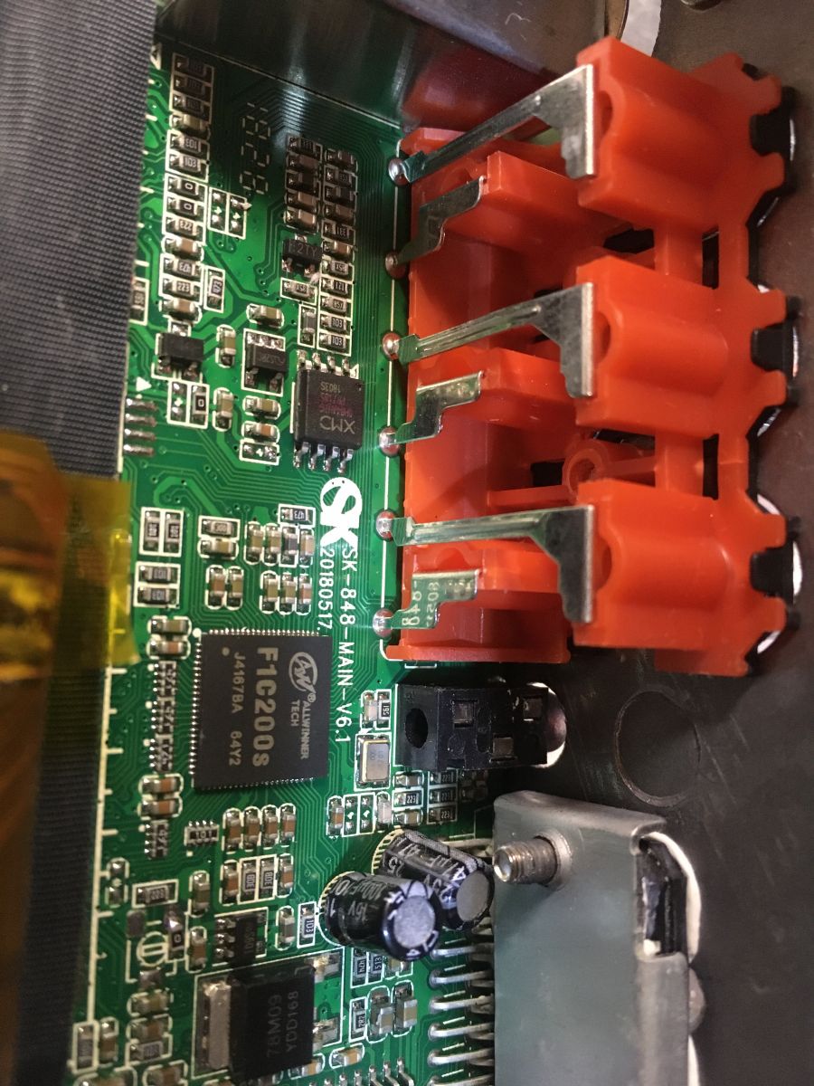

  • Seeking compatible firmware for 7010B radio with mirror link and Bluetooth

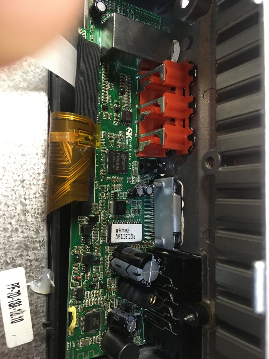

    #82 19896376
    chriss666
    Posts: 52
    Close-up of a radio motherboard with several chips and connectors on a green circuit board.
    I am looking for a newer software for Chinese radio, I mean mirror link and bluetooth phone support. I tried many electrode min files that fit under my processor but either the radio was dead or the touch was not working in most cases. Programmable differently depending on the type of file, either by updating the USB, or with the CH341A programmer, with the "Neoprogrammer" program.
    In the attachments my dump ripped with a programmer, and photos of the motherboard and the software version, maybe someone will help in resuscitating the radio.
    Regards and I am asking for help in finding the right software
    Screen of a Chinese car radio showing software version information. Interior view of Chinese radio's mainboard.
    • SK-848 V6.1 F1C200s XMC XM25QH64A DUMP.bin (8 MB) You must be logged in to download this attachment.

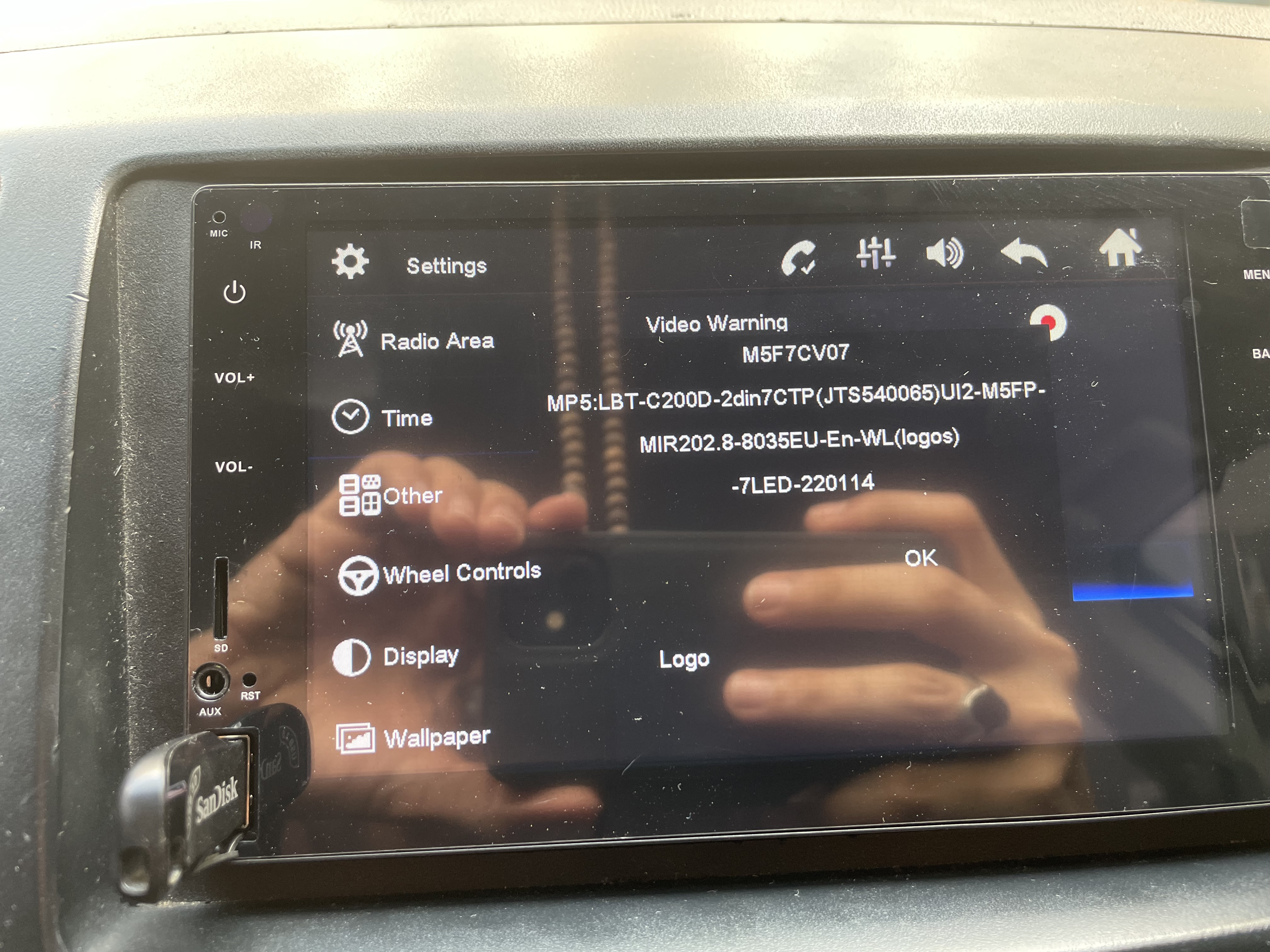

  • Requesting compatible firmware update for 7010B radio

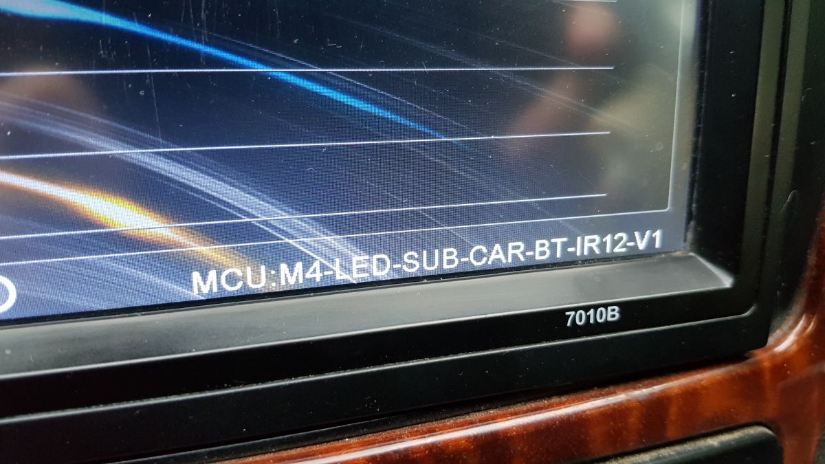

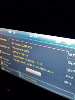

    #83 19906610
    vktdi
    Hello guys
    I also have a radio 7010b from Aliexpress.
    I got these infos from the main menu, accessing Menu "Definitions" from the radio.
    MCU: V129.18
    Date: 2020.10.26 09:18:18
    Versao SW: ZCD-7106-6925-APK
    Can someone tell me please if there is a more recent firmware update that I can use and fully compatible?
    I keep hearing that if you do a wrong firmware update, you will ruin the radio without turning back point.

    Methsan wrote:
    Car player 7010b settings screen displaying BT and software version information.
    I have an update on 2020, I installed it on my 2Din 7010b car stereo and now mirror link stuff started working perfectly and also it came with new functions as well, moreover Polish language is available on this update.
    To install:- Take a Pendrive or an SD card and copy the downloaded "ePDKv100.img" file from Rar file, and plug the Pendrive or the SD card to the 2Din 7010b player and turn it on, next go to settings and scroll down and you'll see "FW Update" just click it and update will start automatically, make sure you don't turn off your car while updating or else the soft will get corrupted.
    Thank me later 😇

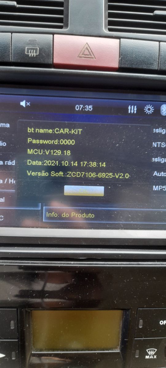

    amoisnascimento
    Rate: 10
    Bom dia alguém me consegue atualização, mais recente para o seguinte
    bt name:CAR-KIT eslig NTS Password:0000 MCU:V129.18 esliga Data:2021.10.14 17:38:14 Auto Versão Soft.:ZCD7106-6925-V2.0
    Desde já agradeço...
    Car multimedia system screen displaying information about Bluetooth name and software version. Searching for Flash Plug 25L6406E for Chinese Radio Station Model 7010B - Software Needed
