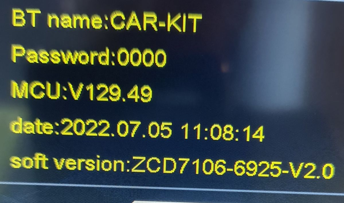

  • Power supply instability causing radio crashes and reset loss
    #118 21278556
    eduardjolmes
    I bought the 7010B radio for less than 30.00 euros.
    It seems to have good potential.
    It has a touchscreen.
    It plays FM stations.
    It recognizes tracks on a USB stick and plays them.
    I was able to connect it to my Galaxy 22 via BT and play music from it.
    But this only works when the car is stationary and the ignition is switched on.
    When I start the engine and accelerate, the device crashes and no longer responds to anything.
    My layman's guess: The current supplied by the generator is too strong and causes the device to crash.
    Another assumption is that the steady plus and plus for ignition are reversed.
    It forgets all the settings.
    What a pity. It actually makes such a good impression when I run it from the battery power of the Audi A2.

    Hi. Can somebody help me with a firmware with hungarian language? Thank You.
    Car system display showing Bluetooth info, password, MCU version, date, and software version.
