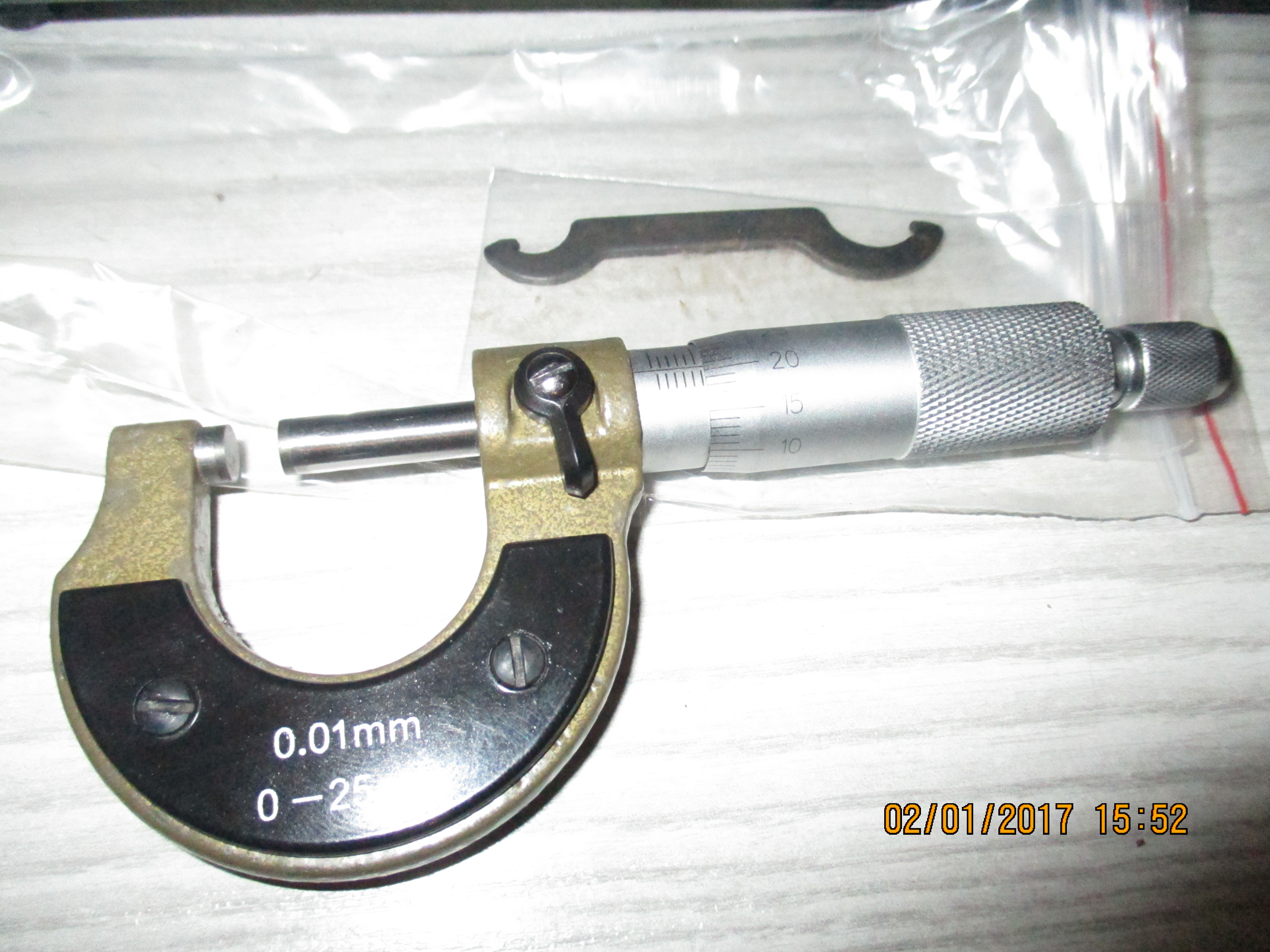

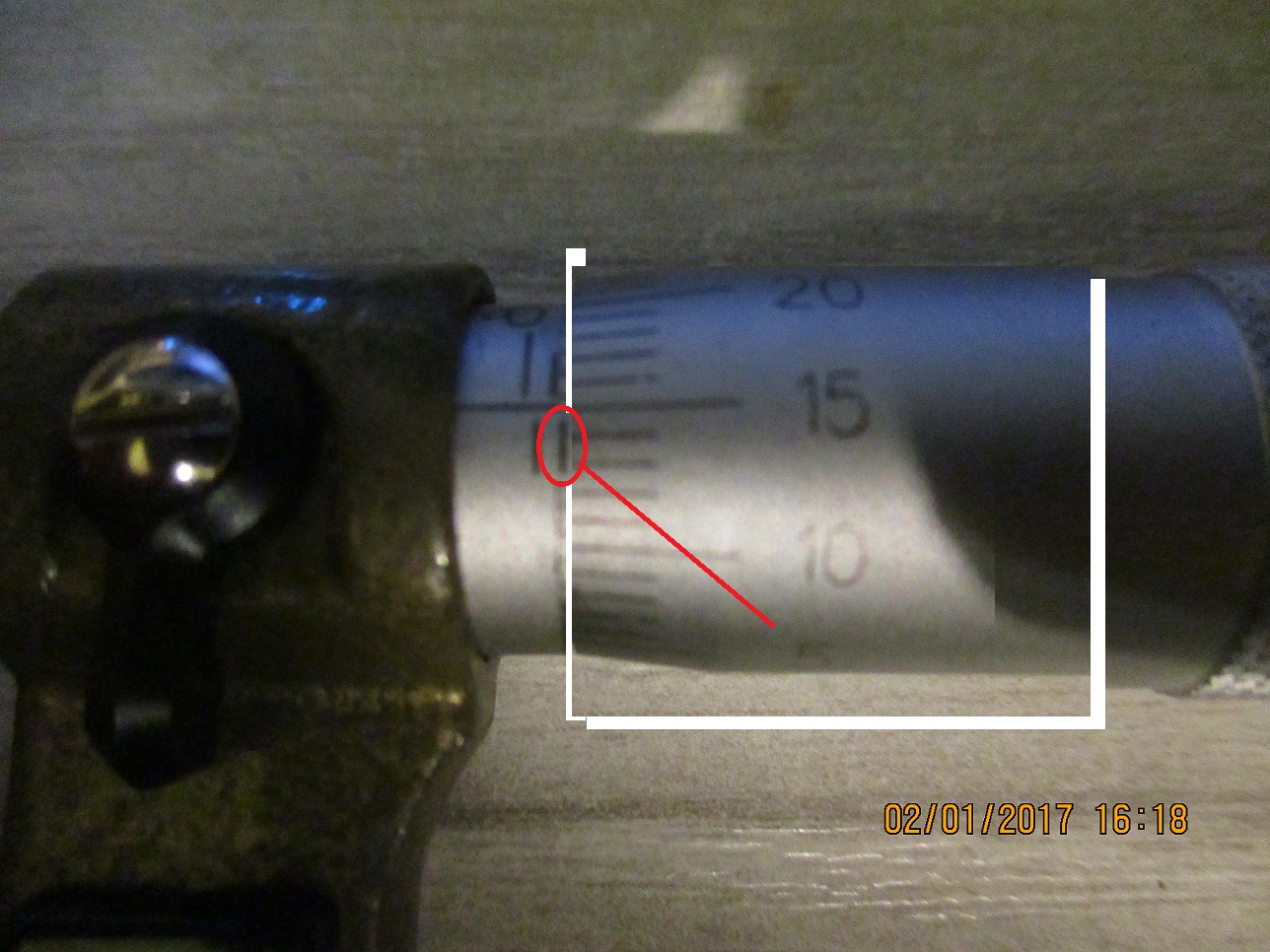

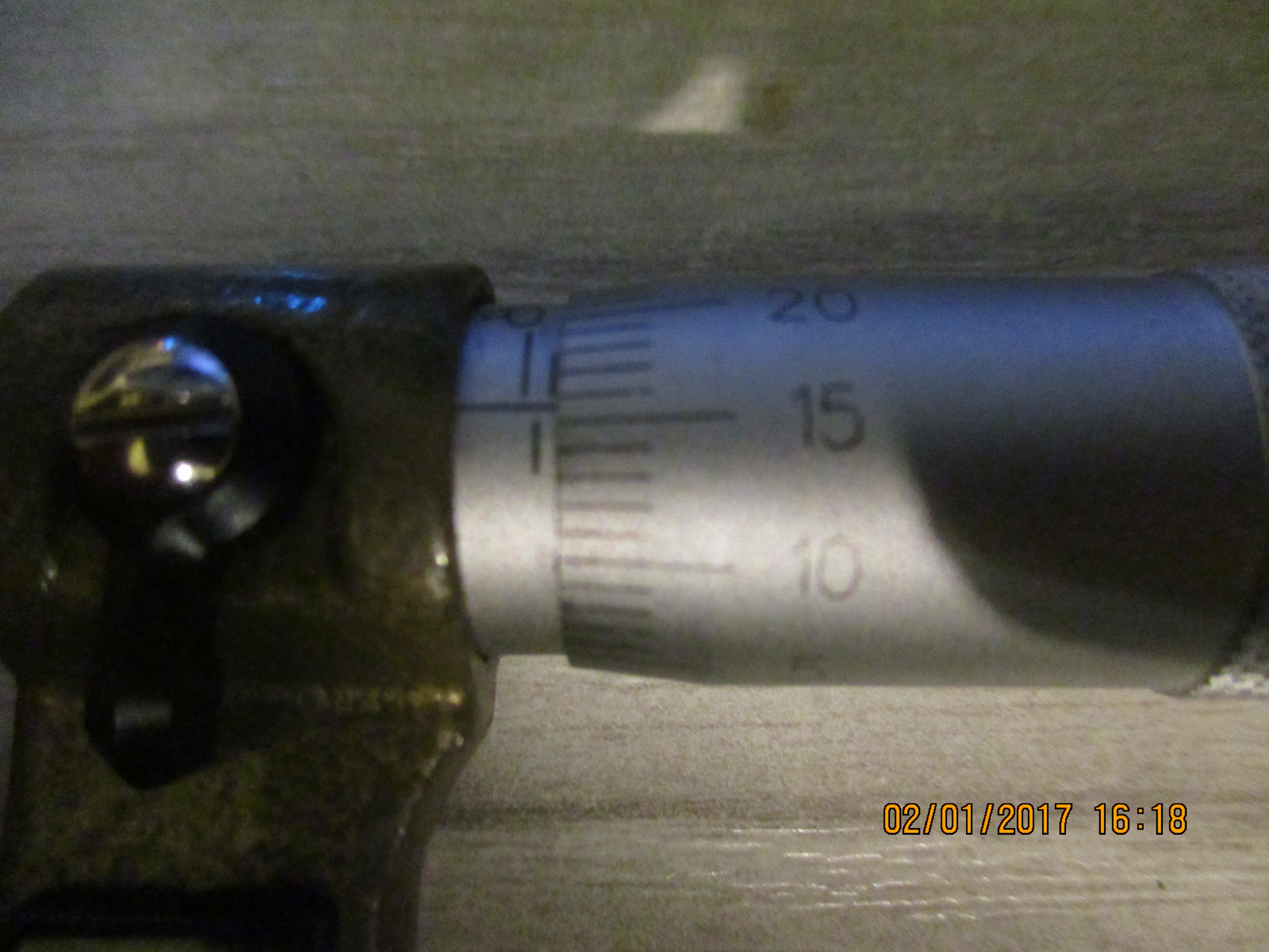

    aalfonso wrote:
    The result is 1.15mm?
    Yes, here you have a result of 1.15 mm. Horizontal scale you have every 0.5mm and you add a hundredth of a millimeter indicated on the vertical scale (looking at the second picture) - it is not too complicated ;)
  • #3 16168766
  • #4 16168864
    KaW
    Posts: 2616
    Help: 170
    Rate: 306
    It is best to take a feeler gauge and practice measuring. And what are the values
    on this "knob"?
  • #5 16168879
    #6 16168937
    grala1
    VAG group specialist
    Posts: 9823
    Help: 1495
    Rate: 5052
    Your reading is correct.
    There you have 3 readings.
    At the top inch inches, at the bottom where, you marked the halves in 0.50 mm and on the screw another 0.5 mm, so you have 50 strokes on this scale.
    50 because the accuracy is 0.01mm
    50x0,01 = 0.5 mm
    The final result consists of the sum of 3 readings.
    This "shifter" is for locking the bolt - something like a lock for a lock is a screw.
    The key is set to zero but you should still have a pattern for this.
