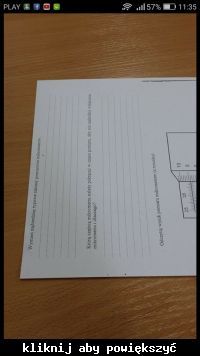

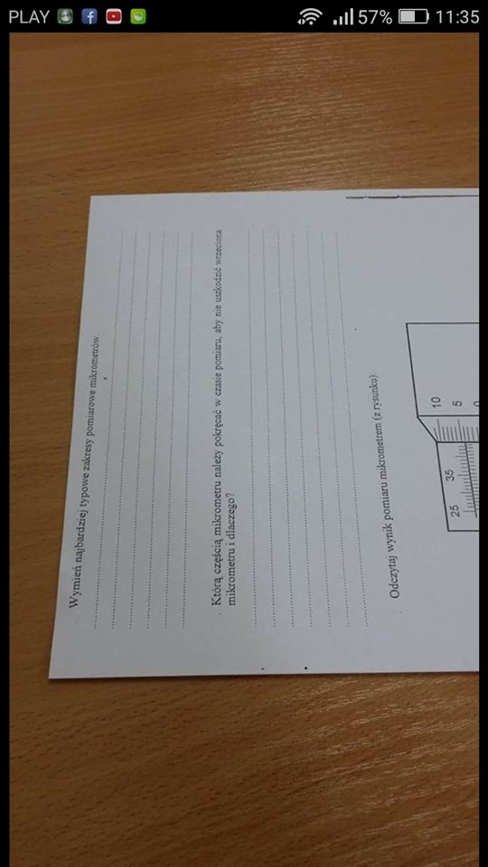

    Hello, I have a problem, I don't know anything about micrometers and dial gauges and I have a test and I would like to pass
    Someone could help me, I would ask

    Standard measuring ranges
    0-25, 25-50, 50-75, 75-100, 100-125 etc.
    The so-called friction clutch knob rattle
    39.04 mm
    http://opisy.przyrzadypomiarowe.prv.pl/6mikrometr.htm
