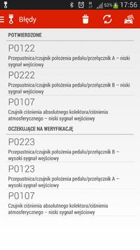

    [film: cc9bfdd233] https://filmy.elektroda.pl/1_1483453449.mp4 [/ film: cc9bfdd233] Hello ... yesterday evening while driving, the car went out, for 15 minutes I tried to start it, which I did with a great with difficulty .... I drove 5 km because I missed so much home. This morning he did not fire again ...
    There are 3 errors on OBDII .... the damper is cleaned chevrolet aveo 2006 1.2 8V - Problem with starting the car .... turns but doesn&

    And what do the measuring blocks say, e.g. does it see shaft rotation ??? , because in my opinion none of these errors should cause that the car does not start.

    Check if you have a spark from the coil, can you hear the fuel pump?
    How do you spin to feel gasoline?
    Check all plugs and connections at the motor, unplug, inspect for corrosion, moisture, and reconnect. Also watch at the computer. Errors may indicate a lack of contact in the supply of these sensors.
    Do you have a starter, upholstery poster, some gas? Piss a little on the throttle and see if he will want to talk.
    You removed the pipe from the filter yourself?
    Do you have gasoline in the tank? Don't follow the clue, just think if there should still be fuel in the tank.
    Look under the camshaft or the camshaft is turning. Otherwise, it turns the engine lighter than before?
    When was the timing done?
    Any other insights than faded out and hard to fire? Did he shoot or stop the engine?

    Hello ... it turned out that the step and the signal that is from a mono-injection ... waiting for the part

    Yeah, it means disbelief. This is unlikely to be the case with the stepper motor. Even if it were pressed with gas it would fire
