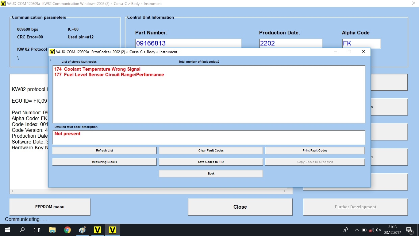

    Hello everyone, I have a problem with the Corsa C 1.0 2002 after 4 weeks of standing the car did not want to start, only after turning on the ignition the Check lights were flashing and the car with the key and relays fired under the bonnet and the throttle starter does not start. First of all, I cleaned all masses under the bonnet, it got better because the relays stopped and once in 5-6 firing attempts the engine is surprising, once it works properly and sometimes it doesn't maintain speed. idle only about 500 rpm it doesn't go out you can go, nothing happens after 40 km, it fires up as if nothing happens after a night of standing, the problem returns. Adds movies and trouble codes maybe juk someone had such or similar problem

    Clear all errors and do diagnostics after a night when you can't start the car. Check in real whether the system recognizes the key.
    error with immo cannot be deleted is active all the time or can it be damaged motor driver? Because immo would not cause what is happening in the film

    Check the power supply on the engine ECU if you have full voltage at all. Does not die on one of the rhythms of throttle knocking.
