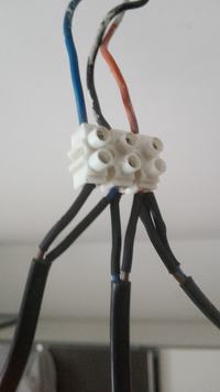

    As I'm green in the field of electricity, I need your advice. The case looks like the picture: 3 cables from the ceiling (black, blue, brown) and 3 bulbs, each with 2 cables (blue and brown). How to connect them to make everything work?

    Probably it will be like this:
    All blue with the chandelier together and combine with the blue on the ceiling.
    Two brown chandeliers together and combine eg with brown on the ceiling.
    The remaining brown chandelier combine with black on the ceiling.

    Thanks for the answer. I plugged it in and only two bulbs are lit, or only one bulb, there is no option to turn all 3 together, what can it be?

    What is your switch?

    One with two up / down flaps.
