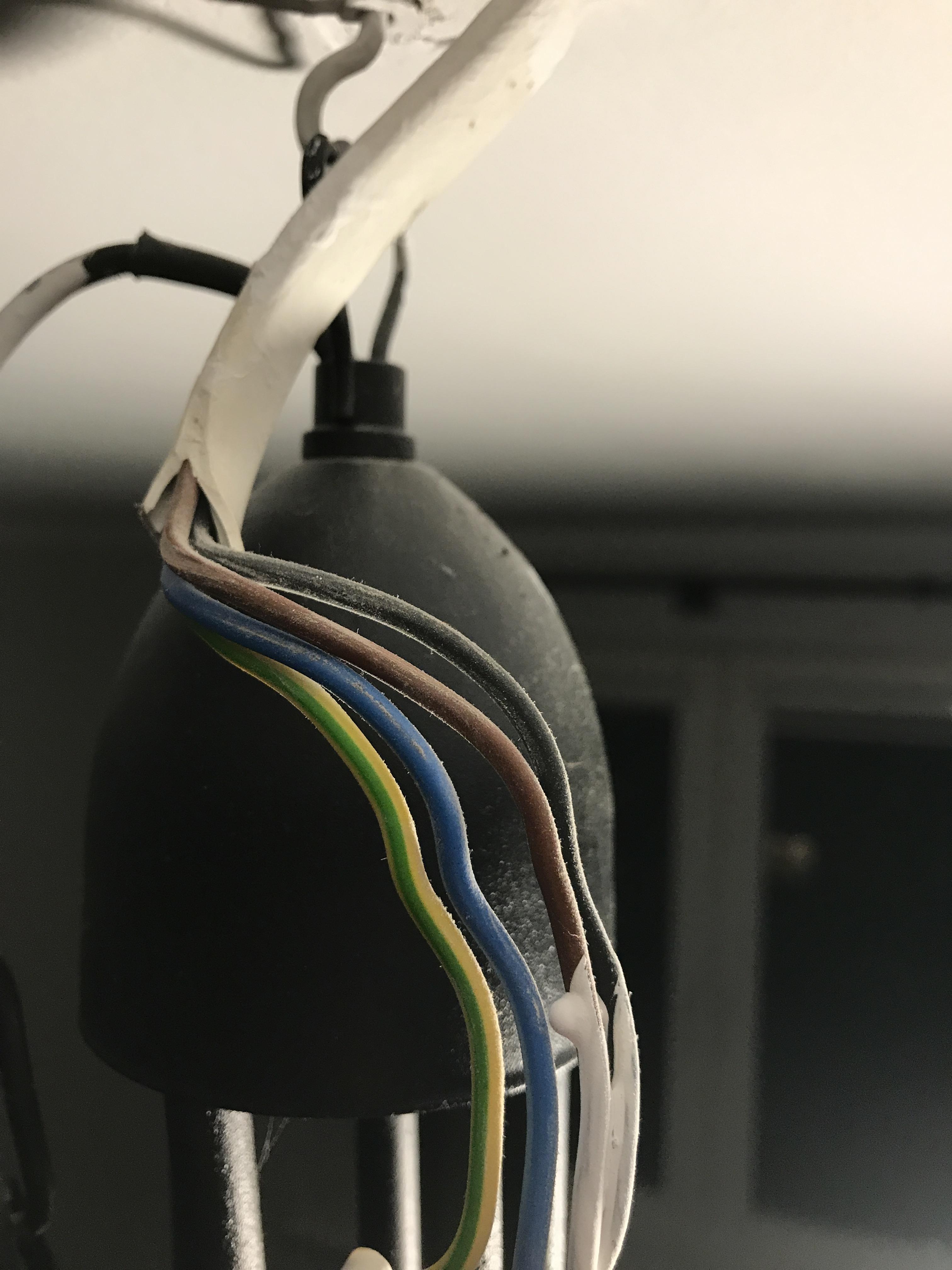

    Hello, I am asking for help in connecting the chandelier as in the subject, so that you can turn on 2 bulbs, 3 bulbs or 5 bulbs. Below photos of wires in the chandelier (from the bottom L2, L1, grounding, N) and on the ceiling. Thank you for your help. Chandelier 5 Bulbs 2+3 Connection: Wiring Help for 2, 3, or 5 Bulbs On (Photos Included)97EA091B-0...8FCB1.jpeg (1003.33 kB)You must be logged in to download this attachment. Chandelier 5 Bulbs 2+3 Connection: Wiring Help for 2, 3, or 5 Bulbs On (Photos Included)5469EEEF-3...F585E.jpeg (833.01 kB)You must be logged in to download this attachment.

    L1 -black
    L2 - brown
    N-blue
    ground-to-ground
    The condition is that the installation is prepared for a double switch.

    Welcome. But on 4 wires (including grounding) you will not realize such a configuration. Because one is PE, the other is N and the other two are phases switching on two circuits. It is not possible to control the circuits on two phase conductors. You can only connect to two configurations.
    Edit: It is possible - if two circuits are connected.
    Either 2, or 3, or 2 + 3 = 5.
    Of course I will. Note that the third combination is the result of the first two.

    Gentlemen, thank you for all the advice, 2 +3 works on two switches. Only I have one problem, or rather a buzzer, because when one side (2 bulbs) or the other (3 bulbs) of the switch on the tube is on, there is voltage on the brown and black wires. Also, please advise how to connect the cable in the double switch, or is it supposed to be like that?

    zgorany wrote:
    the test tube has voltage on the brown and black wires.
    "Something" is induced in the unloaded cable,
    which runs parallel to the laden.
    I would only call it potential, not tension.
    You can check it on your own skin.
    If the black vein bulbs are lit, touch N to this unloaded brown vein
    and the potential will disappear. There will be no short circuits.
    YOU HAVE NO IDEA DON'T RISK !!! ;-)

    zgorany wrote:
    or is it supposed to be this way?
    It will be like that.
    Don't stress :-)
