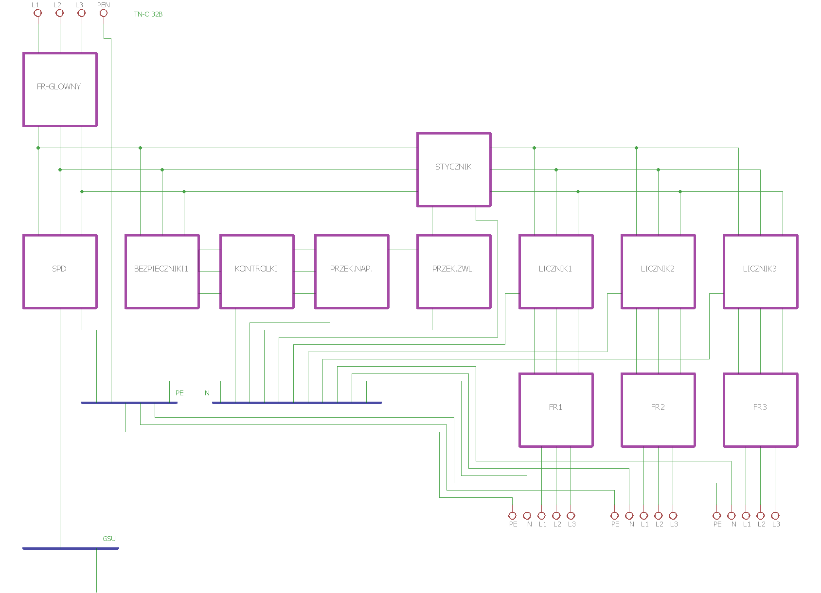

    Hello all,
    Please check and comment on the correctness of the wiring diagram that is to be at the entrance to the single-family house. The installation from the ZE is of the TN-C type, there is a 25C fuse behind the meter.
    From the above-mentioned switchgear there are to be protections, meters and a switchboard to 3 further switchboards within this house.
    Legend:
    FR-main, FR1, FR2, FR3 - Eaton IS-100/3 switch disconnectors

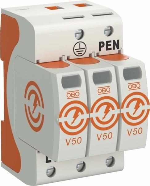

    SPD - OBO BETTERMANN V50-3-280
    Fuses - F&F BZ-3
    Controls - F&F L9-3F
    Elements of additional protection against shutdowns I wrote about here
    https://www.elektroda.pl/rtvforum/topic3033679.html
    Gear. nap. - F&F CP-730
    Gear. esp. - F&F PCR-513
    Contactor - F&F ST25-30
    The GSU is below the switchboard.

    This is not an electrical wiring diagram. It is something like a block diagram of an electronic and IT system.
    In the power industry, other information is simplified (e.g. single-line diagram) and other information is exposed.

    Right, it is more of a block diagram, there are no proper electrical symbols there, mainly due to poor knowledge of the Eagle in which it was created. There was also no description of the findings, but I hope that they are obvious.

    For mine, it's done wrong.
    To find out if it is well designed, you need to know what's next, because at this stage it looks poor. The PEN split point is missing.
    And one more thing, please explain to me how you can be a bit of an electronics technician by education, but more of an IT specialist ?? either you are or you are not ;)

    Unfortunately, this diagram is hard to read.
    FR at the "entrance" is ok.
    The PEN bus (and not the PE in a colleague's accident) is not grounded by the GSW (theoretically by the apparatus - protector but it cannot be).
    I don't understand the fuse-indicator-relay system. How is it supposed to work?
    It is connected in series?
    What does the contactor do in this system?
    Why does a friend have 3 additional counters?
    Where are the installation security?
    No information on cable cross-sections, security calculations.
    A little more description, please ...

    Next there are to be switchgears with protection for home appliances, RCDs rather single-phase and ES.
    The OBO BETTERMANN V50-3-280 has two outputs. One for direct connection to ground, the other for the PEN bus. I like this solution, the valued DEHN also has it. Often, the protectors are connected via the PEN bus and this is not good, in the event of activation, the load passes through additional elements and so goes straight to the GSU.

    So, despite the fact that the protector has a second output, go down separately to the GWS (GSU?)
    I am in a hurry to explain.
    I once described the situation in this topic https://www.elektroda.pl/rtvforum/topic3033679.html but I will repeat here. It happens that during some work in the distribution they turn off the electricity, sometimes they turn it on for short intervals, sometimes they turn on and off for two or three seconds within one second. Once upon a time something like this happened and I noticed, I thought it was probably one time. But no, it was the same recently. I am writing about a situation that I noticed while at home and how many times it could have happened when I was away from home.
    The security consists of the following elements:
    Voltage relay that disconnects the current when the supply voltage is too low or too high
    Time delay relay that will disconnect in the event of power failure and turn on with a set delay when the voltage recovers.
    Contactor as an actuating device
    Dodawkowo
    Fuses - F&F BZ-3
    Fuses, which were to protect only the controls, but there is no problem to protect the controls and the above systems.

    Sorry, it's actually not very bright in places, especially the controls that appear to be connected in series :)
    jw
    These are outputs to further local switchboards with final fuses for socket and lighting circuits
    It seems to me that a selective RCD 0.3A should be included here in the role of fire protection. I did not want to add any ES due to the fact that they are in further switchboards. There is a main fuse from ZE 32C. Throwing in additional fuses here can be problematic. When their performance characteristics match, this can create additional problems such as instead of throwing out one fuse that protects the end circuit, it will throw out the one inside, disconnect more circuits, and you will have to walk and turn on more.
    4x10 comes to the switchboard. For connections, I intend to use fi 10 cables with sleeves and, where possible, rails connecting the contacts of the equipment.
