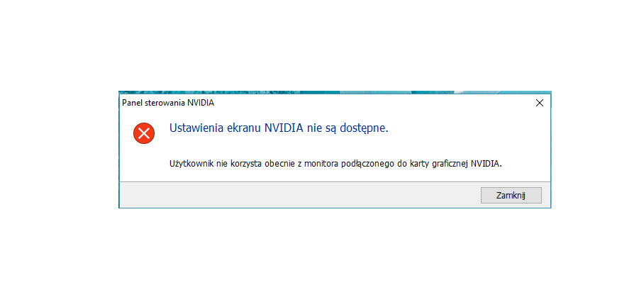

    Good morning, I have a new desktop computer with two graphics cards for a long time, the first is Intel Hd graphics 530 and Nvidia GeForce gtx 1050. When I try to open the Nvidia control panel, I get an error that informs me that the monitor is not connected to this graphics card . The monitor brand is LG IPS FULLHD. I hope I can find help. Thank you in advance.

    What cable do you have connected to the monitor? Provide the exact monitor model. Show this error.

    Connect the monitor to the nVidia card, not to the integrated Intel card.
    The monitor is connected with a D-SUB cable.
    Monitor model: LG 22MP48D-P

    Then connect the monitor to GTX.
    You must use a DVI or HDMI cable.
    What exactly is the monitor model?

    The GTX1050 does not have a DSUB output, so you connect to an integrated Intel card, and you don't use NVIDIA. You need a DVI-D DVI-D or HDMI DVI-D cable. Connect this cable to the GTX 1050 card, not to the integrated one (it's a completely different set of sockets).

    Thanks for the answers I just ordered the cable.
