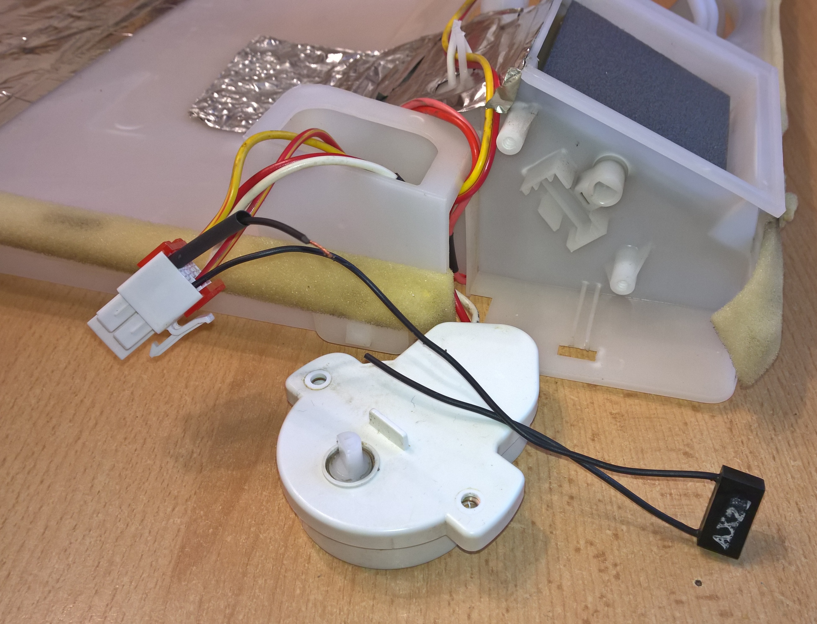

    A colleague works well. There is probably a damaged reed switch, a small glass tube. When rotating the flap, the magnet should shorten or open the contacts. If the module does not receive a signal from the reed switch, an error is shown.

    With stubbornness and determination, everything can be repaired, I disassembled the plastic casing where the fan is located and the flap with the motor and reed switch. There is a magnet on the axis of the flap and a contractton is located nearby, which is the spiritus movens of the whole problem, because the contraction does not react to a similar magnet. Summing up, it is he who causes the flap to not be able to set properly and thus the control electronics does not receive the correct signal to start the aggregate. I have already ordered a contract with the cabling, which comes complete as standard. Below, I will place a photo documentation of the entire disassembly process in order to replace the contract. Samsung SR-L39WEB Fridge Breakdown, Error Code RD, Defrosting Issue, Throttle Flap & Service Manual
    Samsung SR-L39WEB Fridge Breakdown, Error Code RD, Defrosting Issue, Throttle Flap & Service Manual Samsung SR-L39WEB Fridge Breakdown, Error Code RD, Defrosting Issue, Throttle Flap & Service Manual Samsung SR-L39WEB Fridge Breakdown, Error Code RD, Defrosting Issue, Throttle Flap & Service Manual Samsung SR-L39WEB Fridge Breakdown, Error Code RD, Defrosting Issue, Throttle Flap & Service Manual Samsung SR-L39WEB Fridge Breakdown, Error Code RD, Defrosting Issue, Throttle Flap & Service Manual Samsung SR-L39WEB Fridge Breakdown, Error Code RD, Defrosting Issue, Throttle Flap & Service Manual Samsung SR-L39WEB Fridge Breakdown, Error Code RD, Defrosting Issue, Throttle Flap & Service Manual
    Below I present the image and catalog name of the ordered contract. As soon as I receive the ordered item, I will of course put the whole thing together and will test the contractor with the help of a multimeter and notify you about the success of the repair, which will probably be. I worked a bit on the documentation of this topic, so if someone will find it useful and I think it is for sure because I have not seen such a description of this defect anywhere in this model of refrigerator, please click that I helped someone. I will also try to document the final stage of repair with a description.

    Today, on 13/01/2017, I received the ordered contract from http://www.mkservice.pl/ generally, quite nice and decent service.
    I did not want to play with this new cube because I would have to remove the old cube from the new set, so I cut off only the contractton itself from the new set and soldered it to the old harness, it was the fastest solution because the fridge is needed and everything melts around me. It's a bit of fun to attach those plastic pieces that make up these air channels. In addition, I also replaced the sponge gaskets due to the fact that the original ones were very flattened, no wonder they worked there for over 10 years. Now I tightened all the fixing screws, and the end, a moment of uncertainty, I turn on the fridge and wait 30 seconds, the fridge works, after a minute the fridge continues to work normally, and then suddenly after about 3 minutes it happened what I expected, I just succeeded, the fridge works like new. I think I will report to Samsung and set up an authorized Samsung service.
