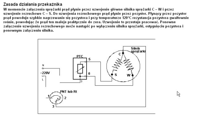

    And from the aggregate side, as it looks, there is usually a capacitor. The unit (compressor) when it turns on, usually after turning it off, it must cool down, there is a tablet ( posistor ) which does not cool down until the knock, the generator will not restart.
    Samsung RB31FERNDBC refrigerator - the display is blinking, it does not cool.
    There is no simplified diagram on the back of the refrigerator, sometimes the manufacturer sticks it. But anyway, I would look for a Samsung service, they have access to such information ... But these ordinary household appliances services may also have access, probably after buying a license to the Samsung technical specification ... It's better not to rummage there yourself, especially if there is so much electronics stuck.

    There is a BLDC motor. There is no posistor.
