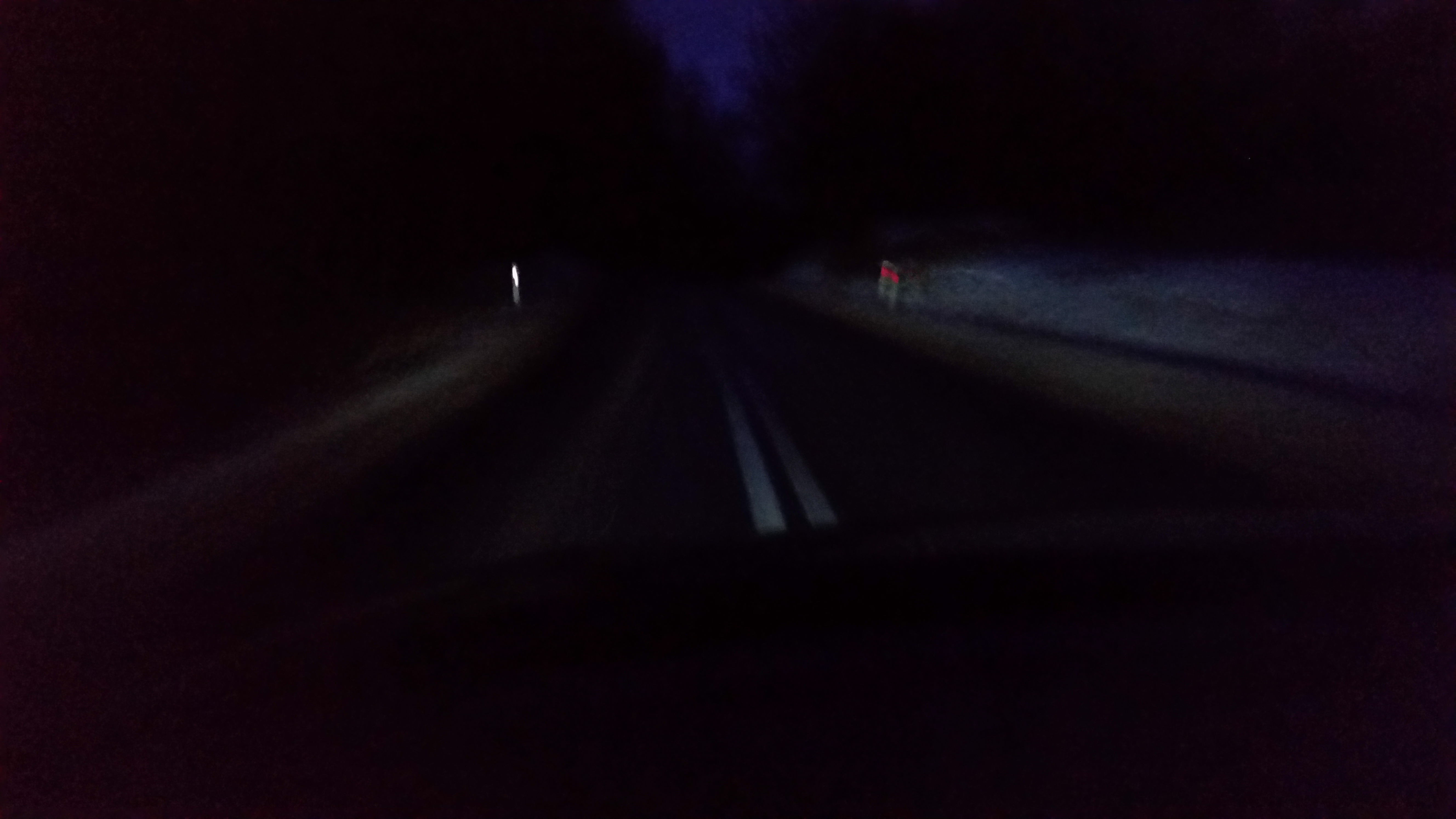

    Hello. I am curious what will happen when I touch the xenon bulb with my fingers, for example, because I exchanged converters in my lagoon. And he tested whether it was them or light bulbs. And I rolled left to right and was able to touch. It's just that my light bulbs have been shining much weaker for some time. I wonder if it's the mirror's fault. Xenon. Have a plastic shade. The alternator also comes to mind because it was replaced some time ago. I am asking for advice and ideas

    I will add how they shine on the road

    A fairly simple matter, burned out reflectors and burners to be replaced with new ones.
    If the torch light source is black inside it must be replaced.

    The left side is white and the right side is white and gently goes under the green

    Impossible, the battery is invisible to the installation while the engine is running, all power comes only from the alternator.
    Secondly, xenon can be operated in a wide range of voltages, and so does the candle.
    See if your burners are burned out.

    Take a close look at the lampshade, if you can see that it is opaque, it may be blocking some light.
    The luminous flux may also decrease with the natural wear of the burner. Likewise, the color temperature can give the impression of a poor glow, and it also changes over time. I know from experience that the more blue (e.g. 6000k and higher), the visually they shine nicer, but in this light it is more difficult to distinguish details and it is less visible.
    As for the alternator, it can be excluded. Xenons have lower energy consumption than classic bulbs (usually 35W instead of 55). They only require a lot of electricity to run.

    Lamp to replace, no mirrors, glass (actually plastic) for polishing. The lamp is designed for xenon. No sprinkler. The car asks for a registration certificate.

    There is no need to be sure here, such a dim lamp itself stops half of the light. You do not have to replace the lamps at the moment, polishing at the beginning, but I suggest you do it with a clear varnish if it is to be durable. See more or less what it is about:
