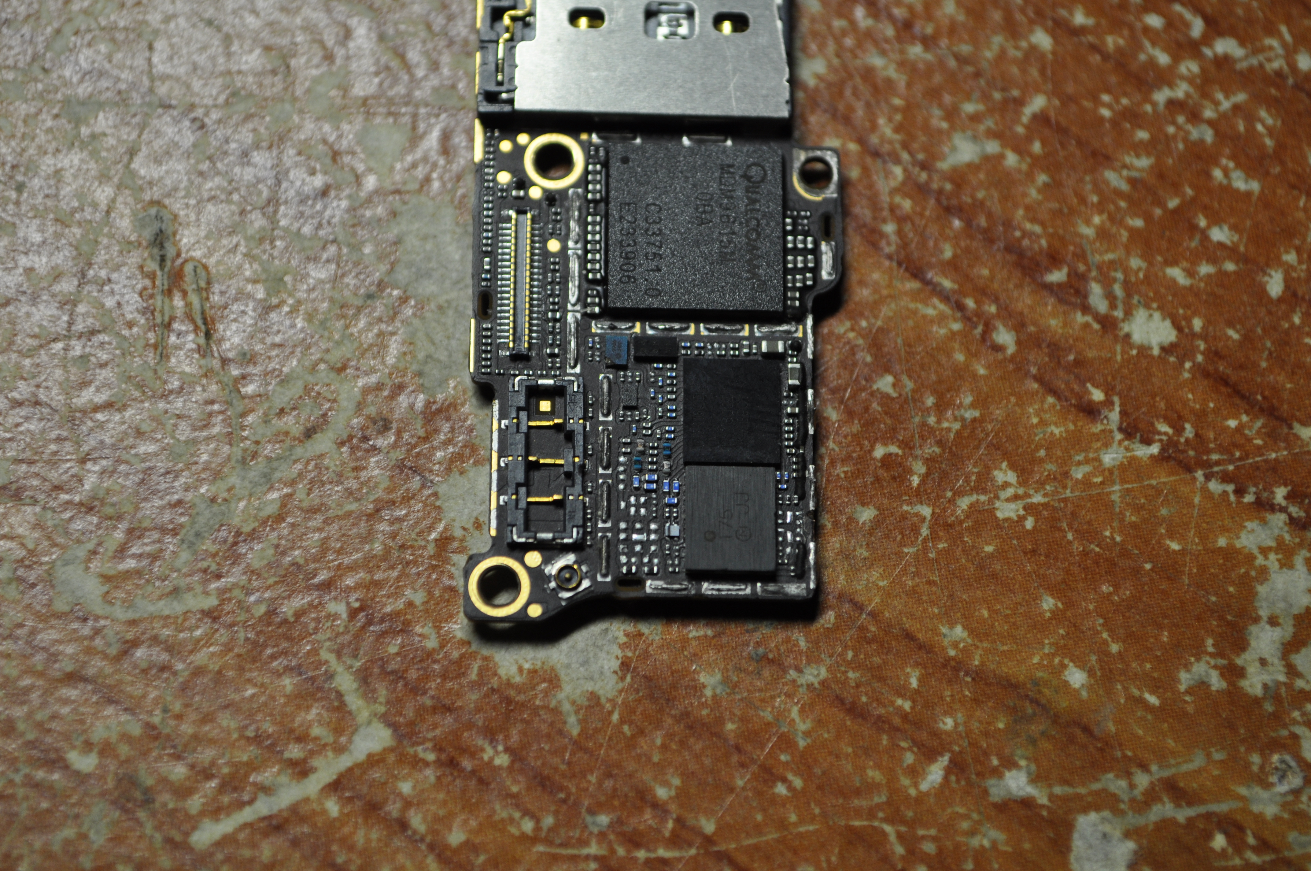

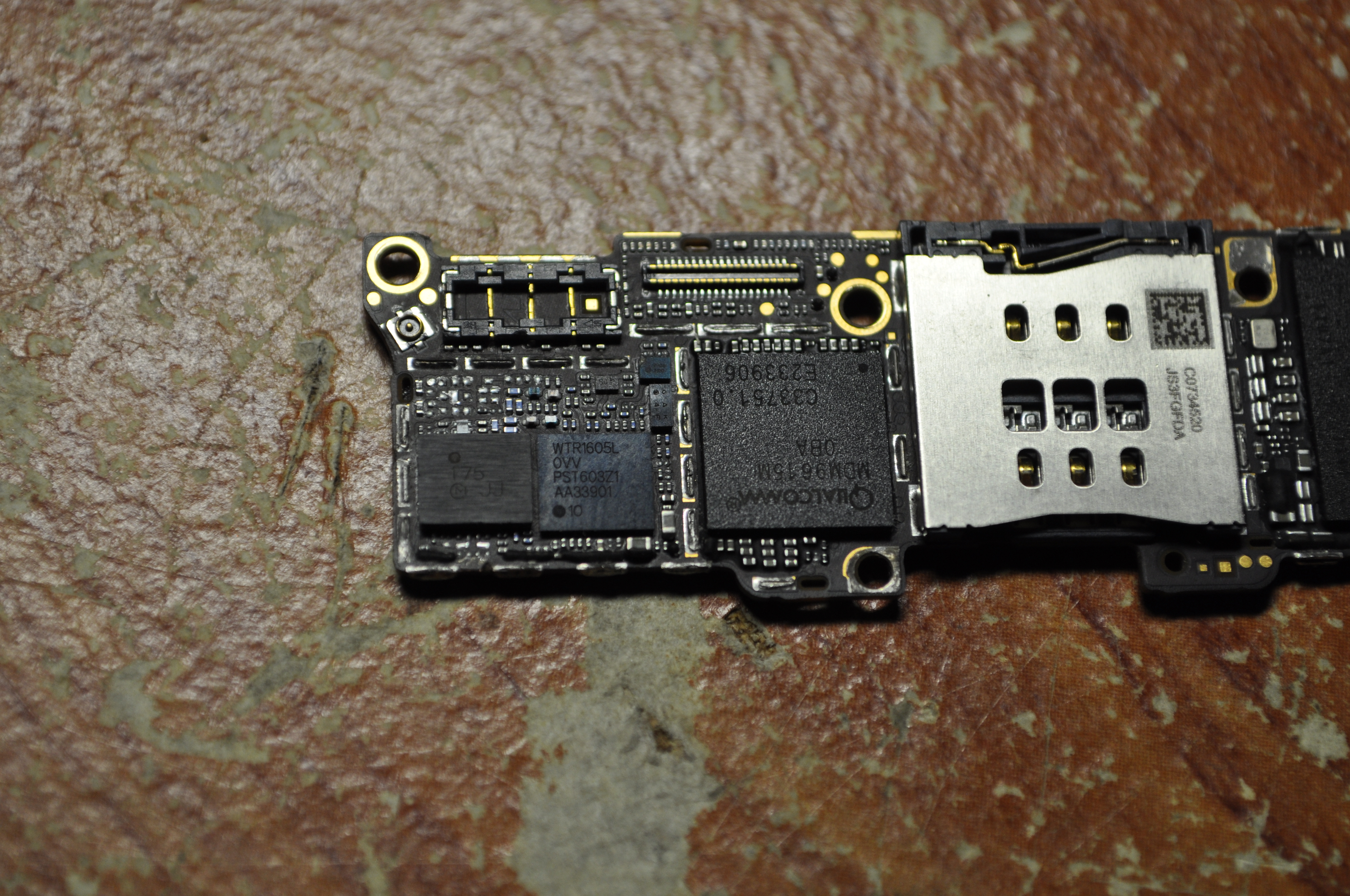

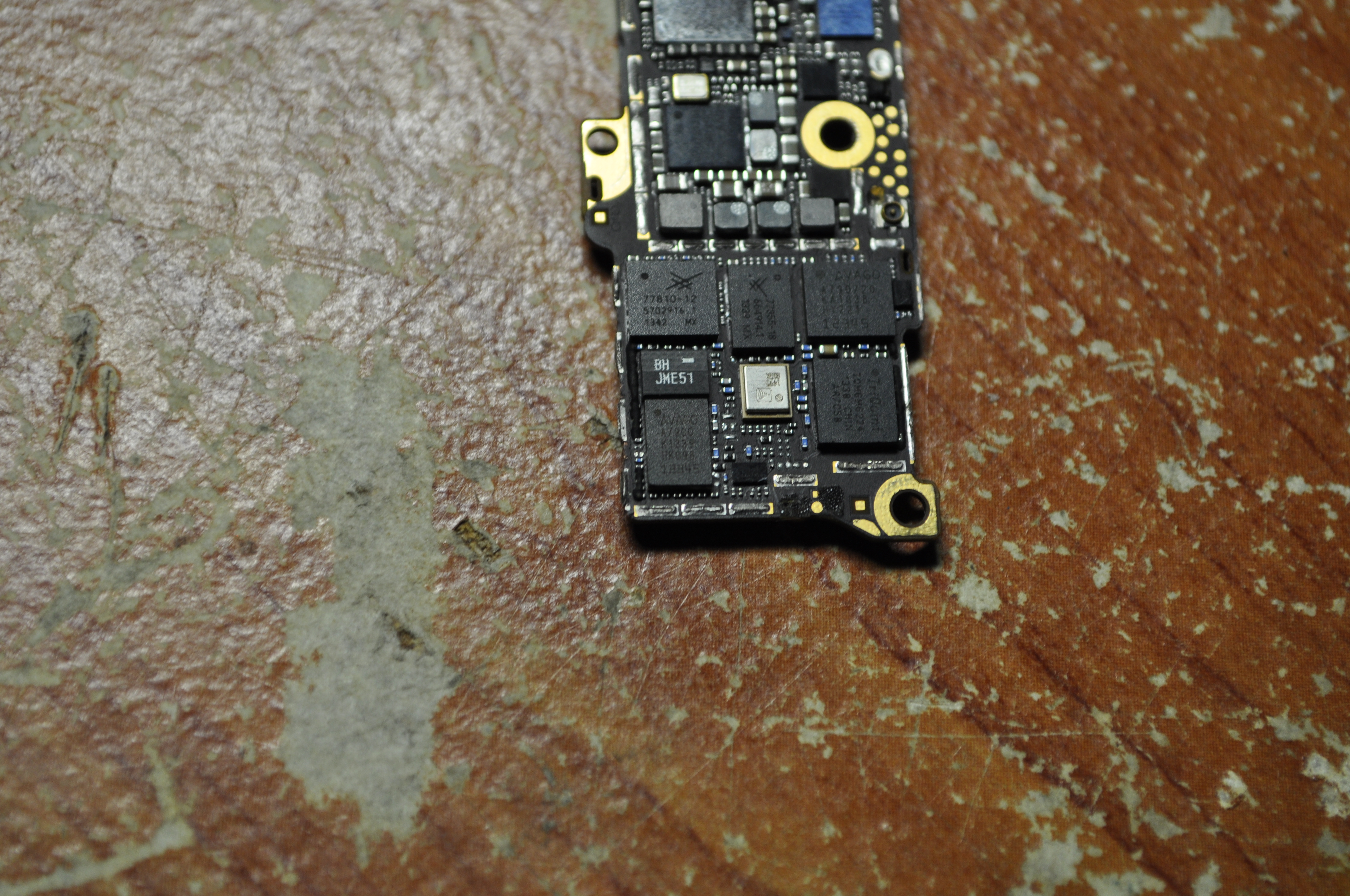

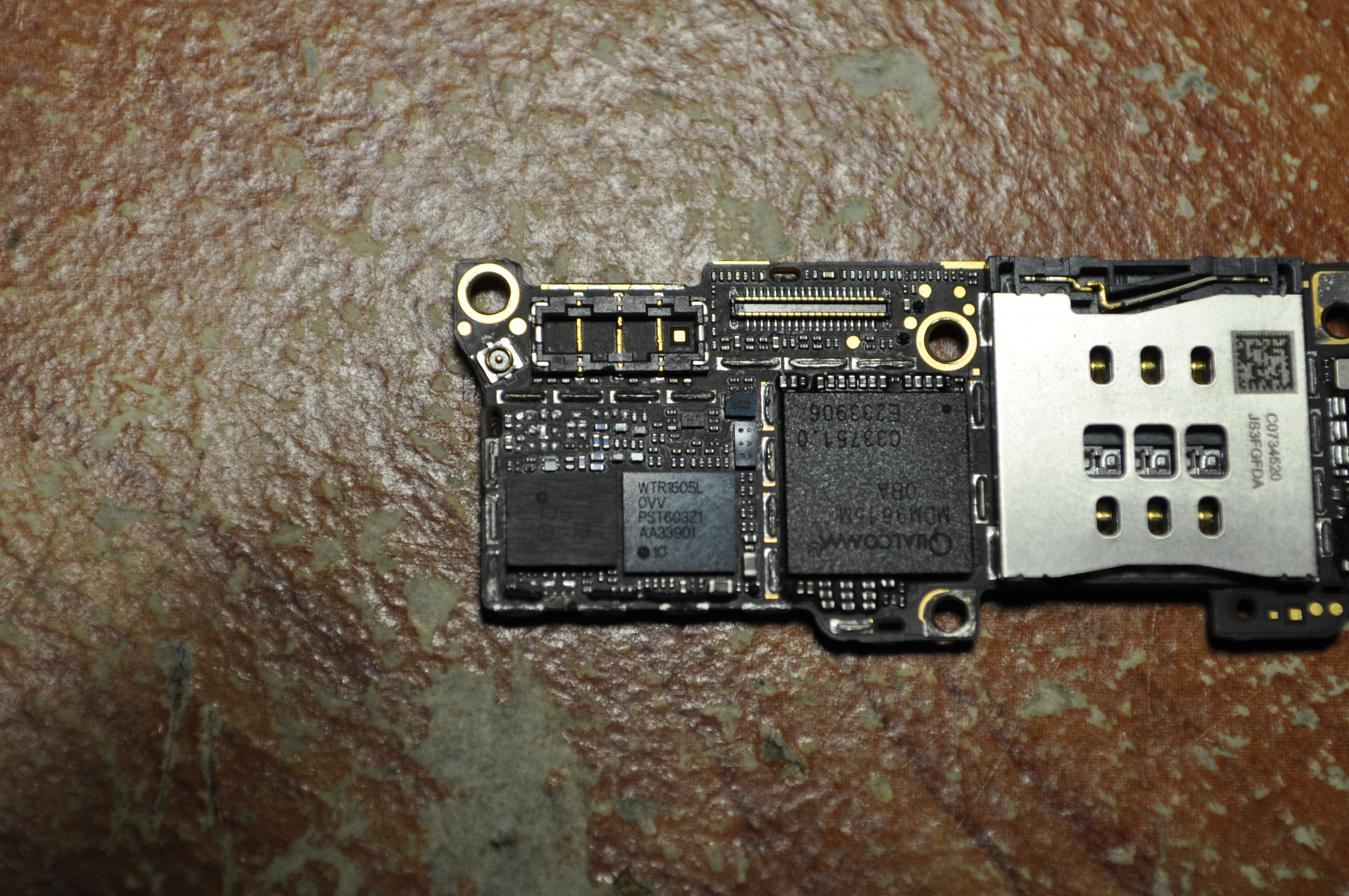

    Hello, I have a problem with the iPhone 5s, so I bought it on the Allegro as supposedly damaged, the previous owner put it back in a functional drawer, it has been left for a year and has not been turned on since then.
    I undressed it, I downloaded the screens and noticed that when it turns on the processor warms up most when it connects the charger and the display but with the disconnected charger less tel charging the batteries checked but the screen still remains black on the connected charger vibrates or makes sounds. Please help the board does not seem damaged, you can not see traces of moisture what should I first check the voltages on which and how to accurately diagnose damage to any of the system?

    U26 RF and U22 RF and U16 RF are probably missing on the board and one chip is chipped and the lcd has been replaced

  • #7 16208315
    RafalB
    Level 28  
    Posts: 1110
    Help: 91
    Rate: 222
    The absence of these systems is normal in this disc revision, the chipped system is not chipped, the last description layer (type of rubber / sticker on the silicon structure)
    Photos of low quality but this track has nothing to do with your problem.

  • #8 16208641
    smac22
    Just download the picture to zoom in and see everything
