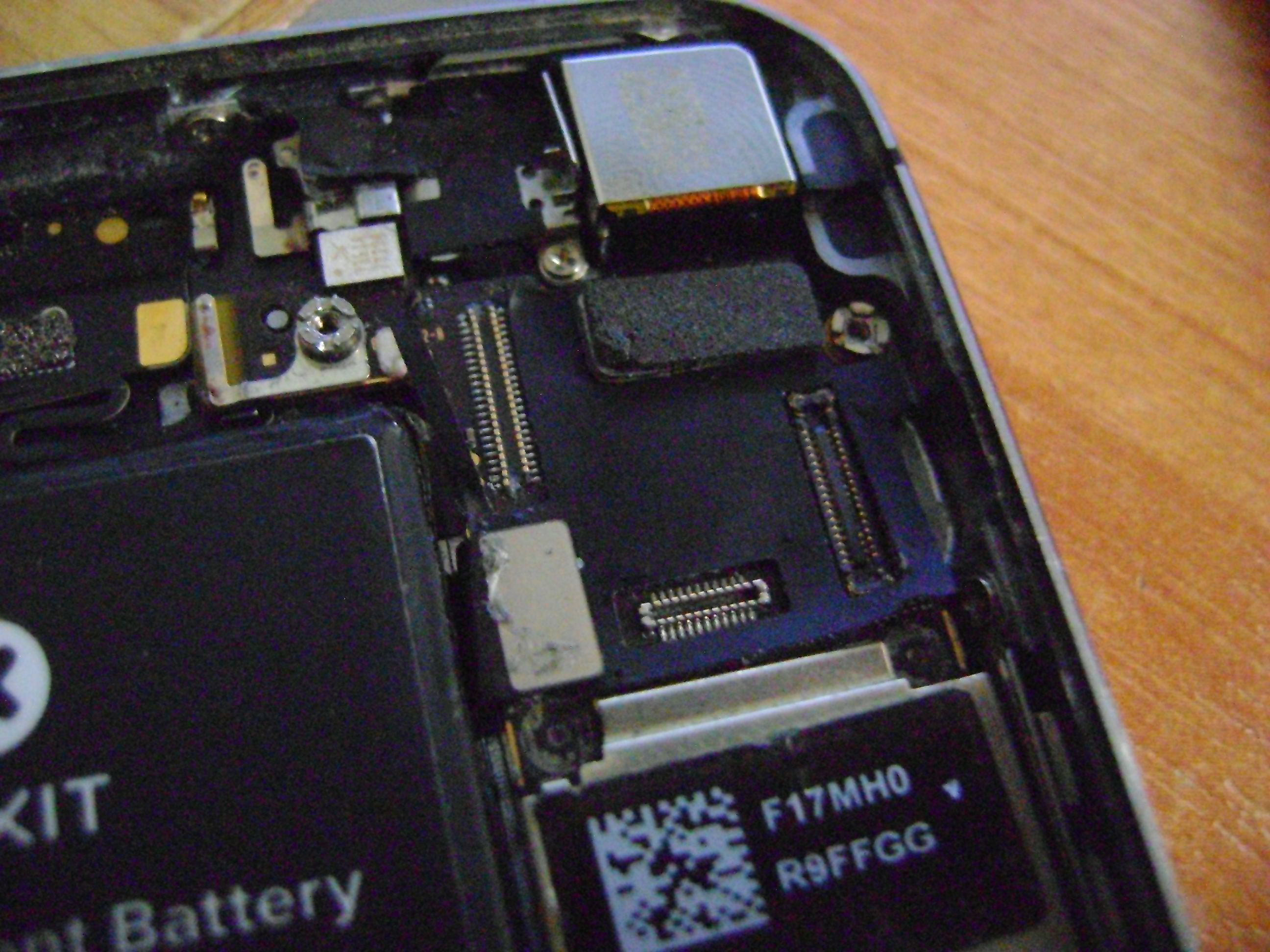

    Maybe at the beginning a brief description of the situation. Well, I bought a broken iPhone 5S for self-repair, because I had to deal with such small things, so I took a chance. The phone is generally functional, the system boots without any problems, iTunes can see it. In the purchased phone the screen was shattered, 70% black so it was not possible to check the touch, after replacing it with a new, unfortunately cheap replacement theoretically everything works except just the touch. The touch does not work over the entire surface. So far, I have downloaded the new software by DFU with the silent hope that it will help, unfortunately it did nothing. In the attachment I am sending pictures of screen tapes and disc inputs. I am afraid that the CD is the fault because the phone has a different IMEI number. plates, and another on the housing, for this has non-original batteries from iFixit from which I conclude that the entire iPhone is a cluster of several phones. However, I'm not so familiar with it, so I'm counting on some advice and tips from you.

    Pictures of poor quality but I do not like this touch connector.

    Despite the poor photos, you can see that the touch socket on the disc is broken, it needs to be replaced.
    Also verify the plug on the panel tape.

    What I wrote are only facts confirmed by experience. Trust a second phone that may not have a display for another disc or home button.
    As for photos actually enlarged as if one contact in the socket was broken.

    And as for the phone, if there is only a broken pin from the socket (and the pads on the board are whole), then replacing the socket is the most profitable.

    I looked again at the pictures and there are both sleeves ripped out, total chamois. Fight with the seller because it's a dark topic.
