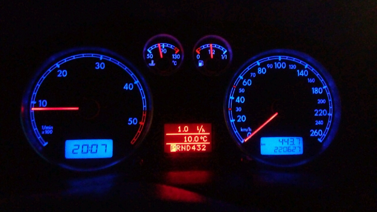

    Hello everyone. I replaced the lock in the driver's door because the light in the door and the mirror wheel did not work and the door signal was not open. Everything works except the buzzer from the lights. What could be the reason?

    It should work only from the driver's side, so as the meter sounds when you open the passenger door, it is rather a car after a spacer.
    Will this Englishman come out after VIN number?
    Check which side lights up when you turn the rear fog lamp on, left. How the laws light up will be all clear.
    Show the speedometer dial. Maybe the counter is not converted, just put another dial.

    Nothing came out after the VIN. It's just that the production plant in Germany. I checked the passenger door, only the light comes on and the light on the board. And if the buzzer didn't work, it didn't work

    European counter.

    To the grail 1. I don't make a fuss. Read carefully. A siren sounds in the clocks because a colleague was asking instead of the wort from the lights. So what do you think about this? What could be the reason yet - maybe the entire light switch to replace?

    However, you are making a fuss, there is one beacon in the clocks, there is no separate from the lights.
