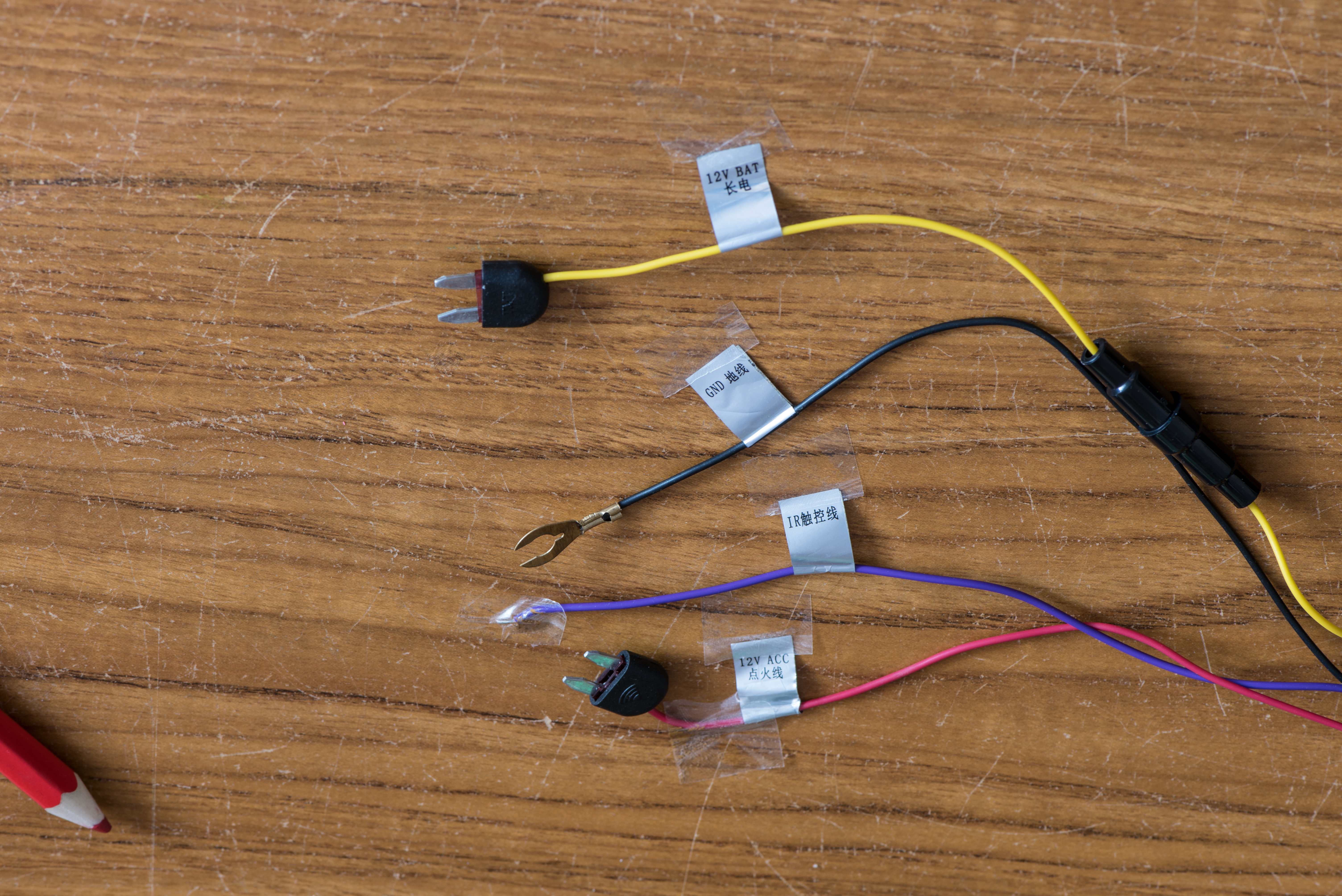

    hello I have a problem how to connect a car camera.
    http://www.ebay.co.uk/itm/160-12V-HD-1080P-Au...hograph-Kit-/162115231600?fits=Car+Make%3ABMW 7CModel 3AX5%%%% 7CPlat_Gen 3AE70 & hash = item25bed21f70: g: G50AAOSwjXRXbN0X
    I bought this webcam as it is from China, there is no understandable instructions. I have 4 cables 12V bat, GND, 12V ACC, and IR
    I guess connect a 12V bat to the plus where the electricity is all the time,
    GND is a minus / ground,
    12V ACC is a plus after turning the ignition switch,
    I don't know what to connect the cable with the IR marking to
    If I made a mistake, let me know and correct me. Can I handle it all from the fuse box? and maybe it's better to take 12V ACC and GND from the lighter (if I turn the ignition switch then there is voltage)
    Thank you for your help

    From the link you gave the cable markings as in the photo below.
    Connecting 160 12V HD 1080P Autos Mini Hidden WIFI Video Recorder: Wiring BMW X5 E70 with 4 Cables It has nothing to do with what you wrote, IR would be infrared :D

    Maybe it's IR for connecting infrared lighting at night.

    Judging by the view of the webcam rather not :D

    Well, I saw the pictures but what happened to me has one more cable. Photos probably put one of the cams and used for several auctions. Eg the photo is Honda and I bought it for BMW.

    So don't plug it in and check the operation.

    More I meant that this cable can give a signal to control additional IR lighting as it is too dark, but you would have to check it in practice because all the images of the cables that this camera has only 3 wires.

    This camera does not have such lighting, so you would have to buy and install an additional device

    Give the picture in good quality this manual you have.

    Today, I tried to take a camera and cycle quite a sharp photo - sorrka those photos which I had previously inserted from the phone sucked nothing can be seen on them.
    I don't have any instructions, that's why I'm writing here, so I would know. On Saturday I will probably try to connect it and see if it works without this IR cable. I have written to the seller and I hope he will write something back.

    According to the inscription ?? ? on the label it is for the touch panel: /

    I searched Google a bit and the only thing I can say is that this cable is probably triggered by a camera signal from some impact sensor or motion detector.
