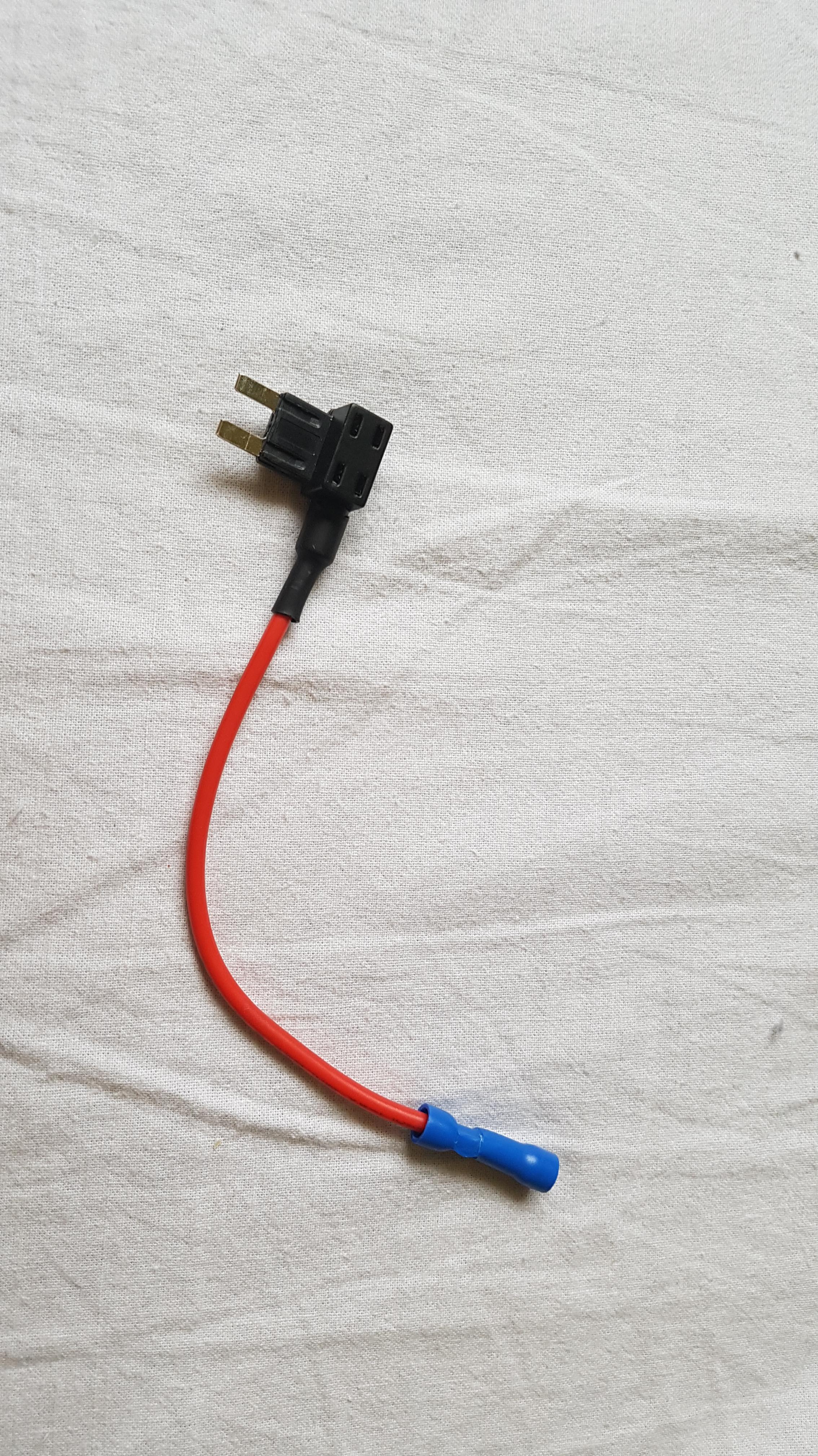

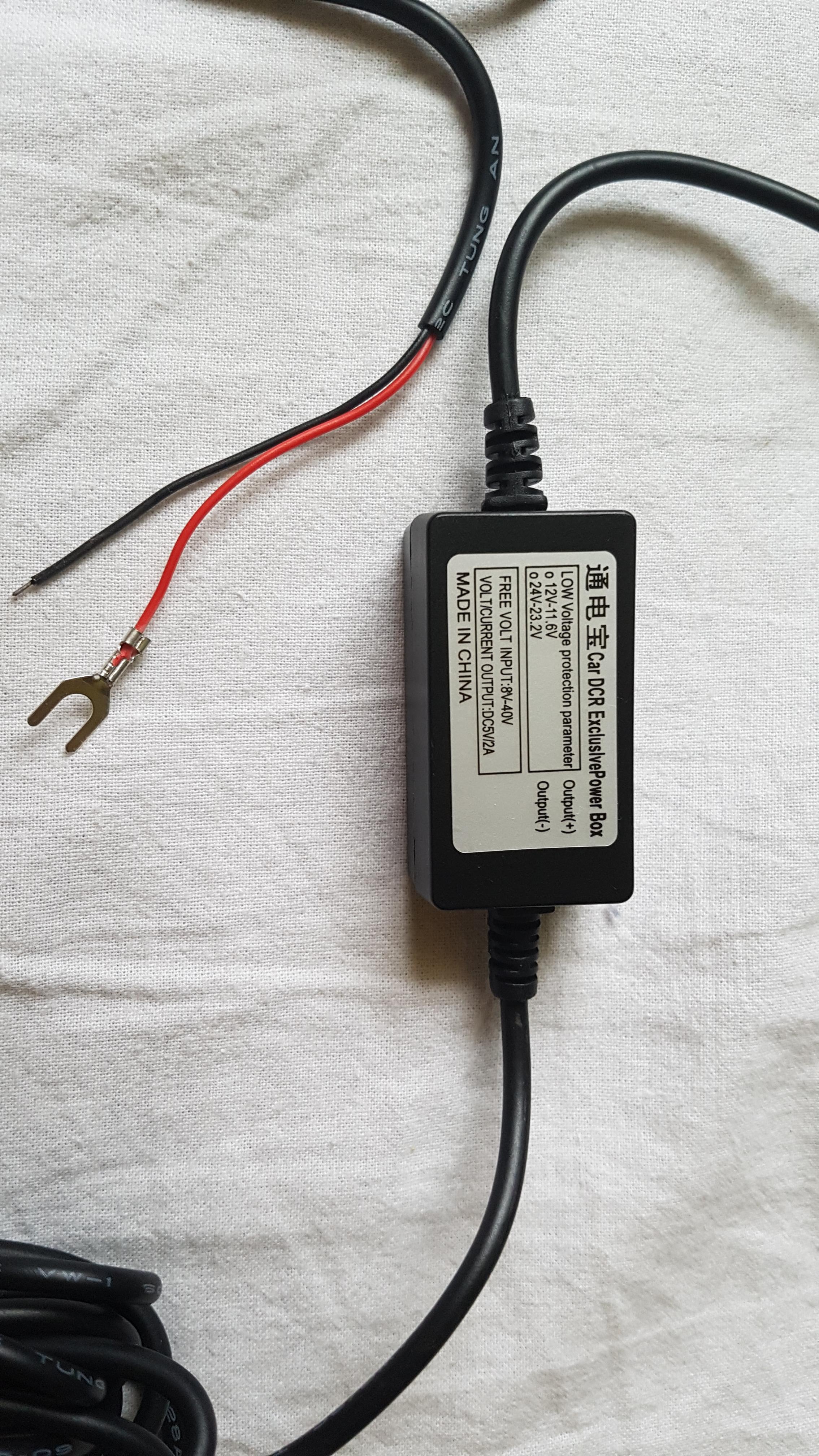

    I purchased Viofo video recorder. I would like to connect it permanently to the car. I got to the fuse baypass kit and some adapter, which changes the voltage from 12v to 5v and protects the battery against discharging (everything in the pictures) now how do you connect everything to get your hands and feet?
    The car is BMW e60.

    Black to ground, red to be connected to the adapter (bypass) and plugged into the fuse compartment in one of the terminals (30 - if it is to be powered without interruption, if it is to be powered from the ignition), and the fuse is connected to the adapter.
    So I have to attach to fuse No. 30 if I do?
    For me, this fuse is from the action of ABS
    #4 17053472
    DriverMSG
    Posts: 44094
    Help: 3984
    Rate: 4870
    No. 30 is the popular name of cables in the car connected directly to the battery. With a lamp / lamp, check which fuse is under voltage with the ignition off.

    DriverMSG wrote:
    30 - if it is to be supplied without interruption, if it is to be powered after the ignition switch
    Markings 15, 30, ... do not concern the numbering of fuses, they are designations of the installation according to DIN 72552

    krycha03bs
    Posts: 7
    Okay, as I understand it. So I have a fuse from a telephone that has a voltage without a key. So, here I can do it? Is there any vacancy?
    Forgive my stupid questions, but I prefer to ask twice than regret especially that the BMW electronics are more delicate than the egg.
    #7 17053676
    DriverMSG
    Posts: 44094
    Help: 3984
    Rate: 4870
    Yes.
