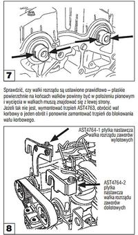

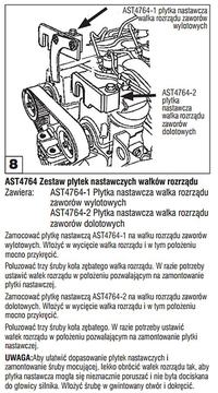

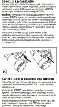

    Hello gentlemen!
    I have a problem with setting the timing in Renault Master II 2.5DCI 120 2006. The timing belt was broken, everything has been done but I can`t set it. Can someone give me some photos/tips on how to set it up? I can`t find any points. I set the small notch up on the shafts and the piston in the upper position, nothing sticks, but the car won`t start. You can hear it turning slower.
    Please help.

    Here is the replacement diagram.

    Buddy, it`s best to buy locks, I paid about PLN 200 for all of them and you have a dci for each. As for the setting: you can make the shaft lock yourself, because it is an ordinary pin (you screw in the screw from the block near the base of the oil filter and insert it into the block, thus locking the flywheel. The timing gears have notches (on the timing side, right behind the wheel, there is a notch like using a flat spanner), the cuts should be vertical. If necessary, I can send you the locks with dimensions and you can make them yourself, as I don`t have such an engine in my workshop.

    Instruction.

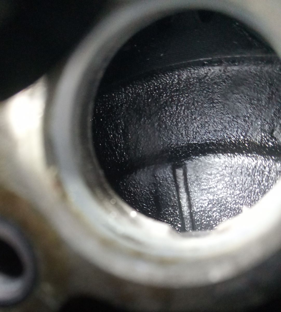

    Can anyone tell me how to properly set the crankshaft? If you cannot unscrew the screw to insert the lock, the screw head is so loose that the socket wrench 13 slips off, and there is no access to do anything with it. The shaft is set more or less correctly, there is no mark on the pulley, how to check if it is perfect? Maybe the crankshaft position sensor can be used somehow.
  • #17 20942348
    milejow
    Posts: 13098
    Help: 1563
    Rate: 5149
    techlock wrote:
    if you cannot unscrew the screw to insert the lock, the screw head is so loose that the socket wrench 13 slips and access is impossible
    Access is difficult, but it is there, from the bottom, you need to weld on the nut and unscrew the screw. However, if there is not enough space, it remains to dismantle the front of the car, then the gap becomes exemplary

    If there was access, you could insert a 12-gauge socket or a star, but there is no room to use a hammer or anything, so you can forget about welding. There is no point in dismantling the entire front, air conditioning radiator, etc., it's too much work. I asked about another way bypassing this block.

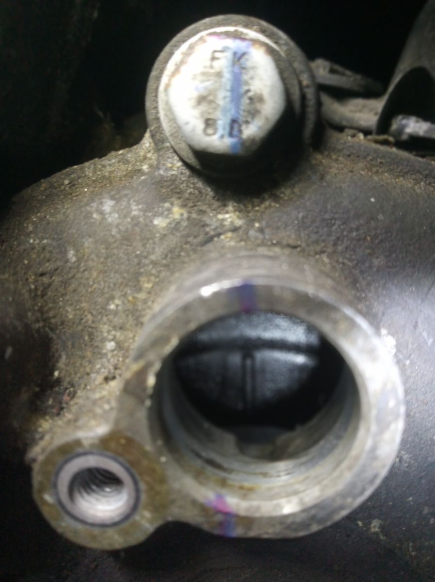

  • Injection pump sensor mark used for TDC reference
    #20 20942591
    techlock
    Posts: 2032
    Help: 218
    Rate: 527
    Image of the engine mechanism interior with a clear marker.
    milejow wrote:
    Don`t tell me fairy tales, because I`m too old
    I was counting on a constructive answer. The engine in Espace 3, there is no room there, it is not Master. You had to ask what car.
    After removing the injection pump sensor, you can see a mark (a sprue, a short line), but there is no reference point where the TDC is (in the middle of the sensor?). It`s faster to unscrew the sensor than to disassemble the entire front.

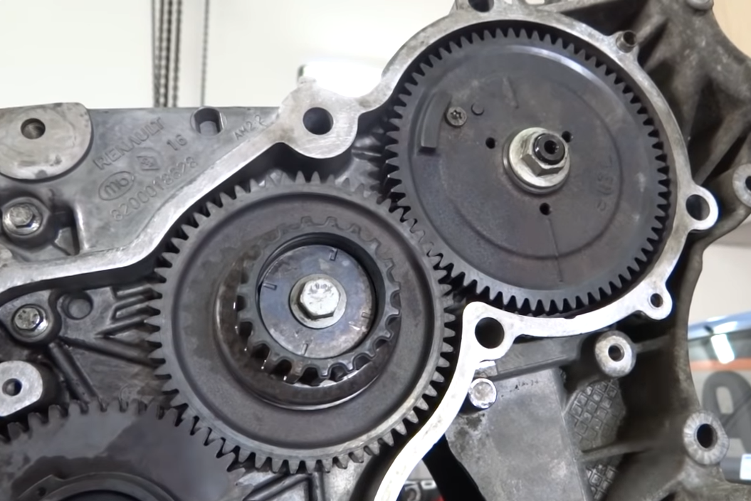

  • Injection pump gear mark identifies exact TDC
    #22 20942796
    techlock
    Posts: 2032
    Help: 218
    Rate: 527
    milejow wrote:
    Well... sorry, I'll ask next time
    Sarcasm is unnecessary. Specifics or better not to write anything. I have already determined that the mark in the injection pump sensor hole should be exactly in the center of the hole, in line with the upper cover bolt. This is exactly TDC and you don't have to mess with the shaft lock screw. And here I will use sarcasm: Some old people prefer to weld or dismantle the entire front, and it doesn't hurt to think about it

    If anyone needs it
    Close-up of engine injection pump gears with visible alignment markings.
    TDC based on the injection pump gear mark.
    View of the injection pump sensor opening with a visible marker.
