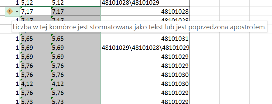

    When importing data, some of them formatted after import are as text .
    There is no apostrophe there , a after double clicking on the cell, its content is shifted to the left and turns into a number .
    Or I can click on that exclamation point and choose convert to number. It has the same effect . (i.e. the number is converted )
    VBA Excel - "The number in this cell is formatted as text"
    Does anyone know how you can get such an effect from VBA?
    * I tried to record this convert but the recorder does not record anything only "select range".
    * I checked too formatting, is "numeric" (0.00)

    What decimal separator in the system?
    Try to change the sheet "," to "."

    Please this is a fragment of the source file
    • test.xls (717 Bytes) You must be logged in to download this attachment.

    Andie wrote:
    sample file you want to import
    It's not the source one, it's already imported. I think they are imported from text, this one interests us.
    To the word in tom test.xls I see all excel values as numbers
  • #8 16215181
    karola0921
    Posts: 45
    This is source.
    The file is saved by a proprietary program. It is a txt file but saved with the ".xls" extension due to a program error.
    How will you use the open
    Code: VBScript
    and then you copy the range to another file via VBA\ ("range.copy \\\ pastespecial")
    it will be the same effect as in the picture in the first post.

    Right. text. At me excel opens it correctly, all as numbers,
    copies and paste xlValues the same correct (numbers)
    karola0921 wrote:
    range to another file by VBA \ ("range.copy \\\ pastespecial
    Perhaps in another file a text format (cells where pastespecial)?

    If the cells on your worksheet are in General format then what you tried should work:
    Code: VB.net
    The period is the decimal separator in VBA, and Excel converts this automatically to numbers in local format.

    You can also multiply anything by 1
    = A1 * 1
