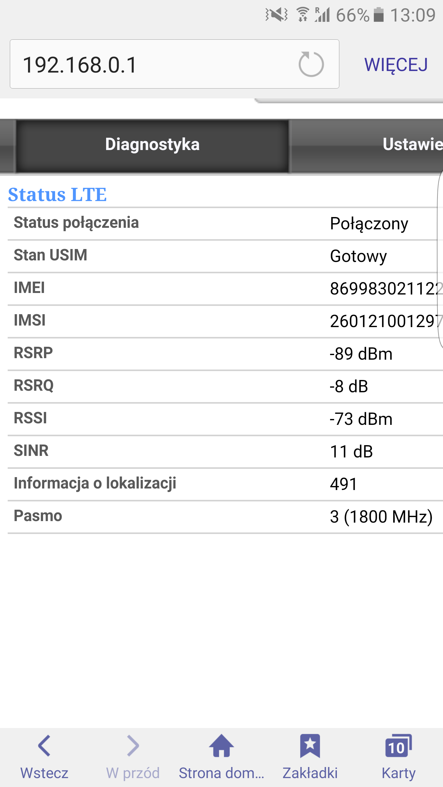

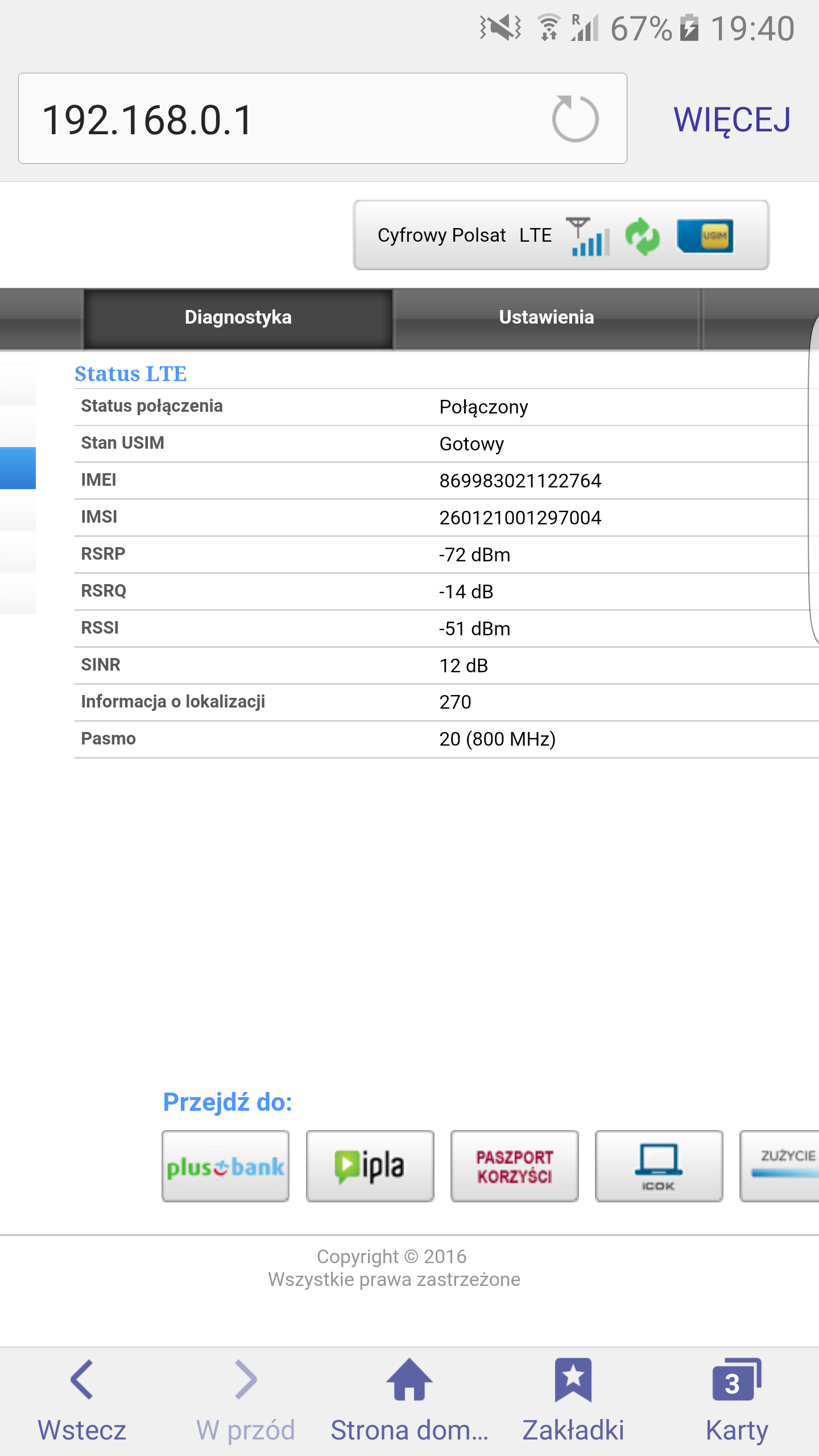

    Hello, I have a problem because I recently bought an id from digital polsat, internet smiga 50MB / S. The problem is that for some time the external antenna as if it lost power, which turns off and loses the signal. The signal normally is 4/5 strokes range LTE. As I wrote above, the download reaches 50MB / s and sends about 45MB / s. The set was exchanged but it did not help. The cable is 75 ohms. My place of residence is cerekwica 62-090. Help, what may be the problem? Please help.
    • Odu idu 200 plus: External Antenna Power Loss in Cerekwica, 62-090 - Possible Causes? Screenshot_20170120-130913.png (189.49 KB) You must be logged in to download this attachment.
    • Odu idu 200 plus: External Antenna Power Loss in Cerekwica, 62-090 - Possible Causes? Screenshot_20170120-194002.png (239.81 KB) You must be logged in to download this attachment.

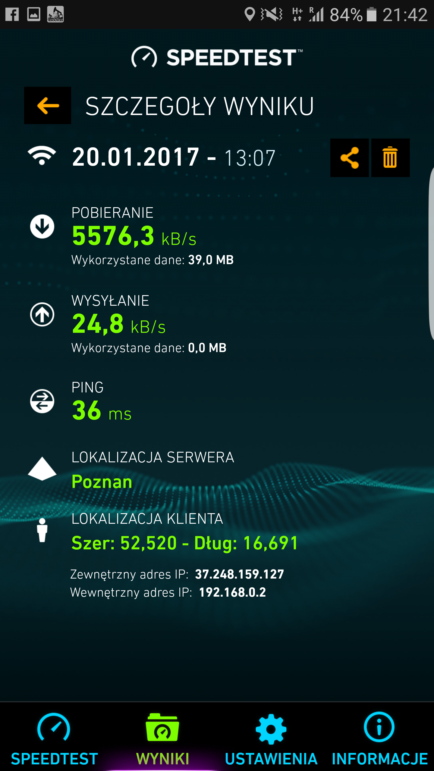

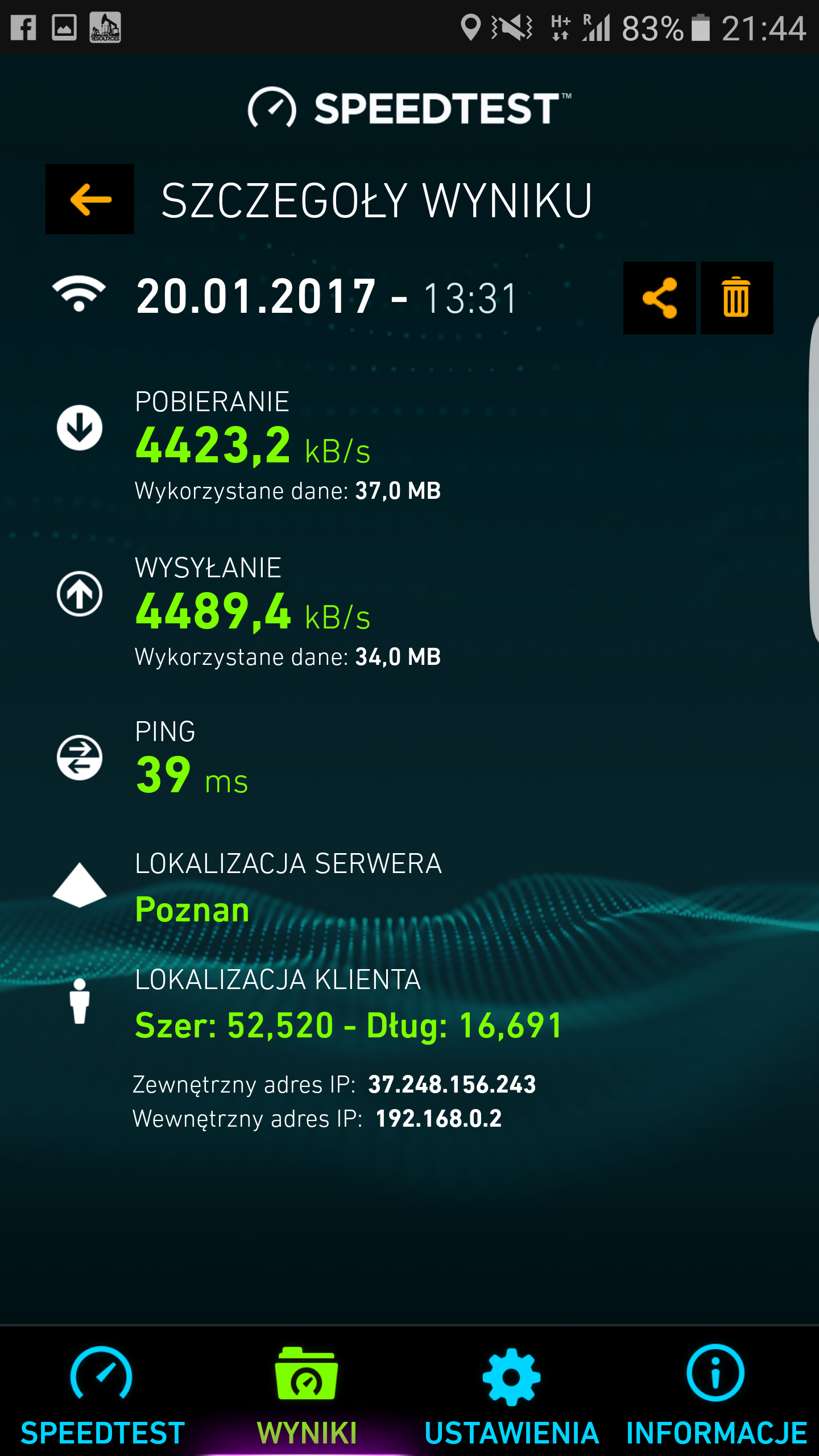

    Why did you take shit instead of decent equipment with LTE bandwidth aggregation? Advertise this invention to the effect. In your area Plus has a permit for LTE1800 Aero2 and LTE800sferii at Poznan 11. It works for sure LTE800, LTE1800Aero2 you need to check on your phone with LTE. In Rokietnica at Rolna 41 both permits operate. parameters on LTE800 as good but those corresponding to some RSRQ and SINR for such a close BTS poor (how much do you have to Poznan 11? 0) But this is normal because ODU has a tragic omnidirectional antenna. On LTE1800, a little worse. Of course, speeds up to 50Mb / s, on LTE1800, but at what time? Show screen from spedtest from that time. Is it also breaking the connection with BTS on LTE800?

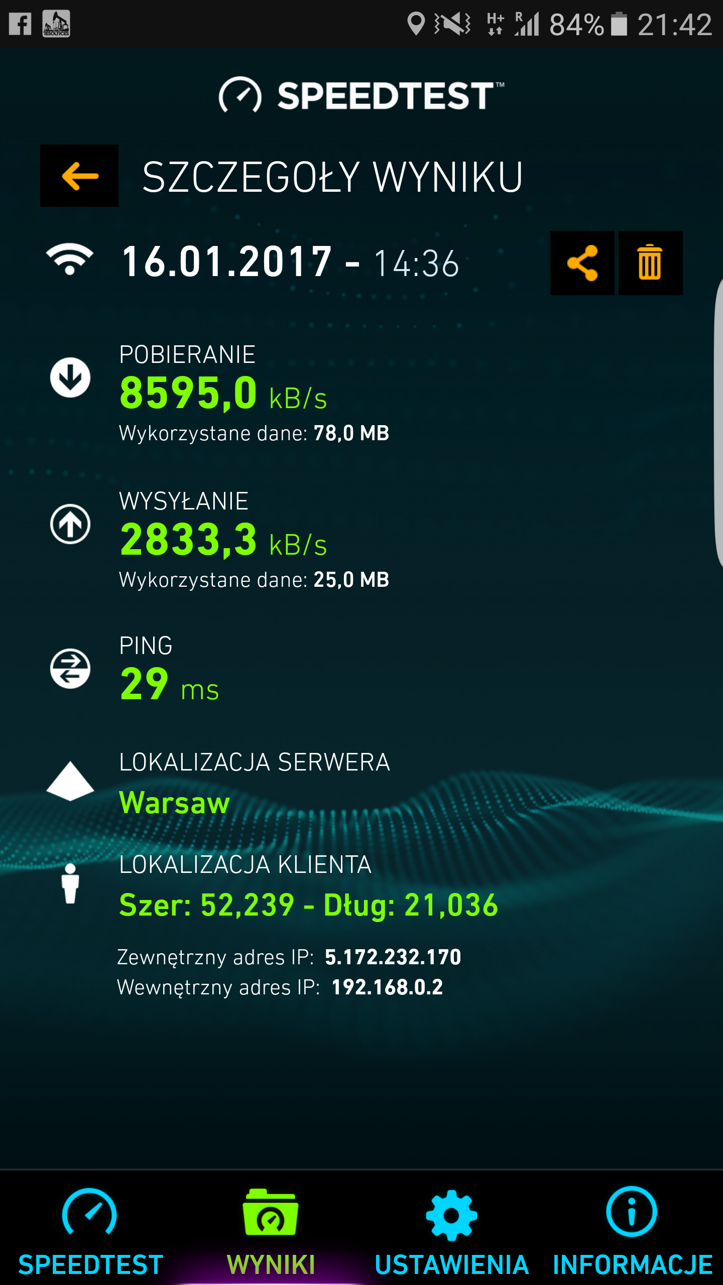

    He breaks up and I do not know why. Could you please check what it paid to take instead idu odu? Because I have convinced myself that I will be able to terminate the deal tomorrow. Edit. I attach speed test screenshots to 1800. The street where I live is the priest Jakub Przewoźny 9
    • Odu idu 200 plus: External Antenna Power Loss in Cerekwica, 62-090 - Possible Causes? Screenshot_20170120-214423.png (940.86 KB) You must be logged in to download this attachment.
    • Odu idu 200 plus: External Antenna Power Loss in Cerekwica, 62-090 - Possible Causes? Screenshot_20170120-214217.png (939.92 KB) You must be logged in to download this attachment.
    • Odu idu 200 plus: External Antenna Power Loss in Cerekwica, 62-090 - Possible Causes? Screenshot_20170120-214208.png (947.29 KB) You must be logged in to download this attachment.

    And why exactly CP / Plus? You have LTE coverage for all operators. In CP, the equipment is leased and expensive. Cheaper and privately owned equipment in Plus. Choosing the internet from CP is stupid all the more with IDU-ODU200. As already in SmartDom, it is from Plus, for example 50GB for 25 PLN + installment for equipment or E5186 in the amount of 23 PLN. Without Smartdom, the offer is completely unprofitable. in Orange, coverage from BTS-LTE1800NetWorks and LTE800 Orange Rokietnica, Rolna 41 (should work LTE-A) or from BTS-LTE800 Orange Rokietnica, Topolowa 6. LTE Internet offer for home for 59.90 from MF286 for 0 PLN. It's a router with LTE-A. In T-Mobile range, like Orange from Rolna 41 for LTE1800netWorks and LTE800 T-Mobile (it should also be LTE-A). In addition, in Cerekwica BTS LTE800T-Mobile. offer in T-Mobile worse and more expensive for 79.90 and B525 from LTE-A. In Play on BTS - Rokietnica, Rolna 39, all LTE bands operate, ie LTE2600, LTE1800, LTE2100 and LTE800. LTE-A works even with three bands. in the subscription for 69.99 the best router on the market, i.e. B618 for PLN 99. but in play LTE internet without limit, no subscription can be for 5 PLN / month. Equipment or router / modem you buy alone. You also have to count on the purchase of a call antenna for selected bandwidths, varying depending on the choice of LTE band and operator. You did not write how it works in Plus LTE1800 in the evenings, at the time of internet peak, speed?

    But these are tests from 13-14. In addition, on one very low UL. You can see that everything is unstable, but it is due to the ODU. These specialists spoke nonsense, you have 500m to the BTS. A router even inside the home on the LTE1800 would have no problem with signal stability. Unless LTE1800Aero2 is from Rokietnica and LTE1800 aero2 in Cerekwica does not work. you would need to check on LTE phone with the network Cell Info application. It will show LTE signal parameters and BTS data. The most profitable is LTE in Play without subscription and equipment. unlimited internet is 5 PLN / mo. Subscription actually in Orange 59.90 for LTE Internet for home with MF286 for 0 PLN. The LTE-A router itself is worth PLN 500-600.
