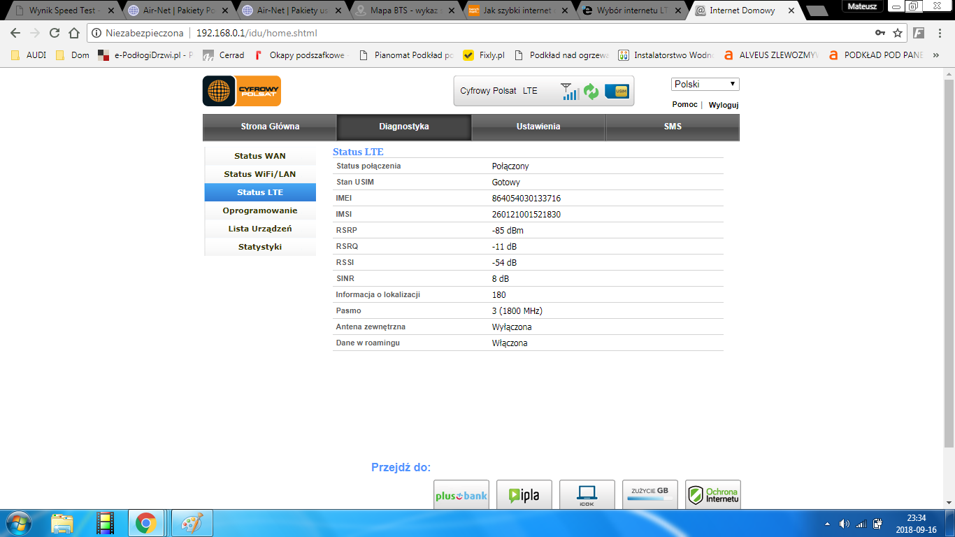

    mateuszLFC92
    Hello. I have changed my place of residence and I am looking for the internet. I am mainly focused on mobile. I took the IDU ODU 300 from Plus for testing. Speed = Defeat about 6Mb / s
    Location Nieczasowo, Żukowo commune. Do you have any other suggestions? Another operator?
    I changed the bandwidth, almost no change. It displays good signal quality on an external modem. ODU IDU 300 Low Speed Issues: Alternative Operators & Solutions in Nieczasowo, Żukowo Commune ODU IDU 300 Low Speed Issues: Alternative Operators & Solutions in Nieczasowo, Żukowo Commune

    matek451
    Posts: 31254
    Help: 4352
    Rate: 5808
    Have you checked the LTE900 Plus by selecting it on the IDU? Now you have good signal parameters on the ODU-300 with LTE1800Aero2 but BTS is probably overloaded. Show DL / UL for LTE1800 and LTE800, plus signal parameters on LTE900. Also check ECI, eNB BTS in the Network Cell Info application installed on the LTE phone with a Plus card. The DATA tab will identify the BTS you are using. Test on the phone outside. In Nieprzów Plus it has licenses for LTE1800Aero2 and LTE900 Plus.
