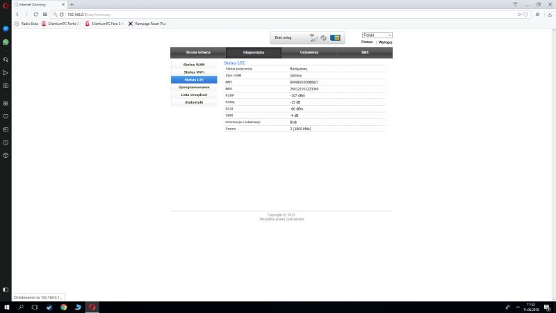

  • #10 17515482
    rycek87
    Posts: 20
    Rate: 15
    Odu Idu 200 Connection Issues with Odu LTE at 1800 MHz: Solutions for Internet Disconnection
    speed test and dump from lte diagnostics
    what to change these bets .... I have no idea how to do it ;)

    #11 17515977
    matek451
    Posts: 31254
    Help: 4352
    Rate: 5808
    Speed is some misunderstanding, you never got a funnel under FUP? Signal parameters on LTE1800 aero2 are correct, it's difficult to say from which BTS Plus this signal is. PCI shown (location information) 187 will identify it. To do this, go to the BTS in Pszczółki, Miłwiedzia and Sobowidz. set to the direction of Rębielcz. For testing, use the LTE Android phone with the Network cell Info Lite application (from the Google store) and the Plus card in it. Do tests, show the DATA tab from this app under each and DL / UL speedtest results from under each. NCI will show eNB, ECI BTS, a band, signal parmetry and PCi. After the PCI comparison it will be known which ODU is using. Checked speeds will let you check how Plus LTE1800 Plus works from each of these BTSs and which will provide you with the best speeds. A 1800MHz directional antenna can force a connection to it. There is no other way.
