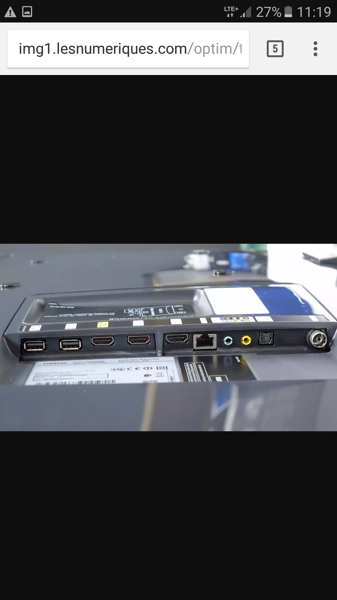

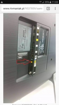

    Hello, I did not want to create a new topic, and I have a similar problem. All in all, I want to make sure that I understand your advice.
    I am interested in buying a Samsung K5600 TV, unfortunately it does not have a headphone output, only an optical digital output, 1 component input (Y / Pb / Pr), 1 composite AV input used as a composite Y.
    And ... it does not tell me much. If I buy it, I would like to connect it to my TA 1400 (the t.amp) MK-X amplifier (I also have the Xenyx 802 plus 2 Tonsile concealer).
    Is the above-mentioned digital to analog converter sufficiently enough? Or maybe someone knows if the devices I have mentioned also have an optical output, and maybe I will be able to connect them in a different way? Thank you in advance for any help, I do not want to buy TV just to be forced to use their speakers.

    @rrose - the given equipment is not able to directly input the digital audio signal.
    The DAC converter will therefore be necessary.
    I would strongly suggest purchasing brand products such as FiiO D3 or FiiO D7.
    In addition to the TosLink optical cable, you will also need cables - CINCH -> XLR - as in the picture below.
    To make all this play on the TV you need to activate the digital output.
    TV Samsung UE49k6300 - Audio out optical - how to connect speakers through Jack?
    A contraindication of this solution is the inability to control the sound with the TV remote control.
    I hope that the amplifier is equipped with remote control.
