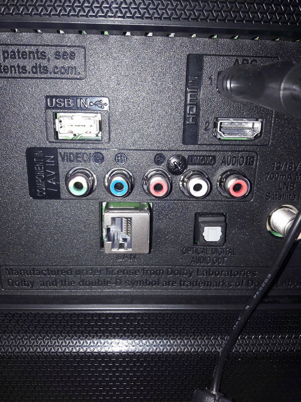

    Hello, I recently bought the LG 32LH57 TV and to my surprise there is no jack input. I need the input to connect my speakers, so far I have connected them to each equipment using an aux cable, these are 2 speakers and a subwoofer, nothing special but the speakers built into the LG are a tragedy. Can you tell me what cable / adapter / adapter to buy so that everything starts working? Attached is the back of my TV and all the inputs at its disposal.

    From optical output via adapter (TOSLINK OPTICAL AUDIO CONVERTER TO 2x CINCH RCA) Pos artur
    Added after 38 [seconds]:
    Or from the headphone output if there is one

    luqas93 wrote:
    recently LG 32LH57 TV
    Is the TV model correct?
    Please check this.
    Nice, nice ... Only there will be no volume control by changing the volume with the TV remote control.
    While these speakers have their own remote control, then the above solution is OK.

    The latter is just a transition from one type of connector to another type, it does not change the signal parameters, so it probably does not.

    Okay, so you need a converter, and some of you met with a converter that would have a 3.5mm jack input on the one hand, and an optical TOSLINK output on the other?

    luqas93 wrote:
    with a converter which on one side would have an input to an ordinary 3.5mm jack and on the other side an optical TOSLINK output ??
    There are converters with TosLink optical output, but inputs have CINCH sockets.
    But a colleague, if anything, needs a converter the other way around, i.e. the TosLink optical input and the stereo analog output.
    I hope that my friend has read my previous post - I will quote its fragment:
    Please remember that.
    And the mentioned optical adapter is used for something completely different and let your friend forget about it.

    Okay, so I know almost everything, tell me, please, will I finally be able to enjoy my speakers connected to the TV with such a set?
    1. TosLink cable from TV to Converter - http://allegro.pl/kabel-pkuje-optyczny-cyawod-tt-toslink-1-5m-i6737298865.html
    2. Converter - http://allegro.pl/konwerter-optyczny-toslink-coaxial-na-2x-cinch-rca-i6781804978.html
    3. Adapter cable from Cinch to regular Jack from the converter to the speakers - http://allegro.pl/kabel-mini-jack-d-2x-rca-chinch-1-5-m-dl-stereo-hq- i6781804544.html

    The elements listed in the above entry should guarantee the transfer of sound to the TV speakers.
    Remember to change the settings on the TV - set the optical output to PCM.

    luqas93 wrote:
    Converter
    Instead of such a noname - please buy FiiO D3 instead.
    And the other cables - the optical cable can stay that way, but the chinche-minijack ones should also be of better quality.
