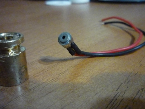

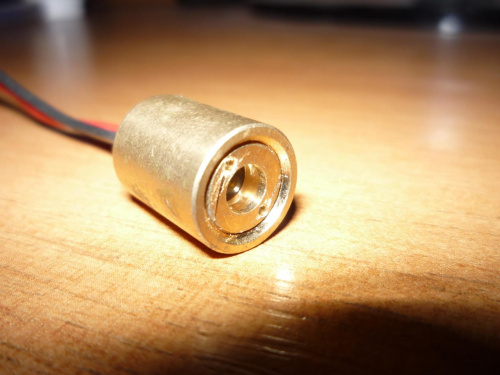

    Show what this laser looks like.
  • #3 16220456
    radek33
    Posts: 86
    Rate: 25
    Something like that is
    Motion Star Shower: Two-Color Red-Green Laser Projector (650nm) - Setup & Technical Discussion
    it can still be opened, but I have failed so far,
    maybe inside he writes what power is and what this diode -laser looks like

    To open it, unscrew the ring from the front. There is normally a key in the shape of it for mounting the wheel in the grinder. For this two holes at the front.
  • #5 16222042
    radek33
    Posts: 86
    Rate: 25
    I was able to open and properly cut this roller, and inside there was something so tiny, there are no signs of tension. In that case, how to replace these diodes?
    it can only be replaced by this tension
    http://allegro.pl/show_item.php?item=6681945874
    when I checked the voltage, how the green laser is lit it shows about 2V, when the laser is completely desoldered, it is up to 12V, maybe with red it will be the same
