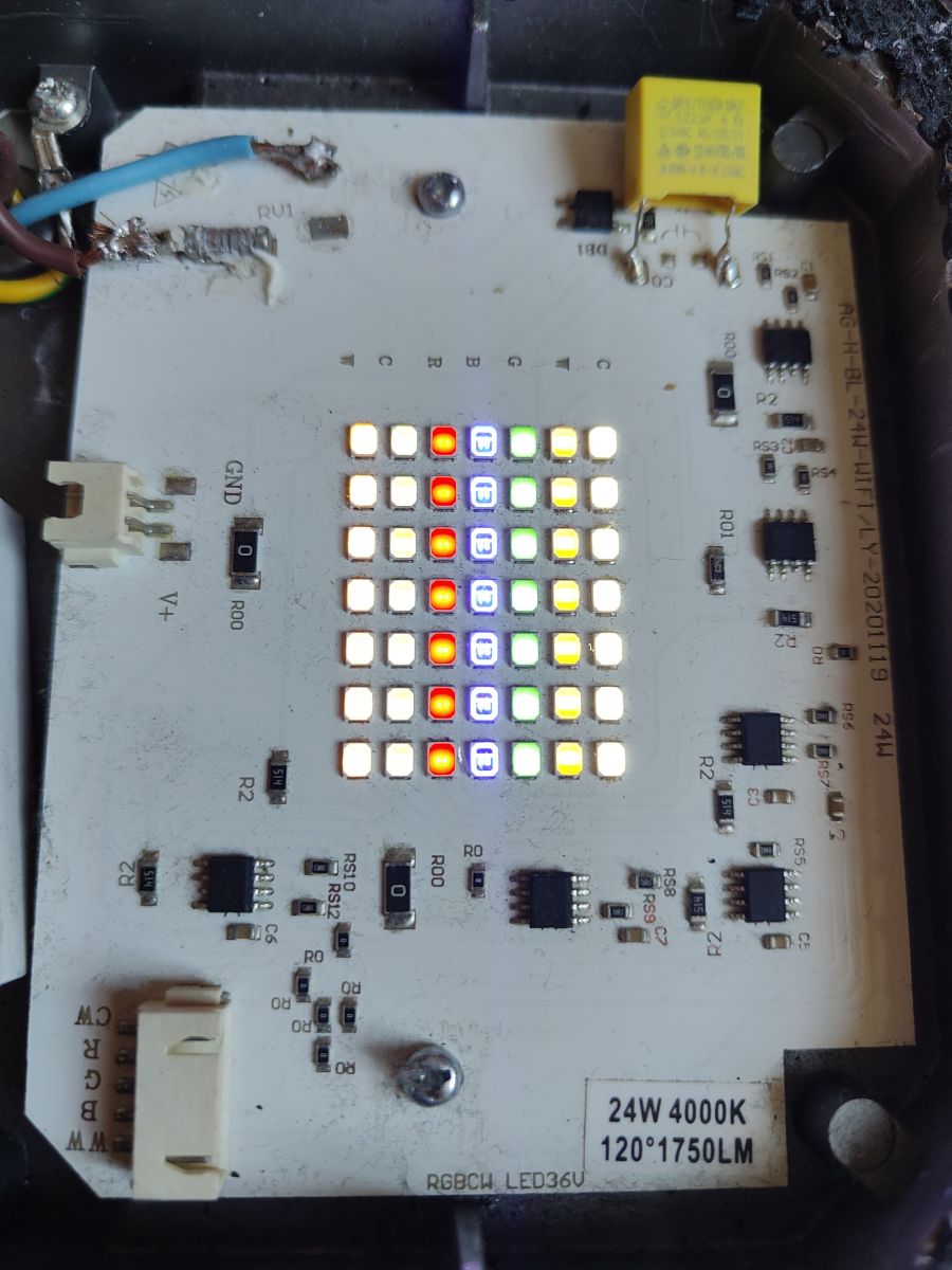

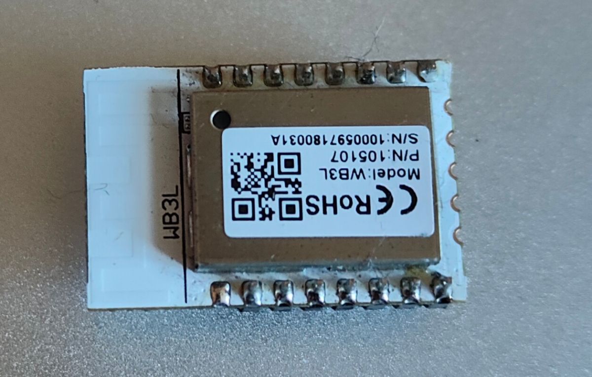

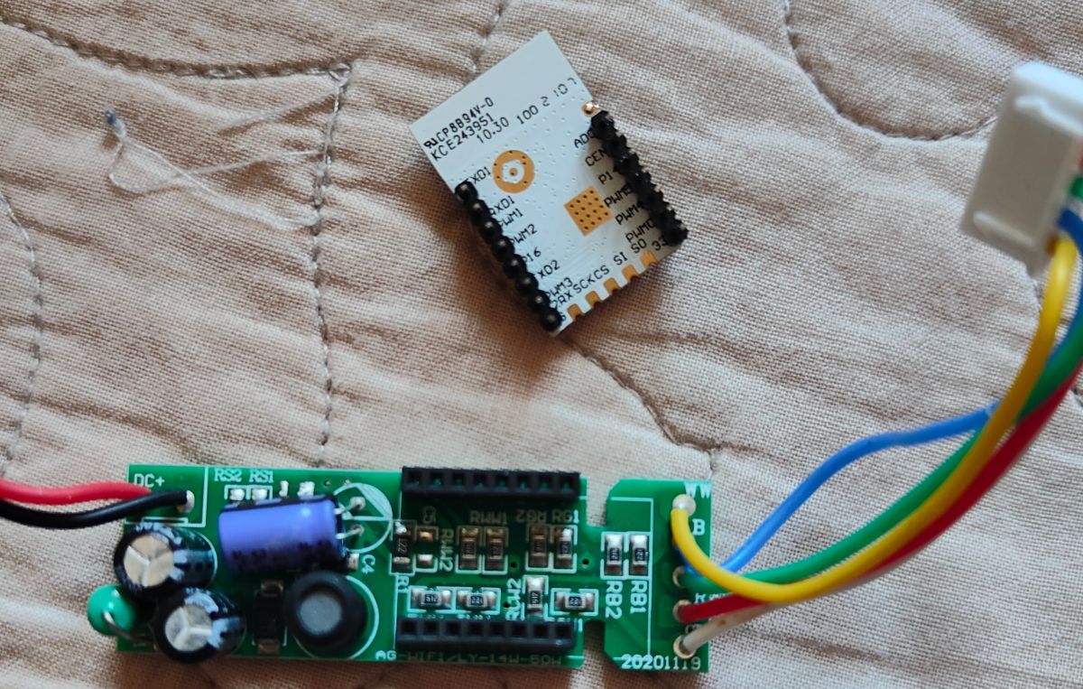

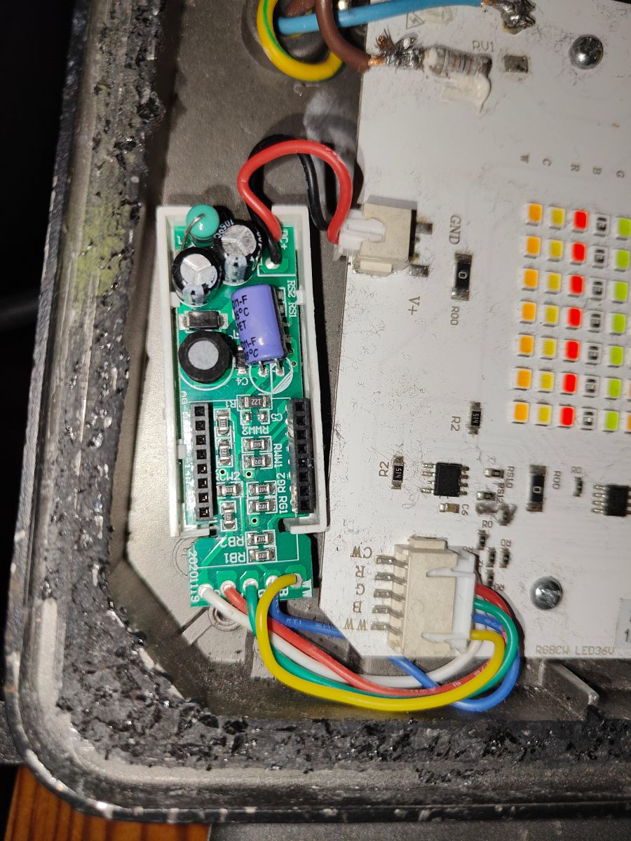

    Hello, I am posting some photos of the inside of the 24W spectrum led projector, I am looking for the right openbk firmware to flash it
    how to make the firmware?
    I have 3, I opened this one because even when turned off the LEDs remain slightly lit, and when it is turned on it is impossible to get red light
    broken for broken if it can help
    thanks if someone could explain the procedure to me

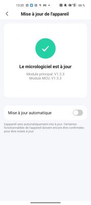

    Firmware update screen on a mobile device. Box of Spectrum Smart Noctis 24W LED floodlight. Packaging of the Spectrum Smart Noctis 24W LED projector with heat dissipation and RGB features information. View of the interior of the Spectrum LED 24W projector, with electronic module and wiring. Interior of LED projector with PCB and wires. Packaging of Spectrum SMART Noctis 2260lm 24W LED floodlight with technical information.
    AI: Could you please specify the exact model of your 24W Spectrum LED projector?
    spectrum smart noctis LED floodlight 2260lm 24W

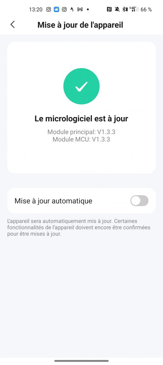

    AI: Have you attempted to flash any firmware on the projector before, and if so, what version is currently installed?
    no modified firmware only with spectrum android app in ap mode 5x on/off twice firmware 1.3.3

    thanks, I'll look but I don't speak Russian... under the metal cover there is a bk731t microcontroller is that it? can we reprogram it like on an arduino when it is disassembled? the problem is that to disassemble the led projector everything is glued (I had to break the glass to use leverage and disassemble it.... and for the other two can we flash it when it is in Access point mode?
    yes, the BK7231T is one of the chips supported by OpenBeken

  • BK7231T pin mapping for five LED channels
    #5 21388198
    patricejouve
    Hello, flash ok, acces a l'interface ok
    OpenBeken Configuration Generator - Parse Tuya JSON data from Cloudcutter
    Device seems to be using WB3L module, which is BK7231T chip.
    - LED Red (Channel 1) on P8
    - LED Green (Channel 2) on P24
    - LED Blue (Channel 3) on P26
    - LED Cool (Channel 4) on P7
    - LED Warm (Channel 5) on P6
    Et après je suis un peu perdu...je ne trouve pas l'éclairage de 10 à 100 %
