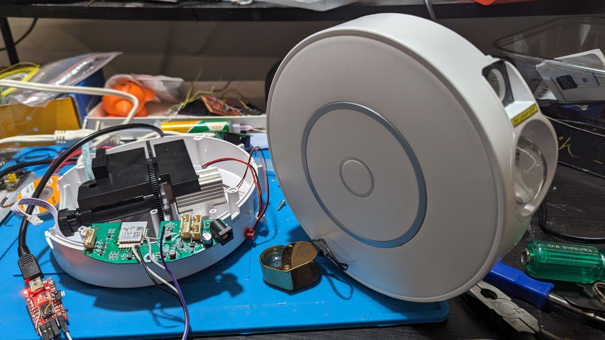

    Electronic circuit with connected USB programmer. Open casing of an electronic device with visible components, cables, and motherboard.

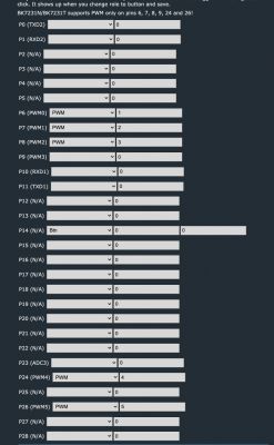

    I have flashed this guy and able to control the RGB LEDs. However need to help with the config for Laser and Motor properly.
    The other thread in this forum with BK7231T was helpful, but I need to understand what pin 23 is doing and what value to set.
    The tool generated this
    - LED Blue (Channel 3) on P8
    - LED Red (Channel 1) on P6
    - LED Green (Channel 2) on P7
    Device seems to be using CBU module, which is using BK7231N.
    Attached the backup bin file as well.
    I have configured the LEDs, Laster and motor as PWM and i'm able to set individual brightness and colors. I followed the general flags from the other star light thread. However not seeing separate toggle buttons for Laser and motor! idk what to add in autoexec.bat script!
    Screenshot of BK7231N pin configuration with various settings for PWM and buttons. User interface of Star_Projector with control sliders for LED and laser. Configuration options list for a star projector with various setting flags.
    Kindly help me with configuring the Laser and the motor correctly and pin23.

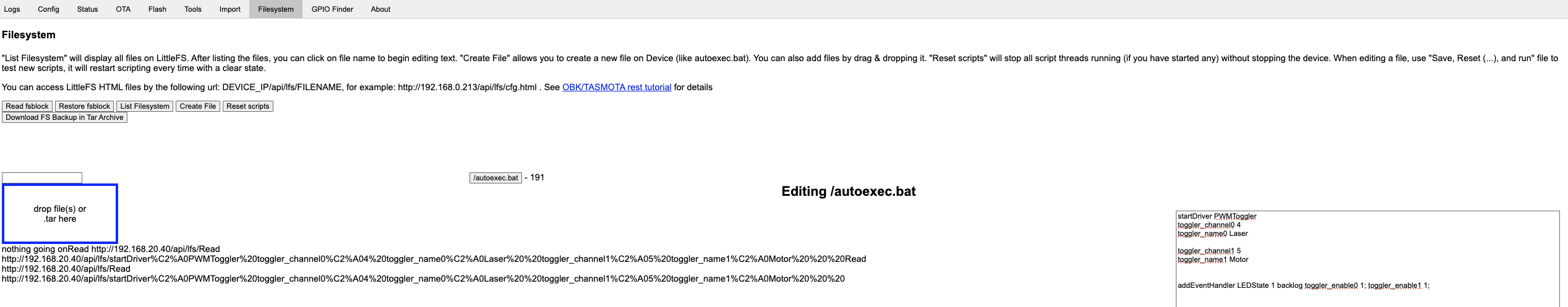

    It's normal. You haven't added script yet. Go to the Web App, LittleFS tab, press Create new file, and create autoexec.bat with the script from the thread you mentioned:

    I added this, saved and rebooted, but still do not see the laser and motor toggle buttons!
    startDriver PWMToggler
    toggler_channel0 4
    toggler_name0 Laser
    toggler_channel1 5
    toggler_name1 Motor
    addEventHandler LEDState 1 backlog toggler_enable0 1; toggler_enable1 1;

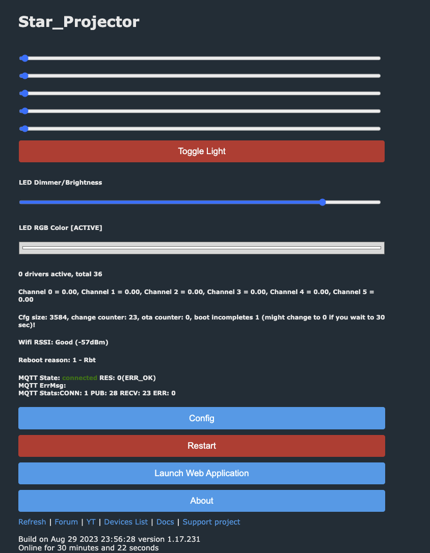

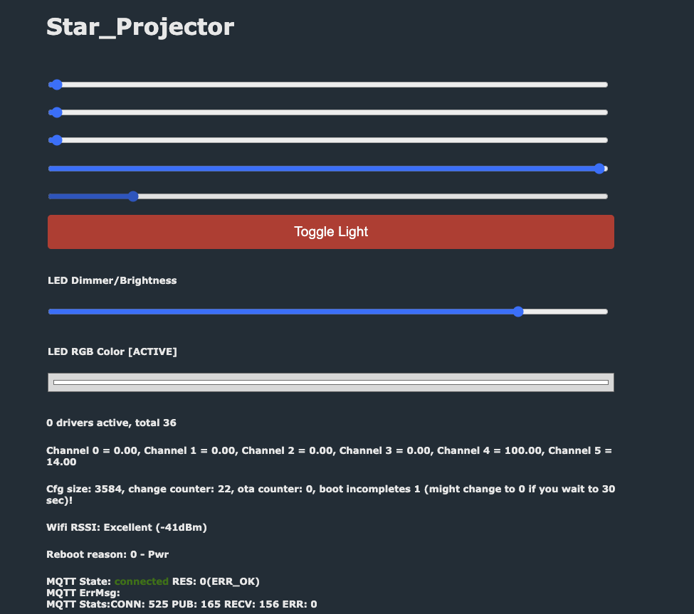

    If you still don't see the buttons from PWM toggler, please post a screenshot of your main WWW OBK page so I can check whether the PWMToggler driver is running.

    Here is the screenshot
    Screenshot of the LittleFS file management interface with a script editor. Screenshot of the Star_Projector user interface with sliders for light adjustment.
    Added after 8 [minutes]:
    Looks like 0 drivers active
  • #6 20717939
    Posts: 14767
    Rate: 12906
    That's strange, are you sure that you've restarted the device?

  • #8 20717991
    Posts: 14767
    Rate: 12906
    This is very strange. Are you sure that your browser didn't add any special chars to the file text, thus making whitespace non-standard?
    Please do a little test - go to Config, then Execute custom command (NOT short startup command), then execute:
    and show me again the www panel... so we can check is the PWMToggler running

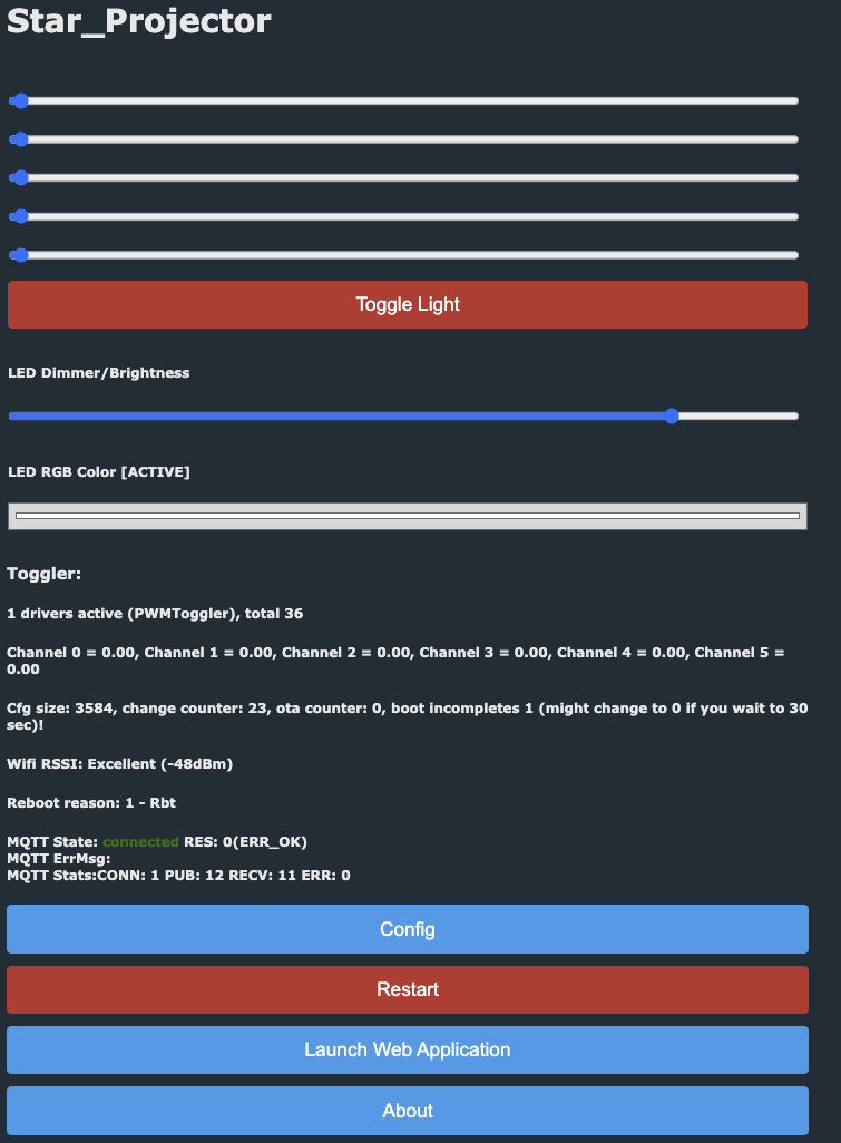

  • Toggle enabled but web button still missing
    #9 20718018
    soubhikkhan
    Posts: 13

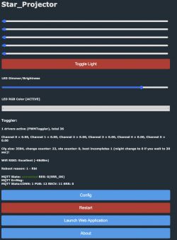

    OK, so after running it from the "Execute custom Command", it showed "OK". Then I went back to the file editor and checked every line, saved, and rebooted. Now on the WWW page, it shows 1 driver active but the toggle button is not yet visible. I tried with and without this line too.
    User interface of the Star_Projector control panel with buttons and sliders for adjusting LED settings.
  • Autoexec.bat not executing due to typo or whitespace
    #10 20718097
    Posts: 14767
    Rate: 12906
    If it's working from command line, but not from autoexec, it may mean one of the following:
    - you haven't restarted your device so autoexec.bat wasn't run
    - autoexec.bat name has a typo or a whitespace
    - your browser has corrupted the autoexec.bat text whitespaces (when copy-pasting from forum) and you need to retype autoexec.bat manually, or at least manually fix whitespace
    Your issue is that, for some reason, autoexec.bat does not execute properly and we need to fix that.

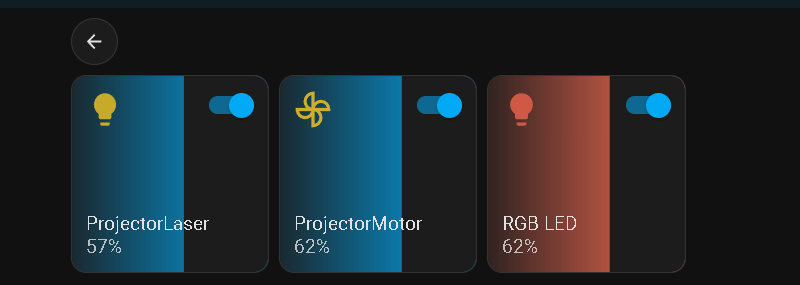

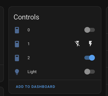

    Device control panel in Home Assistant with buttons for toggling various functions.
    Based on the instructions on the other thread, I created this and pasted in the discovery tab and clicked the start button, but the laster and motor doesn't show up on HA. Also when I go to out of the discovery tab and come back, it goes back to the default setting!

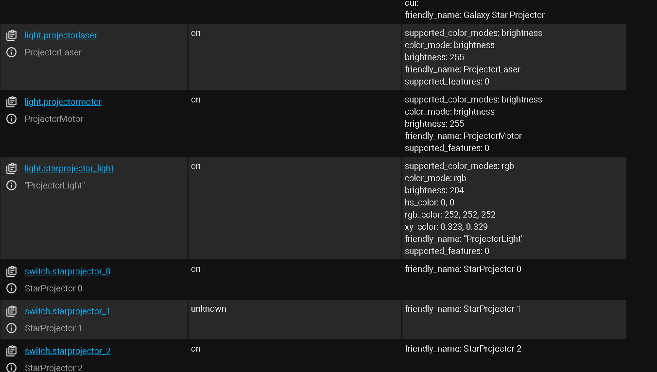

    Thanks for clarifying it! So I did this but still, the buttons were not showing in the auto-discovered device! However, when I checked from the developer tab, I could see the entities. I can call them through service. It works. Hence I added manual buttons on my dashboard to control them and deleted the discovered device. What I understood is, the discovered device is coming from the OBK portal since the number of entities and the names matches with the HA discovered device. I wish if there was a way to edit and save the text field on OBK side.
    Screenshot of a user interface showing a list of light and switch devices with status and parameters. Device control panel with three widgets.
