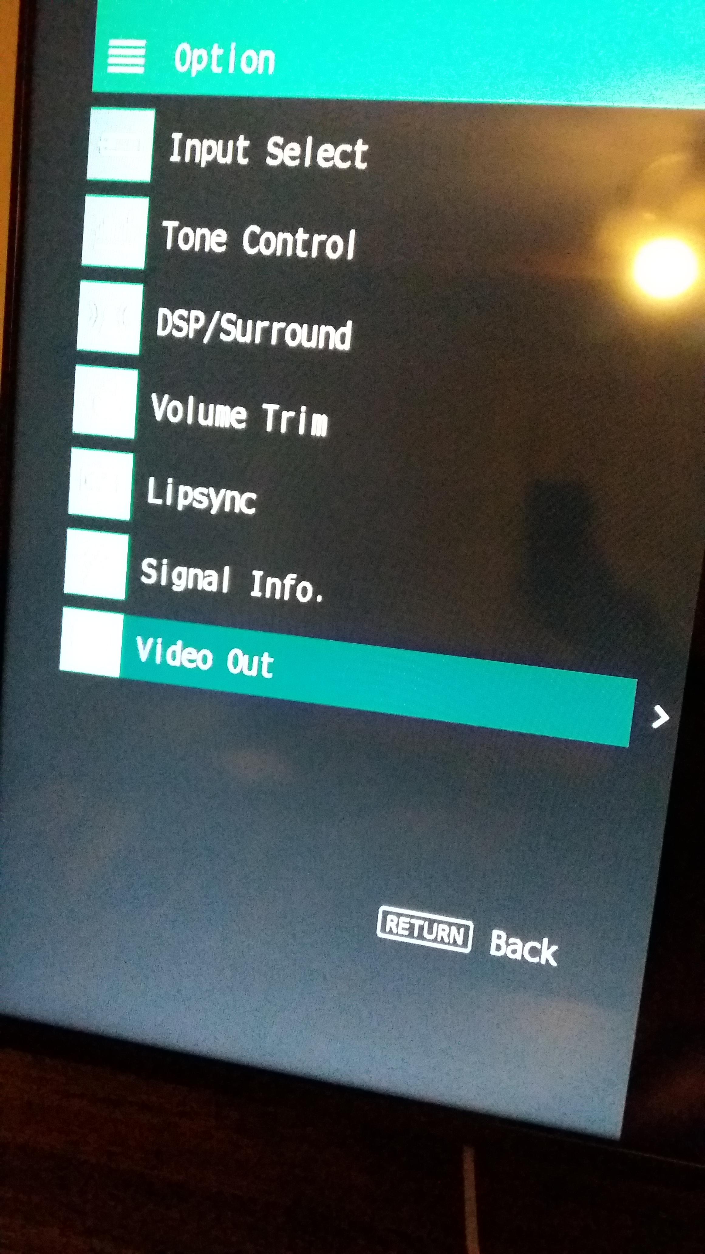

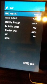

    TV sets usually have only a different input here. Do you connect HDMI out from the receiver to the ARC input (definitely no photos) and this input is selected in the TV menu? And there is no picture?

    After all, HDMI out illuminated in red means that the output is active .... For HDMI control to work, you must enable HDMI control in the settings, you can find additional instructions on page 124 of the manual for download from here: link
  • BD/DVD input displays video despite TV button failure
    #9 16224740
The discussion revolves around a connectivity issue between a Sony KDL 55W829b TV, a Yamaha RX-V481 receiver, and a Samsung BD-J7500 Blu-ray player. The user reports that while the HDMI ARC connection is established from the TV to the receiver, they are unable to control the TV's picture and sound using the Yamaha remote. The receiver's HDMI OUT indicator is red, suggesting an active output, but the user must manually select the TV source on the TV remote to get a picture and sound. Suggestions include ensuring HDMI control is enabled in the receiver's settings and verifying the correct HDMI input is selected on the TV. The user also seeks clarification on the Video Out settings of the receiver.
